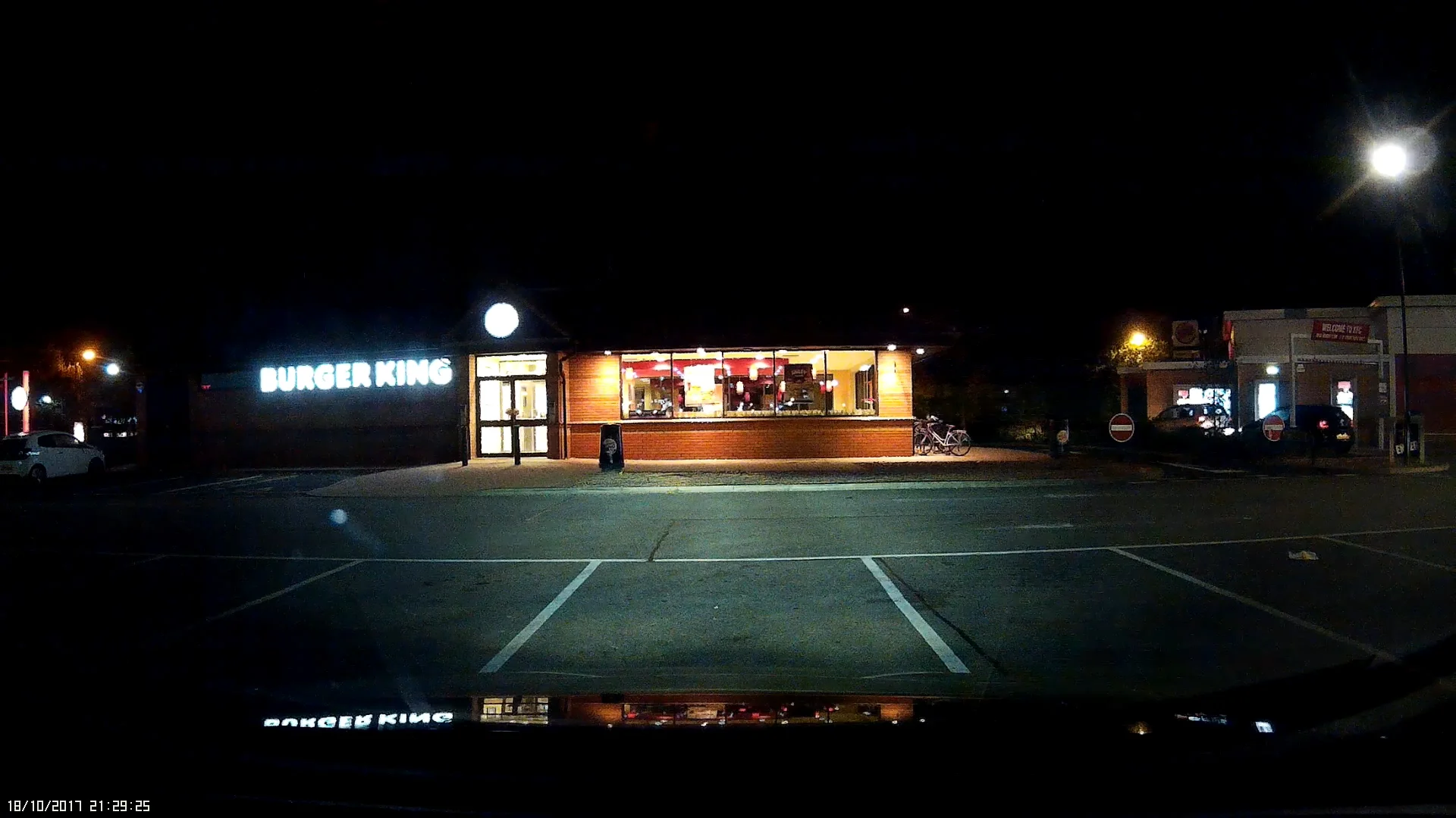

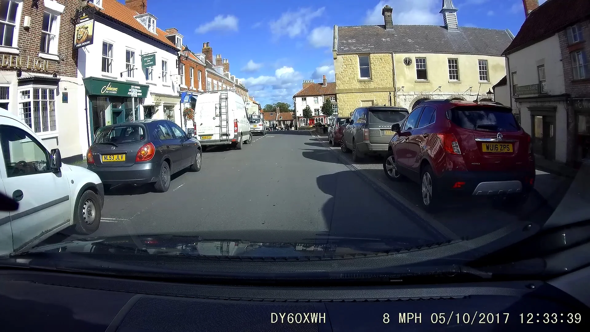

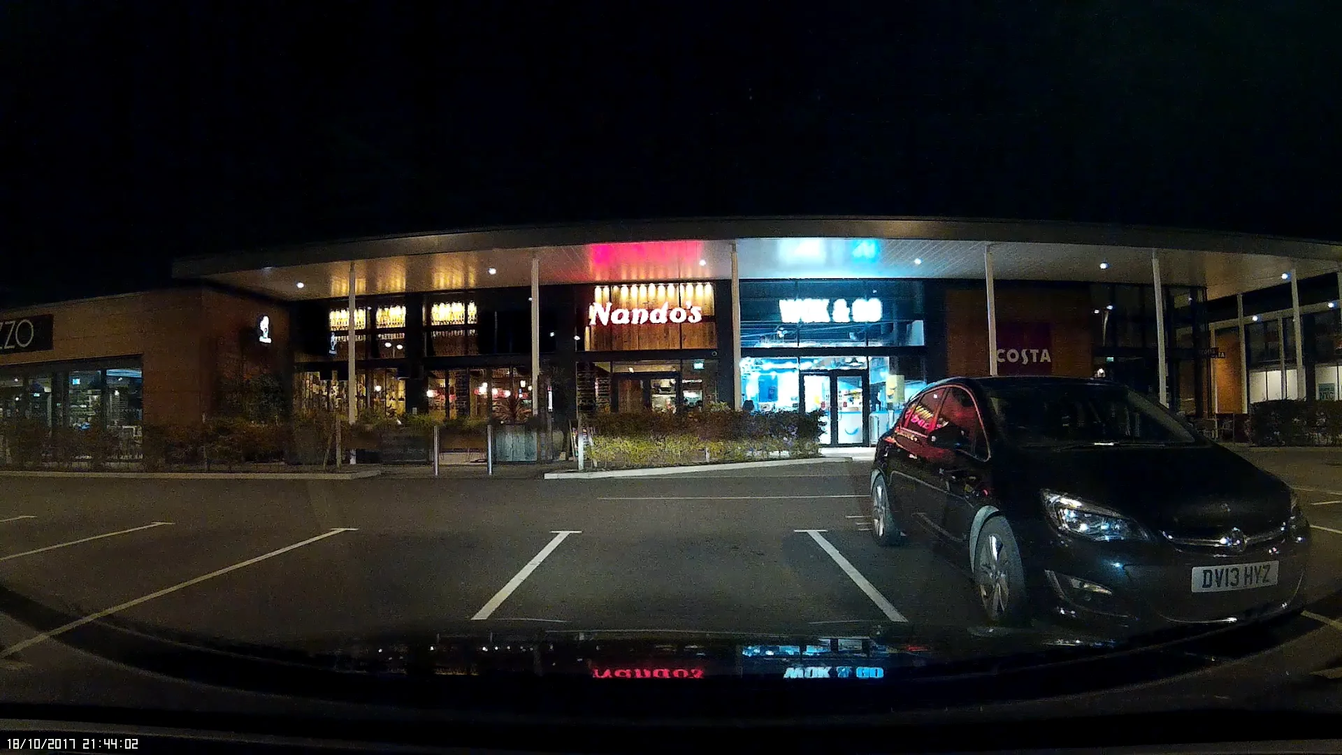

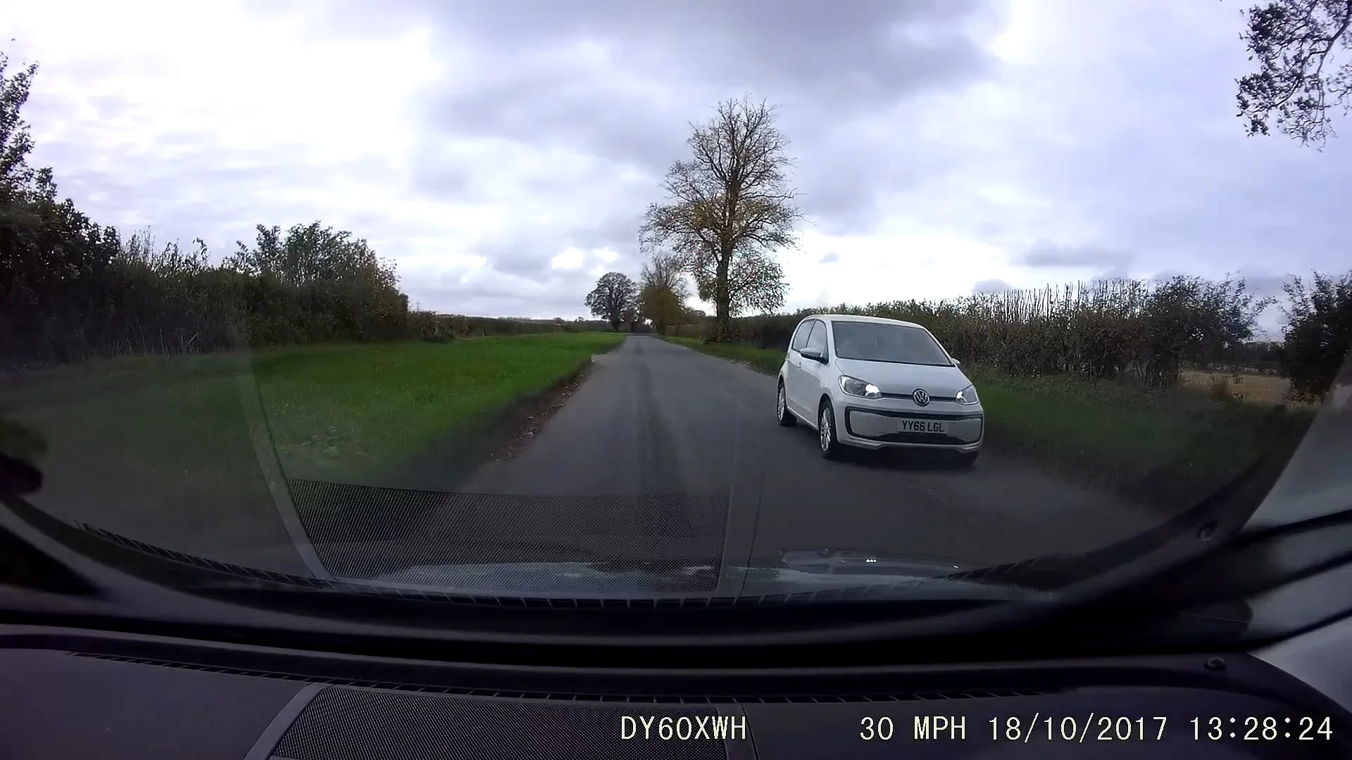

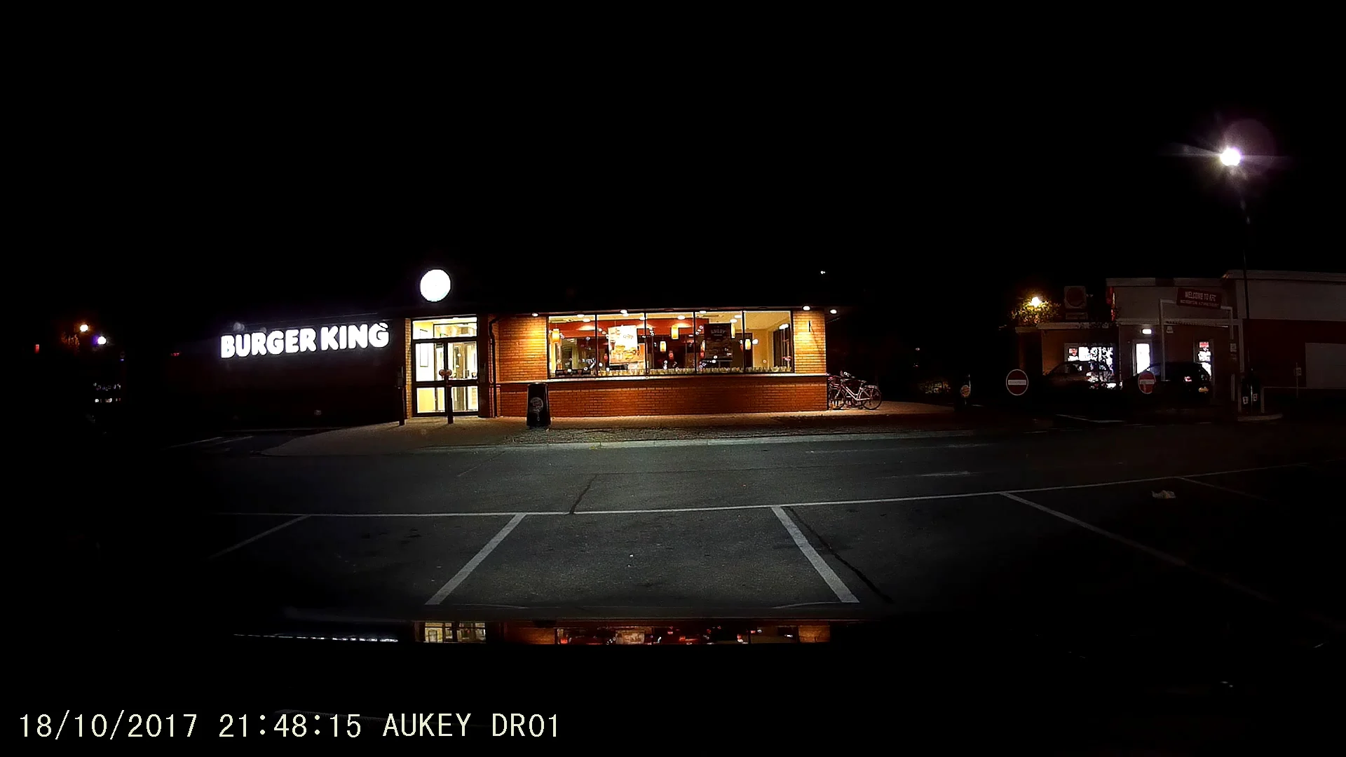

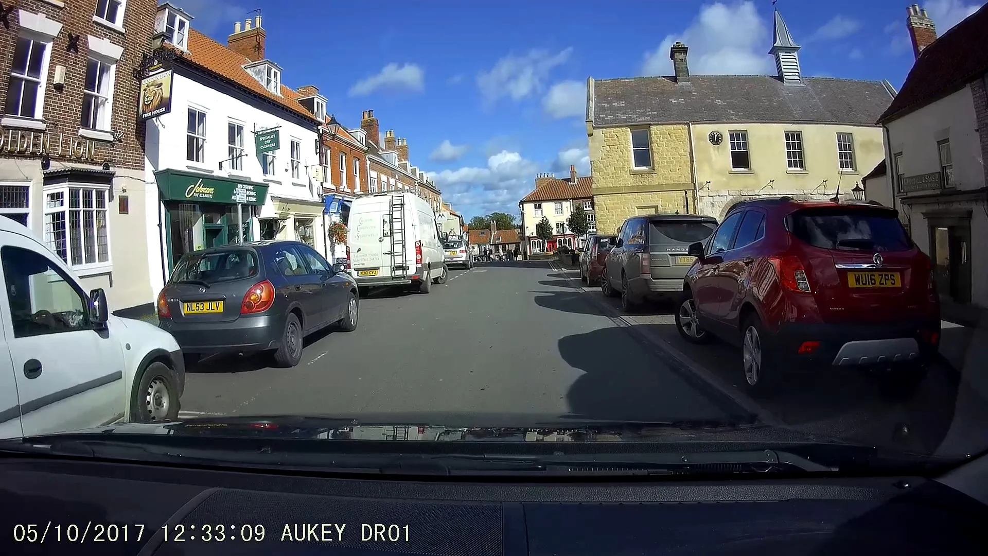

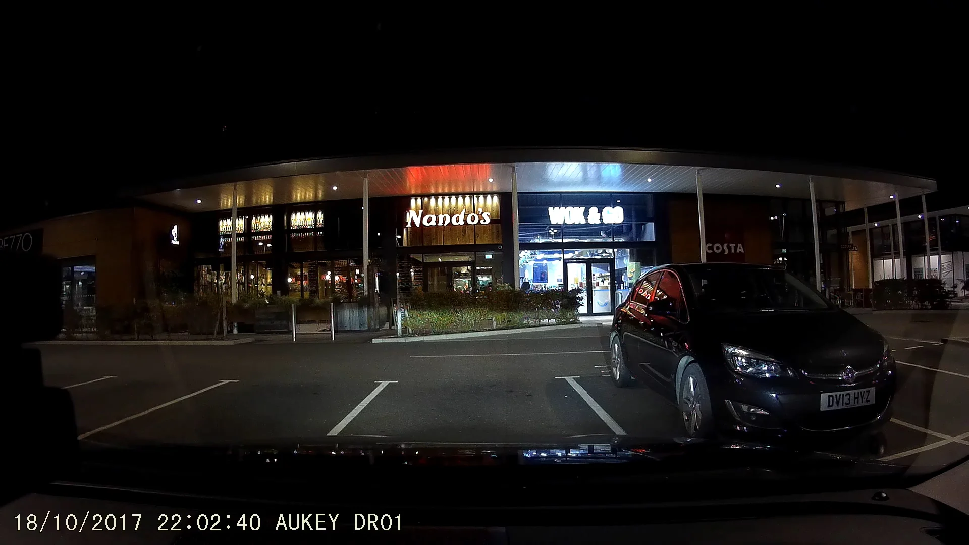

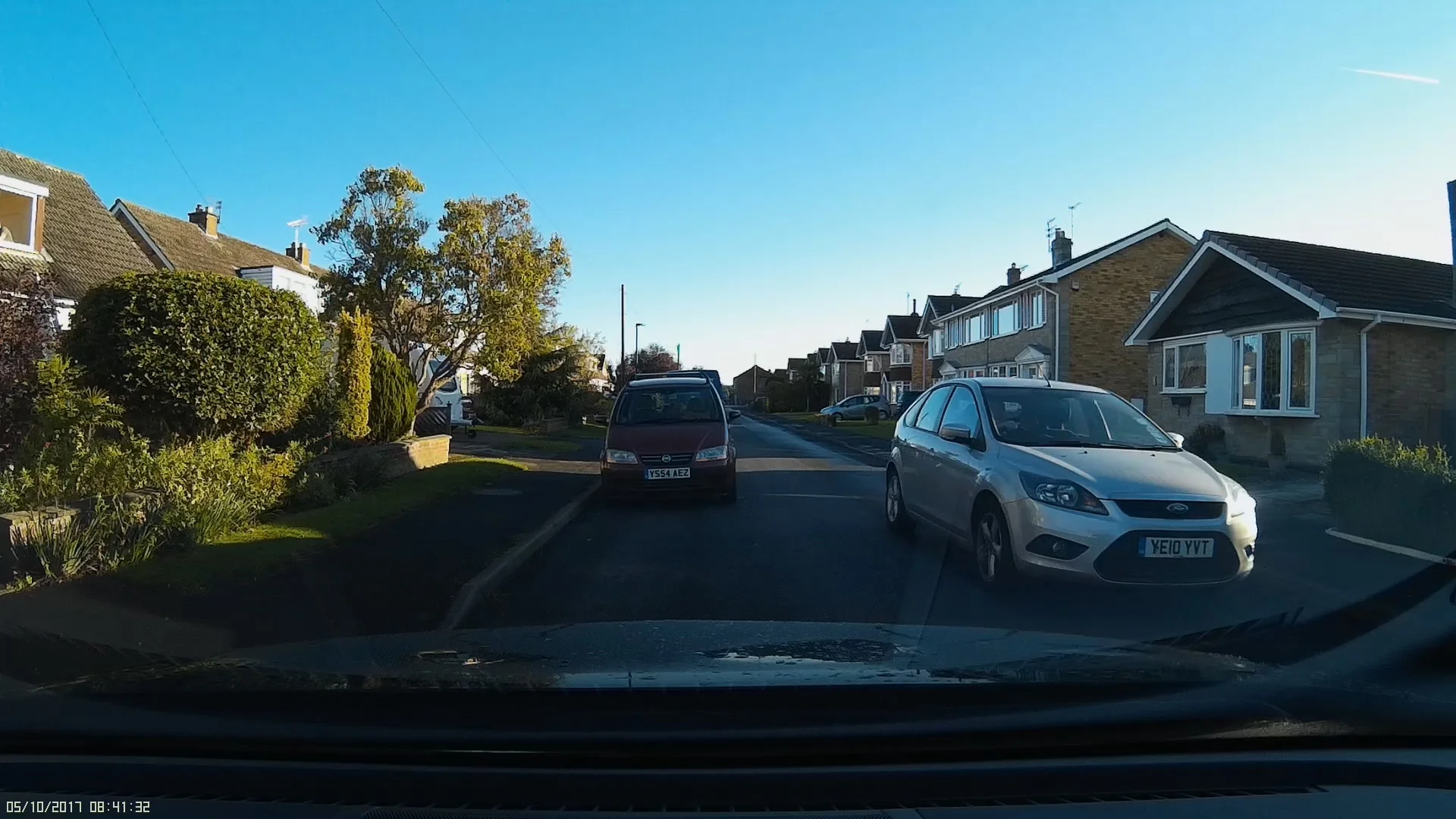

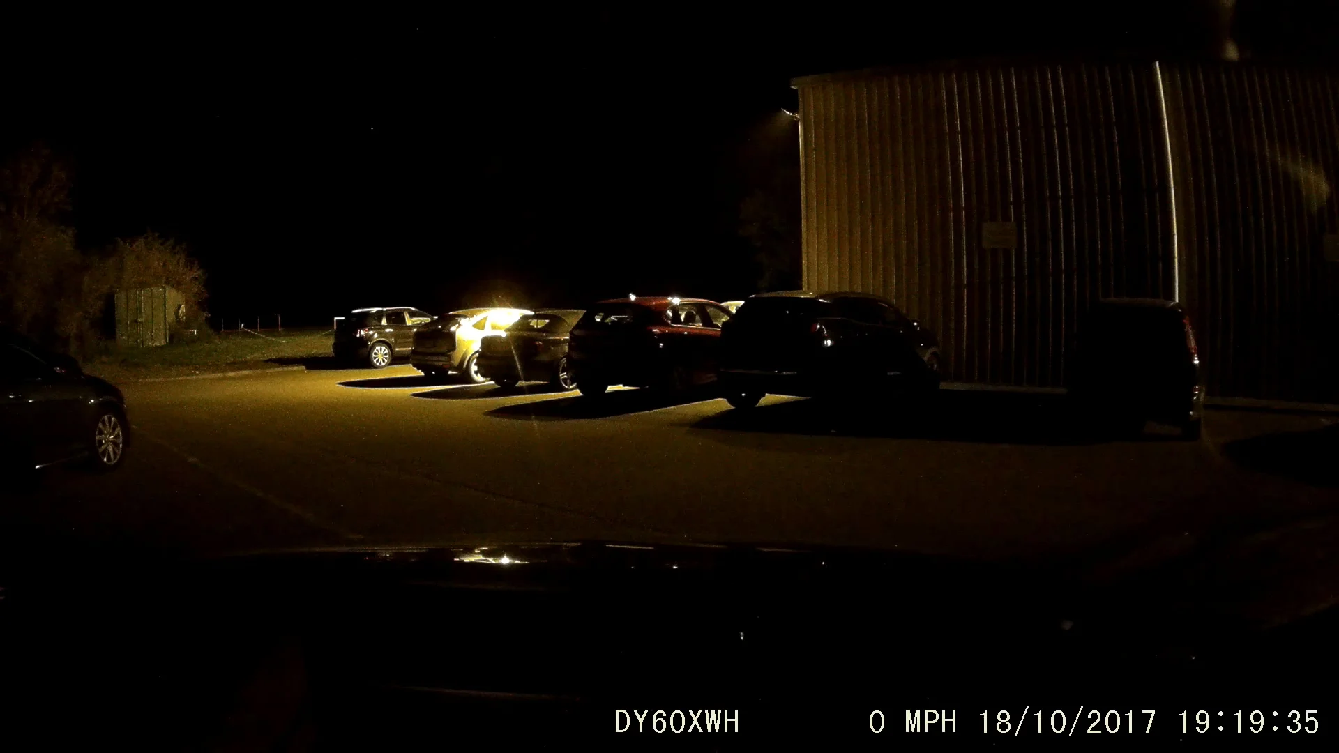

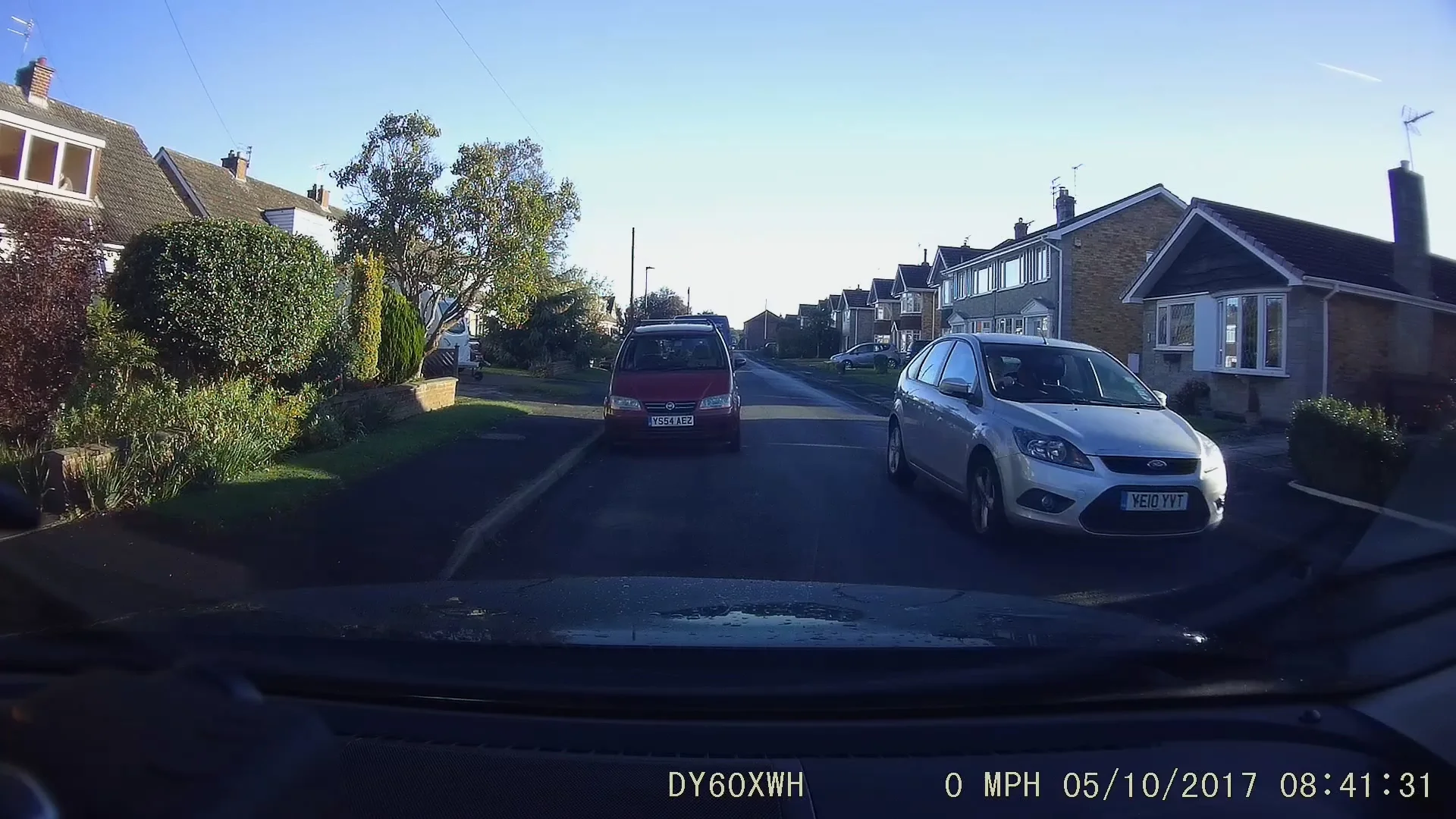

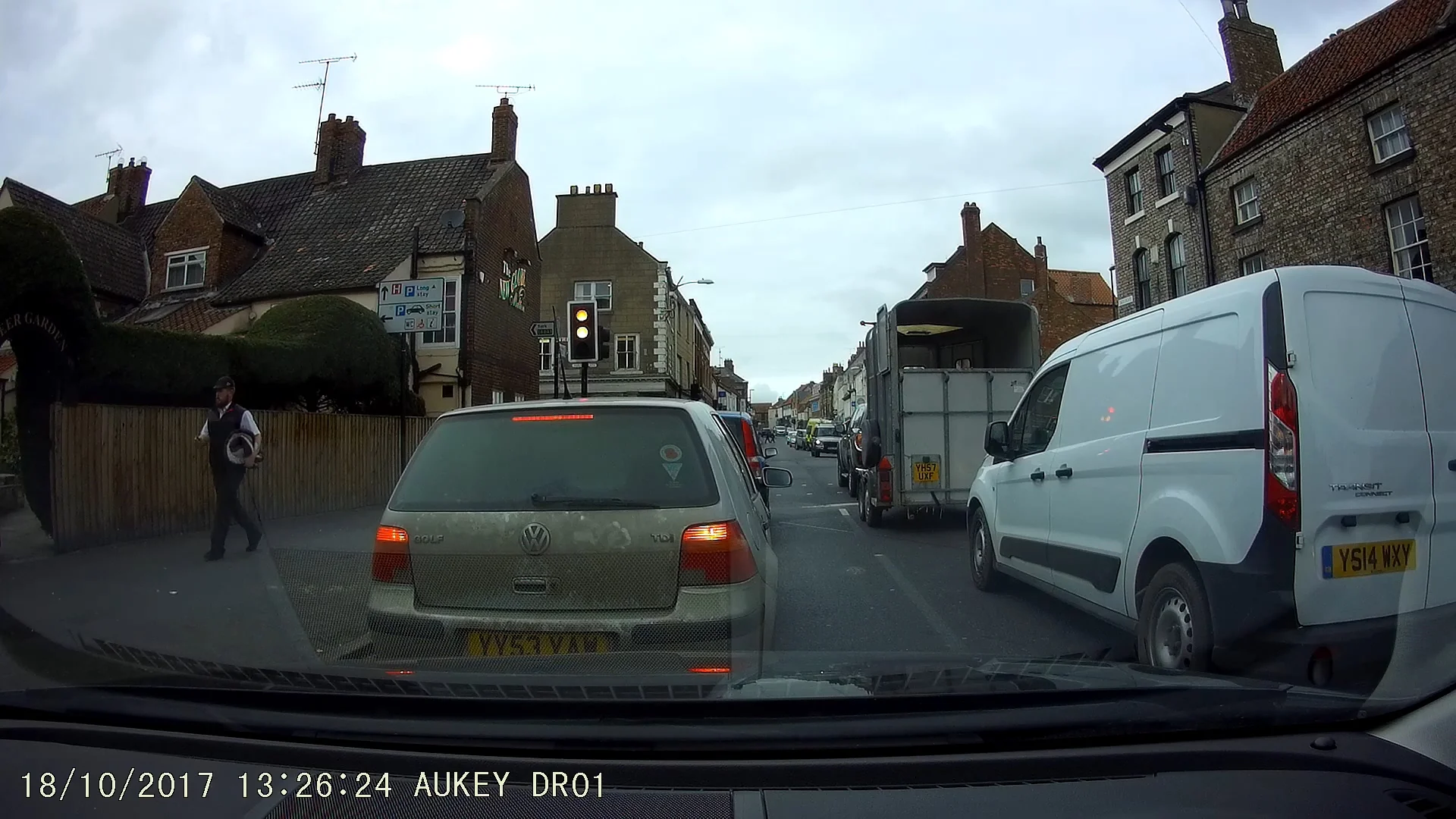

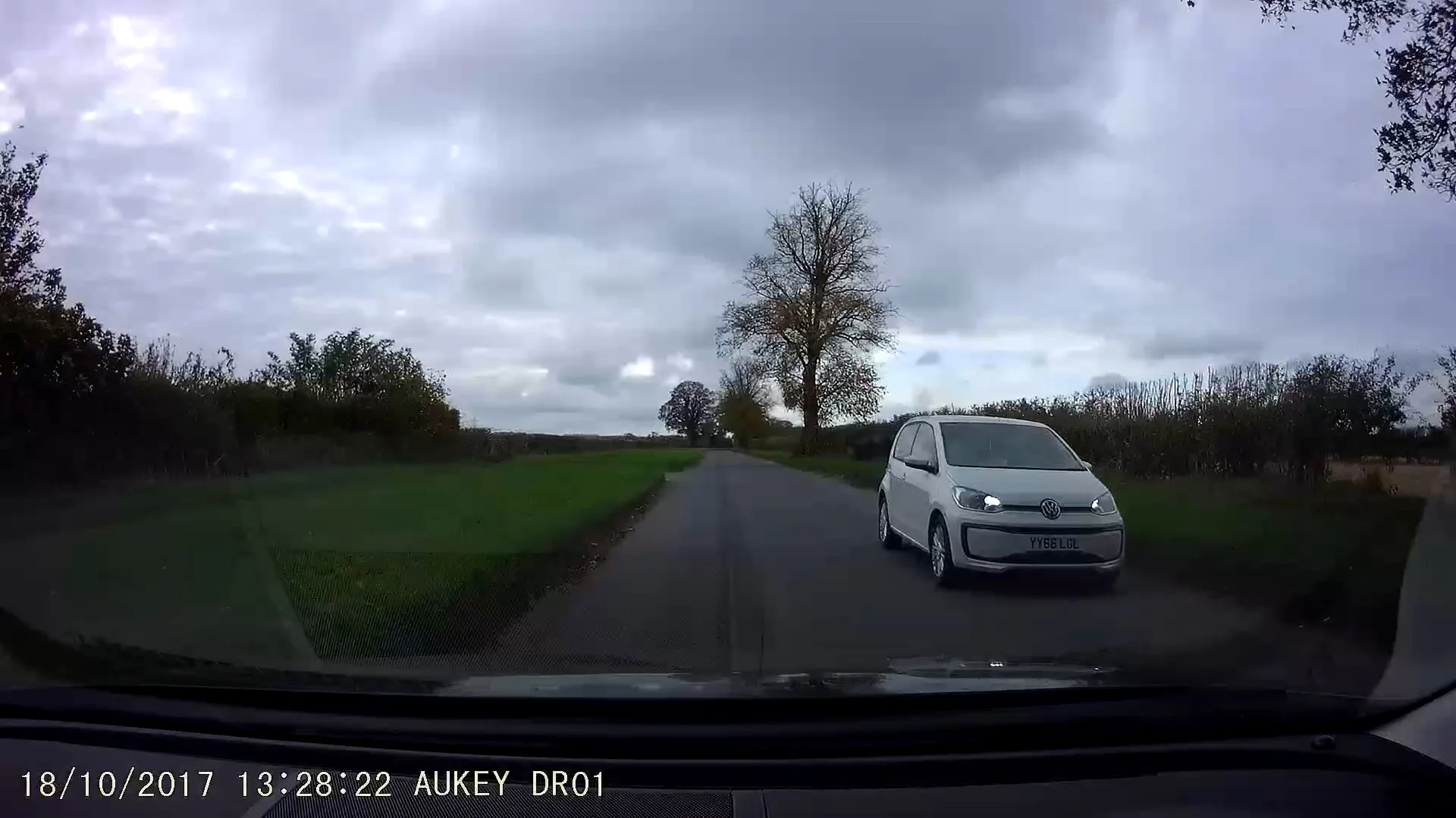

I have written my own review of the Aukey DR01 HERE. This is a comparison between two other dashcams I had setup in my car, a SG9665GCv2 and a Mobius 1.
The primary purpose of my comparison was to evaluate the DR01 before installing it in my partner's car, to replace the Mobius 1. However by the end of the comparison I came to a different conclusion. The DR01 is capable of very good image quality, but the conspicuous mounting style plus the vibration through the poor quality mount were too much of a compromise for me.
Therefore I'm returning the DR01, and I have installed the GC in my partner's car. That leaves me looking for a replacement primary camera, although the Mobius 1 is still a solid performer and will remain in my car no matter what else I purchase.
The wedge-shaped Aukey DR02 appears to have identical imaging hardware, so should produce the same quality recordings in a less conspicuous design that is less subject to vibrations. However at a current UK price of £70, twice what I paid for the DR01, the DR02 is up against some fairly stiff competition.
All cameras set to 1080p 30fps with WDR on.

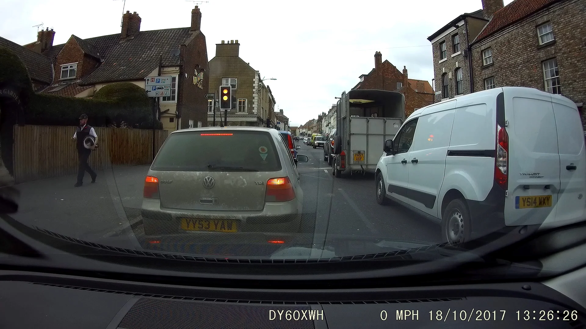

DR01 vs GC - daytime high contrast
DR01 vs GC - daytime overcast
DR01 vs GC - blocking visible on DR01
DR01 vs GC and M1 - daytime high contrast
DR01 vs GC and M1

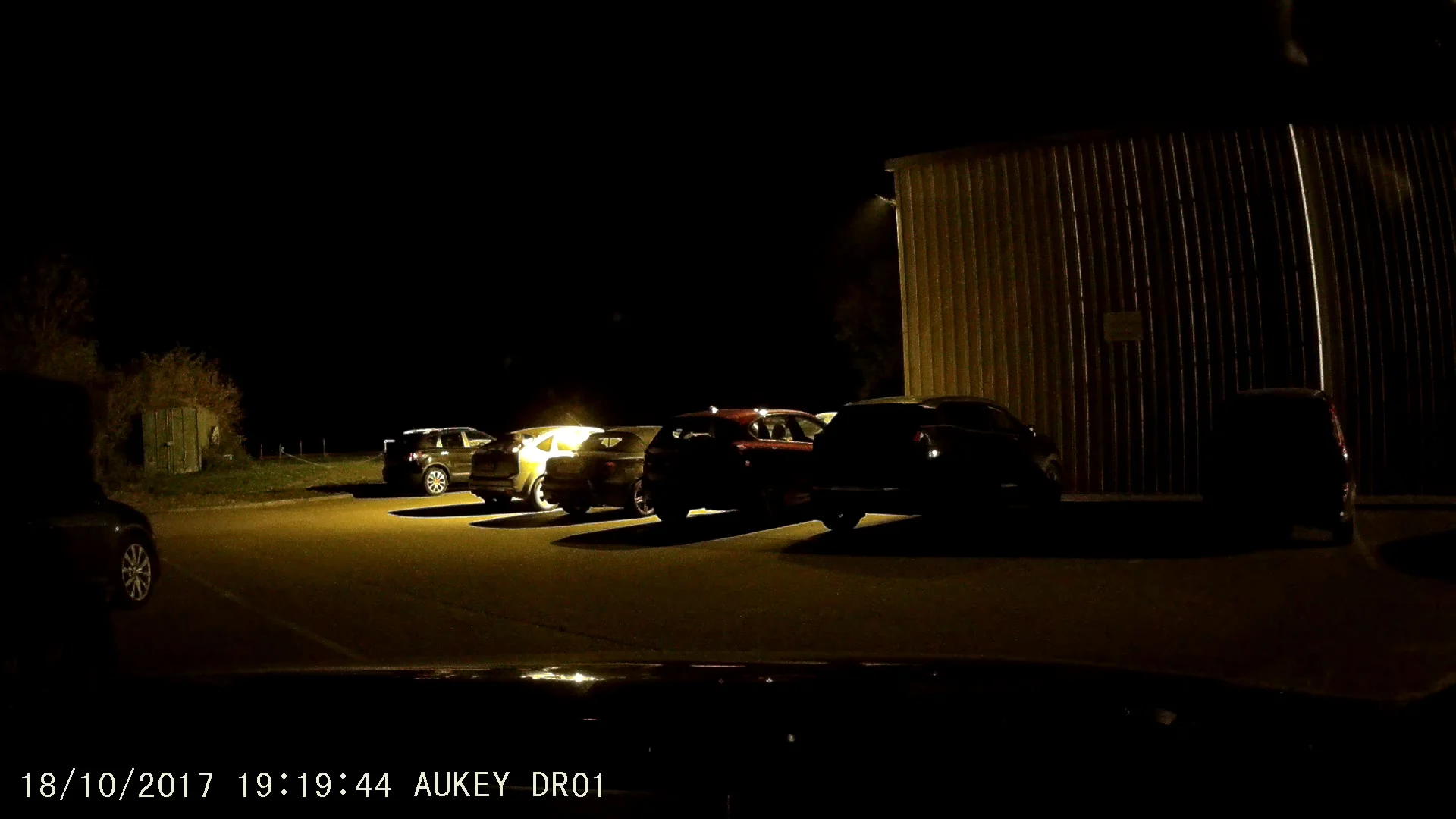

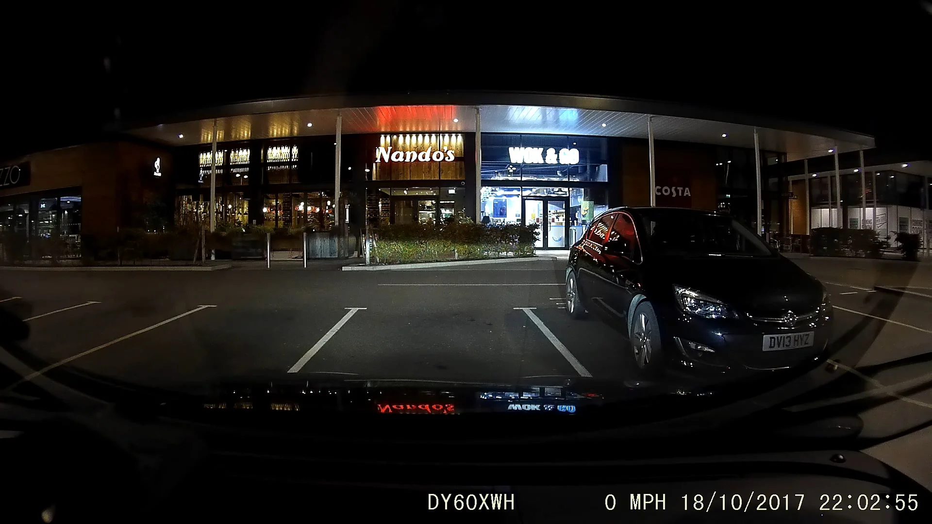

Night scene 1
Night scene 2
Night scene 3 (no headlights)
