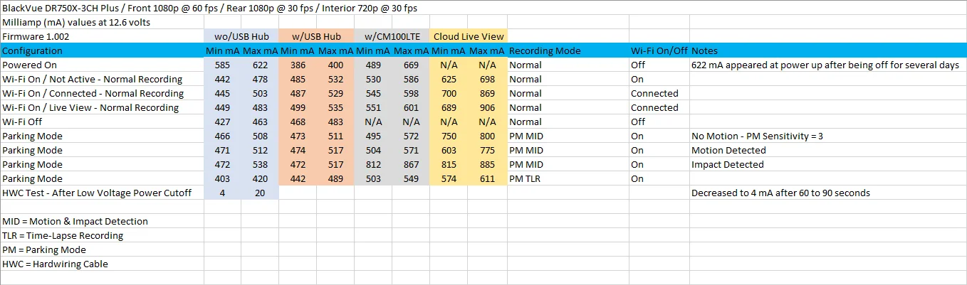

I ran a long series of tests to gather power consumption values for this 3-channel dashcam with and without the USB hub and the BlackVue CM100LTE connectivity device.
Here are my initial power consumption values from those tests:
As one would expect with a 3-channel dashcam, it consumes more than a 1-channel/2-channel dashcam would consume and with the cloud connectivity via the CM100LTE connectivity module it requires more power than most dashcams I've tested.

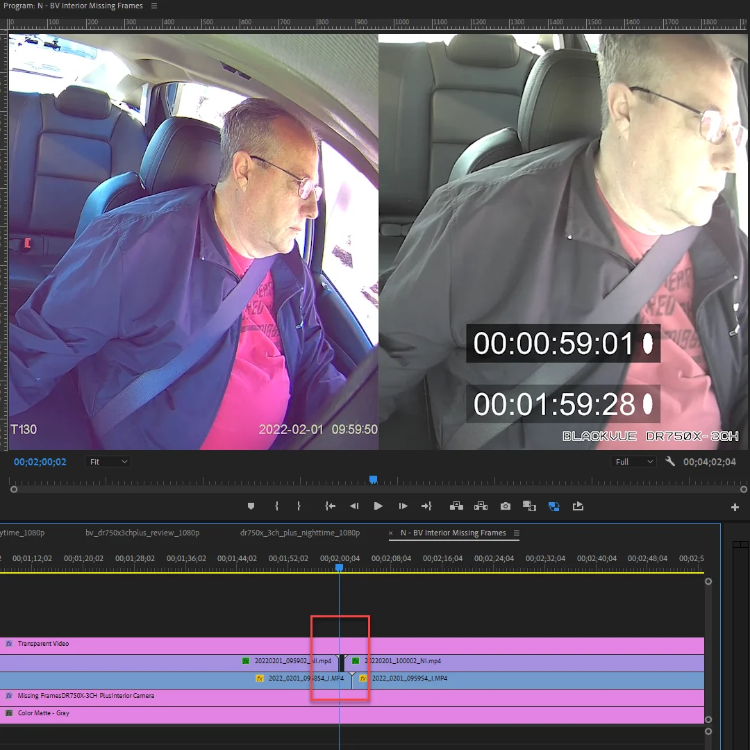

I've been checking whether the DR750X-3CH Plus dashcam has the same bug I reported to Pittasoft when I reviewed the DR900X-2CH where it would drop nearly one second of video every minute at the file transition for the rear camera. I've confirmed that bug is present in the DR750X-2CH Plus and DR750X-3CH Plus. I also found that the dropped video issue is present in the interior video files for the DR750X-3CH Plus. It drops 22 to 30 frames at the end of each file when it is transitioning to the next video file (every minute).
That doesn't sound like a lot, but that equals 1-minute of dropped video every one hour of use.

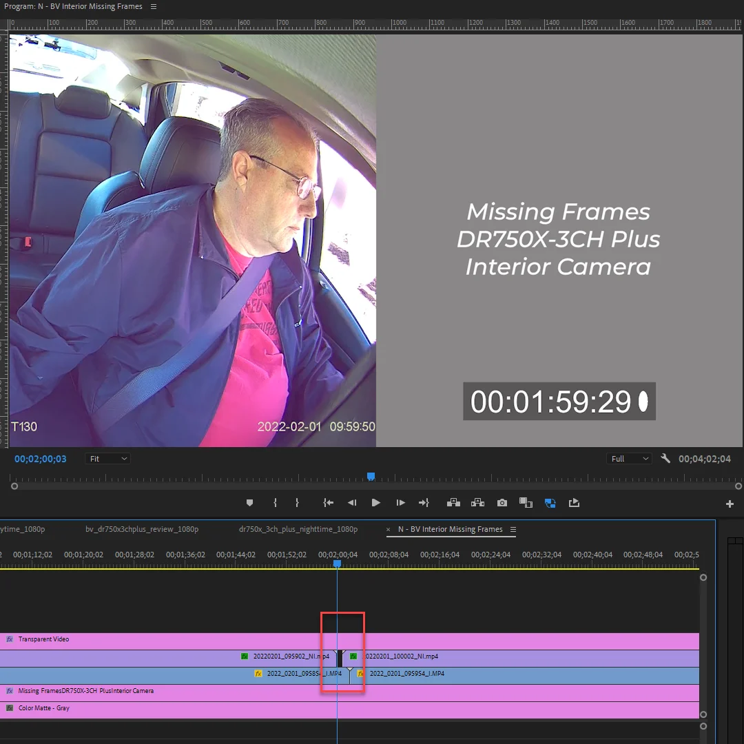

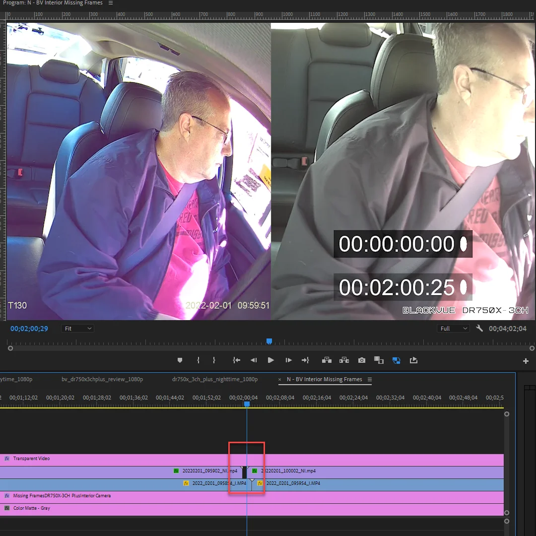

Here are some screenshots from my Adobe Premiere Pro editing session where I verified the missing frames. I display a timecode counter. The units of measure are Hours:Minutes:Seconds:Frames. The frames are based on the 30 frames per second and range from 0 to 29.
For the interior video example, the upper timecode counter is for that specific interior video file from the DR750X-3CH Plus, the lower timecode counter is for the overall video timeline. The video on the left is from the VIOFO T130 interior camera and the video on the right is from the DR750X-3CH Plus interior camera.
The DR750X-3CH Plus interior video camera's video clip is only 59 seconds and 1 frame in length (59:01 - left picture). The middle picture is the first video frame of the gap and the right picture is the first frame of the next DR750X-3CH Plus interior video clip. I'm using the VIOFO T130 video as a reference to see what occurred during the gap and to use it to align the DR750X-3CH Plus interior video clips with the correct timeline progression.
You can see that my arm moved from the left side of the video to the right side within the nearly 1-second gap. The video timeline timecode moved 1:59:29 to 2:00:25 during the missing video from the DR750X-3CH Plus. That's 26 frames that were missing in the interior video (26 / 30 = 0.86667 seconds).
dr750x3chplus_int_missing_frames_01.pngdr750x3chplus_int_missing_frames_02.pngdr750x3chplus_int_missing_frames_03.png

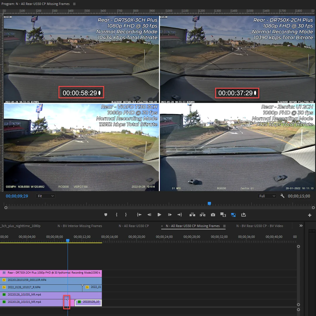

Here's an example of the rear video dropping frames at a file transition that I put into my DR750X-3CH Plus daytime video samples video on my YouTube channel.
The upper left square is the video from the DR750X-3CH Plus rear camera and the upper right section is the video from the DR750X-2CH Plus rear camera. Their file transition points where offset from each other allowing me to use the DR750X-2CH Plus rear video as a guide/benchmark for the DR750X-3CH Plus rear video missing frames check.
  • DR750X-3CH Plus Timecode / DR750X-2CH Plus Timecode
    • 58:29 / 37:29 - Last frame of the DR750X-3CH Plus rear video file
    • None / 38:00 - Gap starts
    • 00:00 / 39:00 - First frame of the next DR750X-3CH Plus rear video file
All video clips in the example were synchronized to the video frame. When you watch the video, you can see the pickup truck behind my car in the distance will jump from being directly over the furthest merge arrow on the pavement to the next merge arrow.
dr750x3chplus_rear_missing_frames_01.pngdr750x3chplus_rear_missing_frames_02.pngdr750x3chplus_rear_missing_frames_03.png

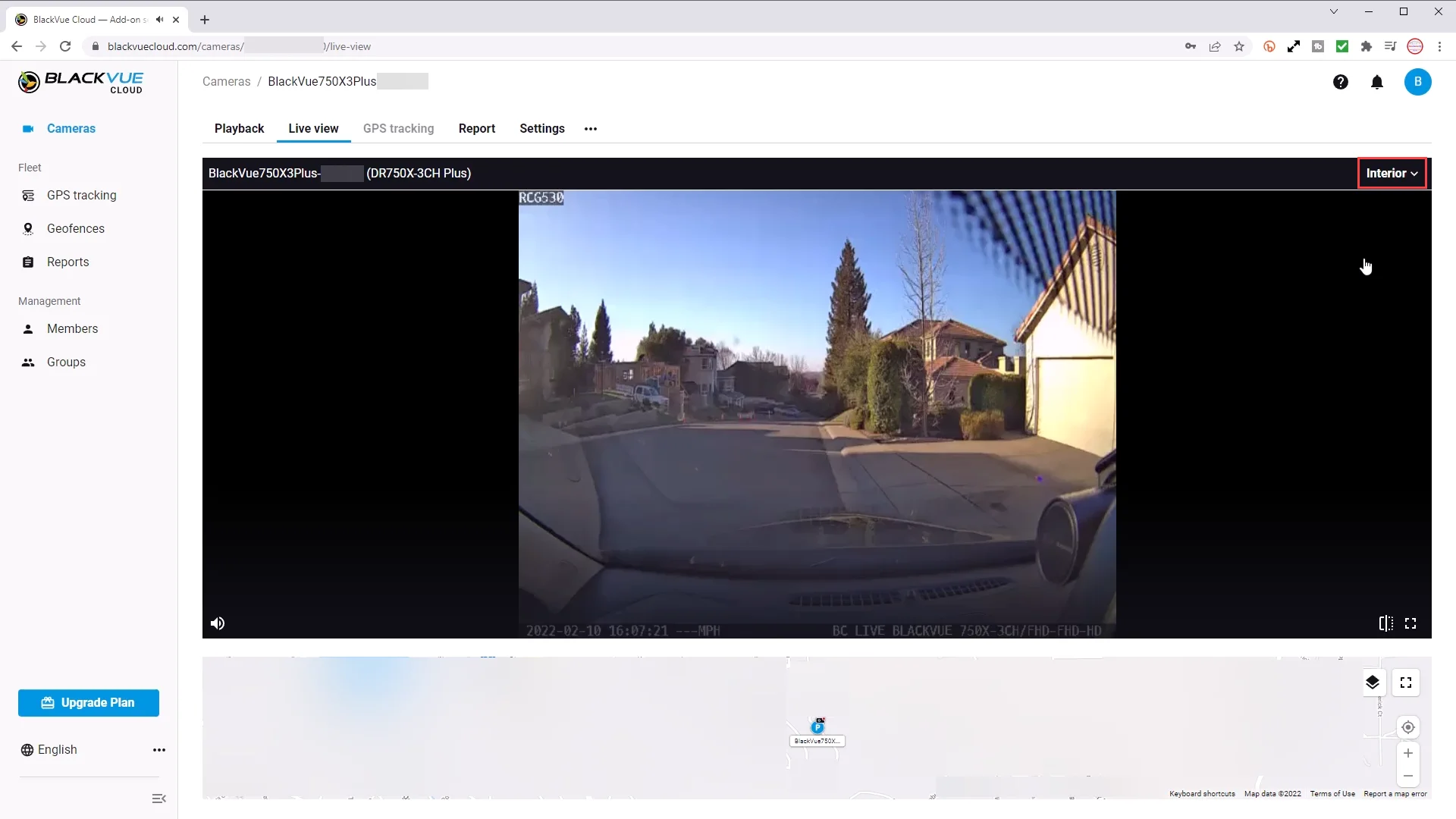

I tested the cloud Live View feature today with the DR750X-3CH Plus. The iOS BlackVue app was able to successfully view all three of the cameras.
The browser based (desktop) live view feature did not work very well. It would default to showing the front view (which makes sense). It would sometimes successfully show the rear camera feed when the rear camera was selected. It NEVER was able to show the interior camera feed. When selected the interior camera feed it would start showing the front camera feed from the first few seconds when the live feed was started and you would hear "Live View On" over and over and over. If I left the selected camera as the front camera (no changes) it would display the video and audio from that front camera only.
It tested the live view again with the iOS app and it worked correctly each time. Each time I tried the live view from the browser, it always failed to display the interior camera.
Here's a screenshot from the video I created showing the incorrect behavior when trying to get access to the interior video feed. The video status line on the bottom of the video is so dark that it's just about impossible to make out what's on that line.

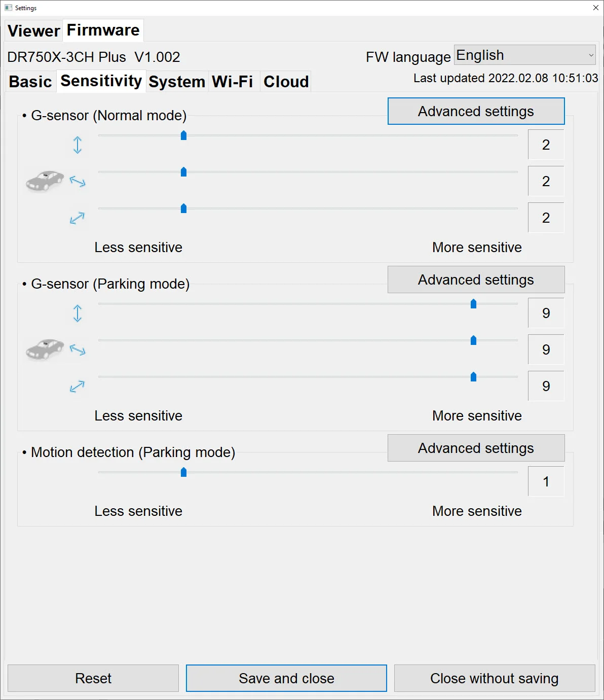

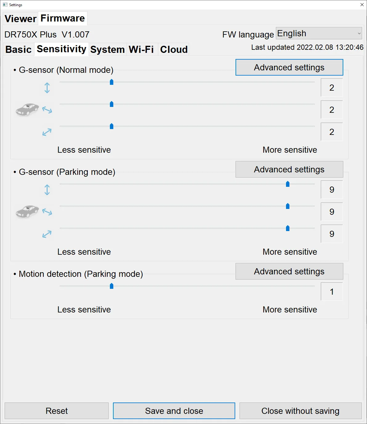

I've been testing the DR750X-3CH Plus along with a DR750X-2CH Plus dashcam in my vehicle for a while now. Recently, I connected my CM100LTE connectivity device to the DR750X-3CH Plus using the USB hub included in the DR750X-3CH Plus box.
While reviewing video, I was seeing a large number of normal mode driving impact events ( _EF, _EI, _ER ) files. After I added the CM100LTE, I noticed my phone was alerting A LOT during the first driving segment of my trips. After I would park the vehicle and the dashcam went into parking mode and then I started driving again, the insane number of impact events went back to normal (small number or none).
I have the G-sensor settings for driving mode set to 2,2,2. The parking mode G-sensor settings are 9,9,9.
dr750x2chplus_sensitivity_settings.jpg dr750x3chplus_sensitivity_settings.jpg
As a test, I decreased the parking mode settings to 5,5,5 and went on a test drive. The number of normal driving mode impact events went way down.
I restored the parking mode G-sensor settings to 9,9,9. On 10-Feb-2022, I went on a short trip into town. Just about every 1-minute segment of the drive was considered a normal mode impact event (see file listing screenshots included below). I parked the car for just over 45 minutes. On the trip back home, I drove over the exact same roads and there were no alerts being generated and all of the video files were "_N" normal driving mode video files.
On 11-Feb-2022, I went on a much longer trip (almost 30 miles round trip). The same pattern was observed. The driving segment when I left my home and drove to the first stop (of four), the number of alerts and normal mode event files was outrageously high. After making the first stop and letting the dashcam go into parking mode, the remaining normal driving segments only generated normal recording files.
I power off my dashcams while parked at home. They are powered by dashcam battery packs and I have no need to drain those battery packs nor do I need to record the inside of my garage for hours and hours. Before I leave my home, I restore power to my dashcams.
It appears when the DR750X-3CH Plus and DR750X-2CH Plus are first powered up, they appear to not get initialized with the proper G-sensor settings for normal driving mode.
I have firmware v1.002 installed in the DR750X-3CH Plus and v1.007 installed in the DR750X-2CH Plus.
I don't recall this behavior before the recent firmware upgrades, but I did not have the CM100LTE connected to the DR750X-3CH Plus until just this past week.
I've reported the issue to BlackVue/Pittasoft and I'm waiting on a response from them.

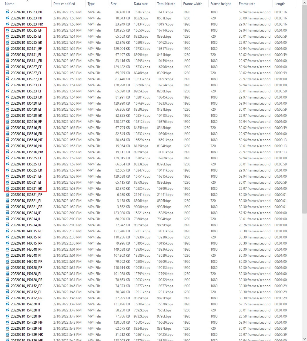

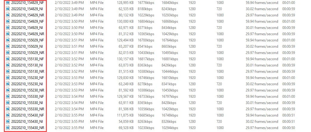

Here are screenshots of the files from the 10-Feb-2022 trip into town. The first red outlined set of files are the impact event files while driving into town. The second red outlined set of files are the normal mode video files driving back home.
