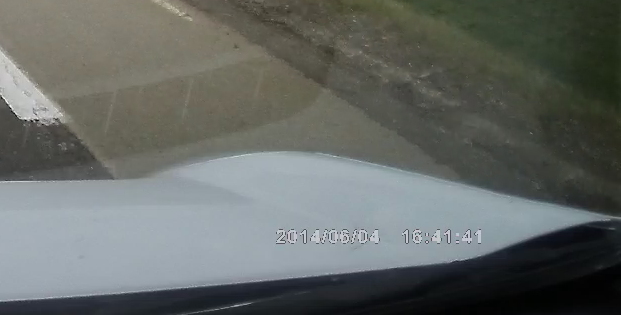

Possible to have bigger time/date stamp ?
It is really too small !!!!
G1W and even 0801 are better.
There is also a problem with white background.
So please make it bigger, it is useless like this. :confused:

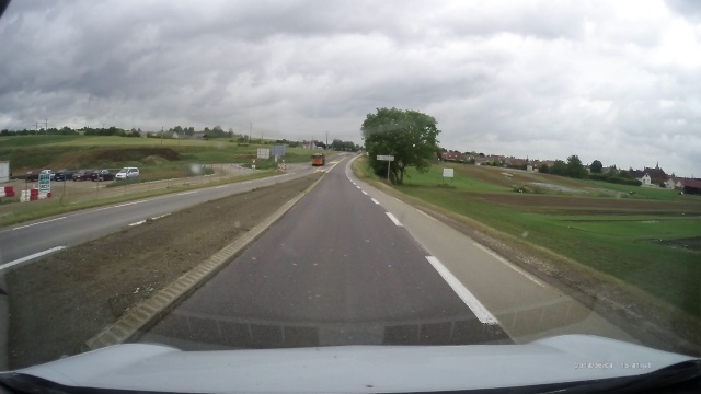

DARK VIDEO. I received my Mini 0803 a few days ago, it was an upgrade for one the cheap and cheerful 720 cams. However, I am having a few problems and wondered if anyone could point me in the right direction please? I am finding that the video on playback is very dark, I have tried pointing the camera downwards to reduce the amount of sky, but it has made little difference, is there a way in the menu's to adjust this please?
It appears that the camera is reacting too much to the light sky, so the whole video is darkened. Also, I have read on here a lot about Firmware and updating, how do I do this please, the version i have is FW20140510 V1.0.

AE metering should be done lower to better result... not centered.
Already mentioned by a member in 0803 coming thread.
Anyway to fix this in firmware ?
Not good, I spent£90 for he thing, when you mention AV adjustment, as I am not very technical minded, what adjustment should I do to the AE metering?
You have 2 differents setting concerned.
1- AE metering mode : Center or Point
2- EV correction : from -2.0 to +2.0
You just have to change the values in 0803 menus.
Very simple :)
