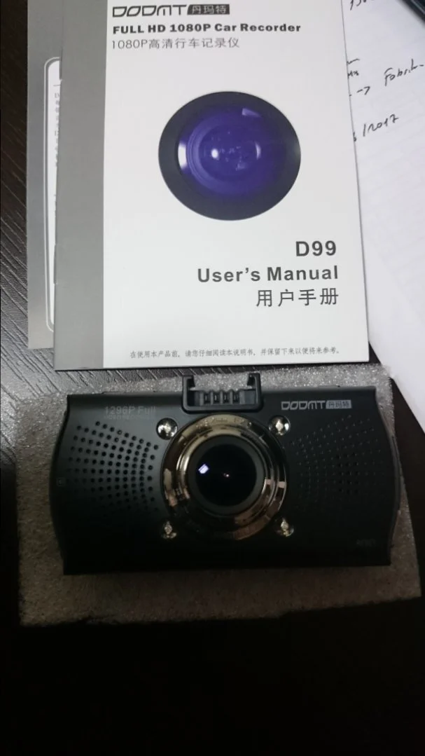

Today I received my DODMT D99. It smaller than my expectation.
As first thing, I checked firmware number! "DOB47FSHZDGE.140723.V1" is it familiar to you? Because Street Storms begin with SS..
And one more question? is street storm firmware has also English language or only Russian?
Do you know any method back-up current software in case of anything?
I've got to admit that is definitely an older firmware version - I have the same version here with the SS firmware which is up to version 150427 on their website:
http://streetstorm.ru/support/cvrupdate.php
You can back up the firmware usually with an autoexec.ash file - usually with the following contents:
firmfl gen 6 bst bld hal pri rom dsp d:\backup.bin
Create a file in Notepad++ called autoexec.ash and ensure the line breaks are set to Unix format (Edit - EOL Conversion - UNIX...) and save that in the top level of your memory card.
Now turn on the camera, stop it recording but leave it running for a minute and then power it off and pop the card back into your PC and fingers crossed you'll have a file - to test it try and load it into AFTTool and if it looks ok then you've got a good dump.
