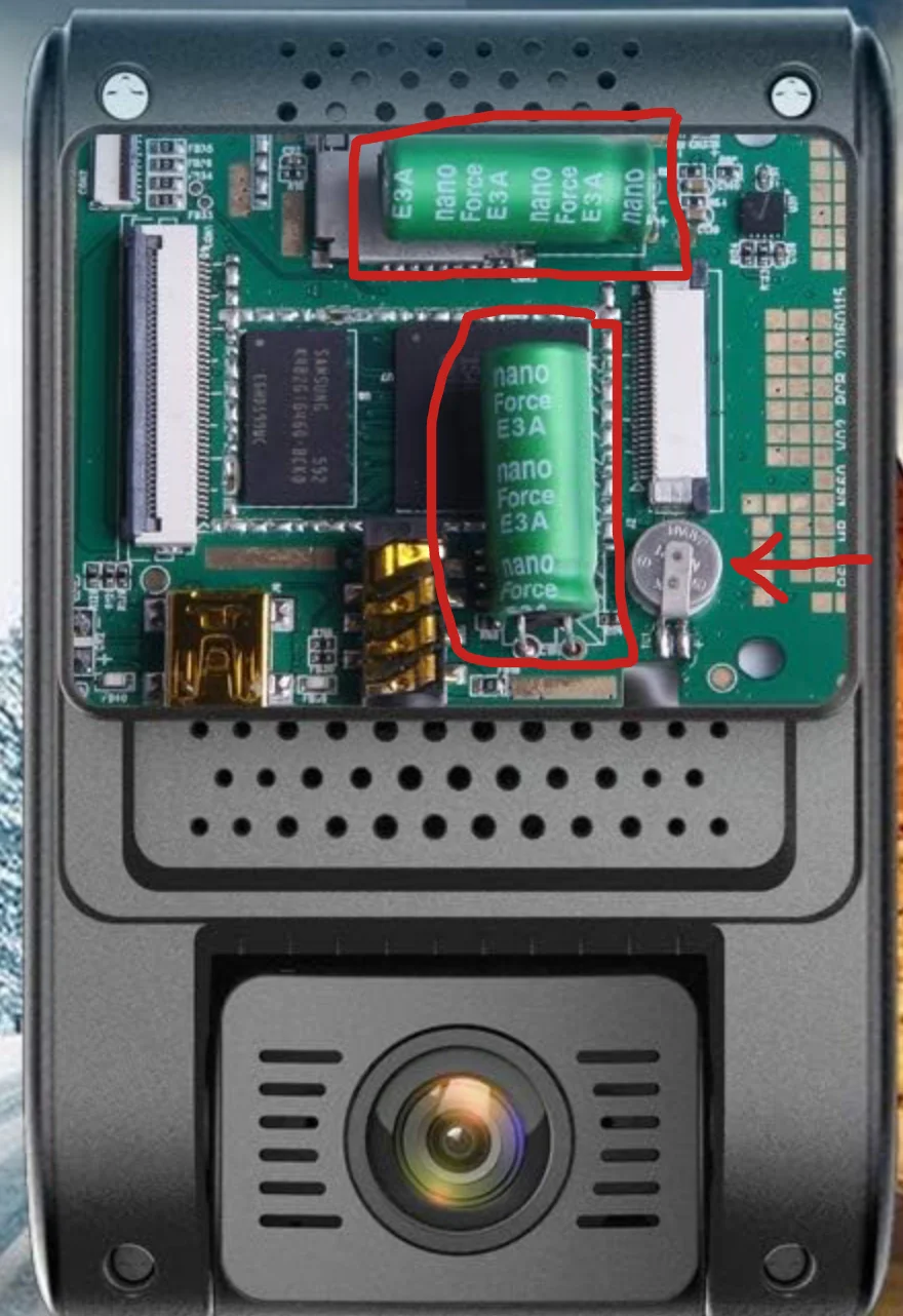

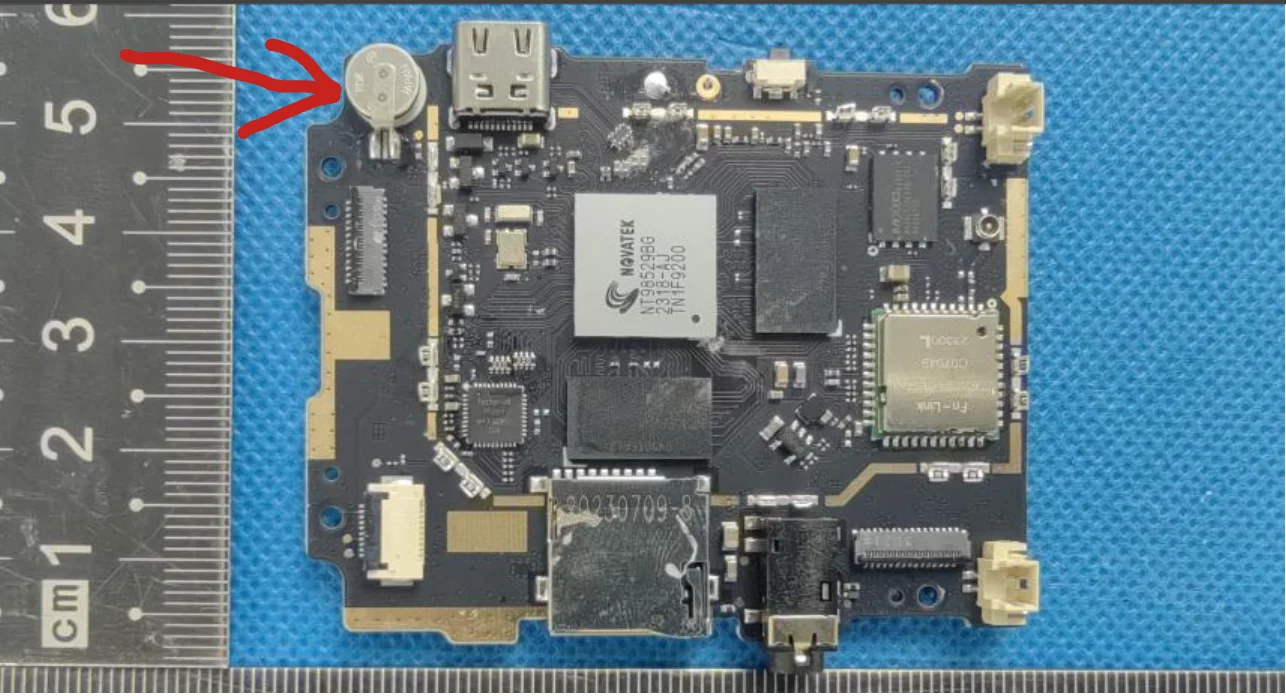

How do DVRs maintain time & date when turned OFF?
RTC BatteryAnd if so, are they effected by heat and should be replaced once a year or two?
Seems like Viofo is using a tinny battery. Too bad.
