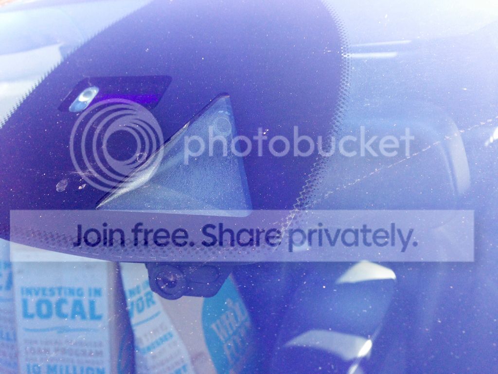

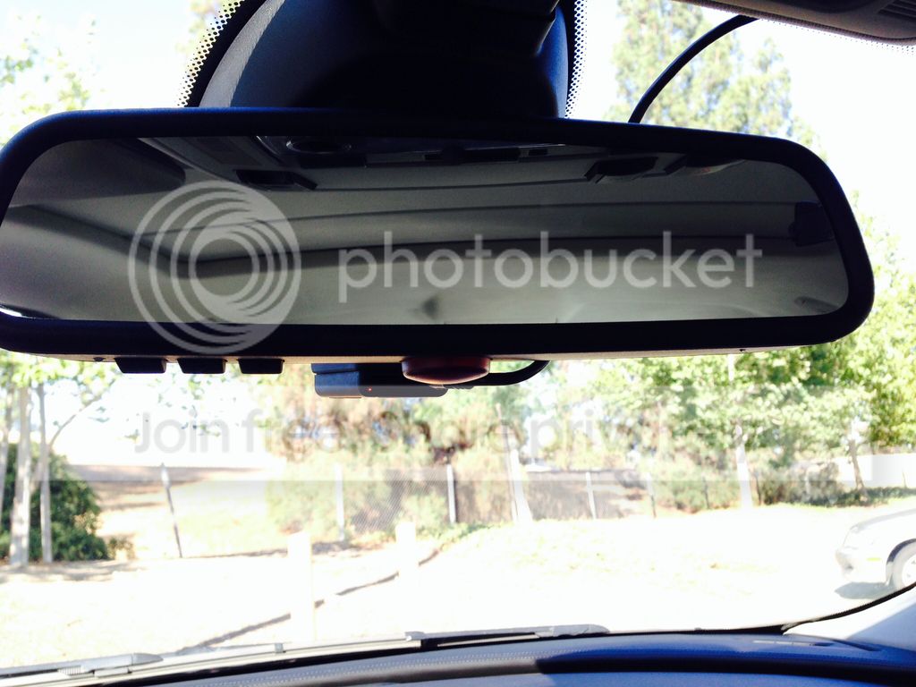

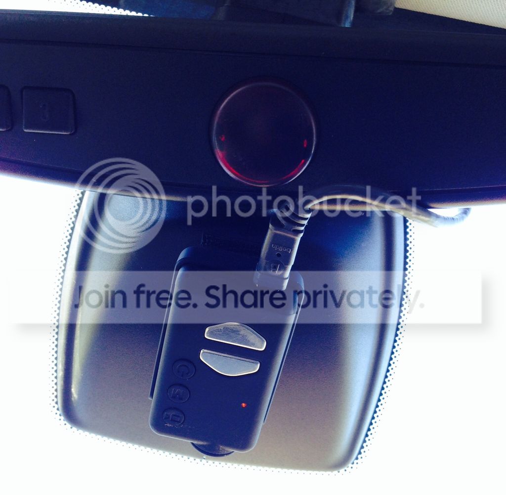

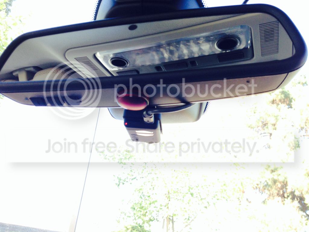

Couple of shots of my Mobius install, right under the rearview mirror housing. It's kind of a temporary install (currently looking to replace it with a better cam), so the wiring is not as clean as it could be, including the use of a right angle mini-USB adapter.
The Mobius easily slides and in out of the provided mount casing (I loosened the two "teeth"), which is attached to the mirror housing with 3M Dual Lock Reclosable Fasteners. The casing is never removed, and often, neither is the cam as it is relatively hard to see. Sorry about my filthy window, which is why I didn't include as many external shots.
That looks like a nice, clean, stealthy installation but it appears as if the camera might be pointing too high (especially the first image) resulting in too much sky in the FOV. Of course, it's hard to tell from the photos but if that should be the case, consider using some sort of wedge to tilt it downwards a few degrees.
Hey thanks. I had some other ideas to make it even more stealth, but I didn't pursue them considering its replacement cam will be arriving soon. The Mobius will be relegated to rear cam duties soon.
And yes, you are absolutely correct in that it is slightly angled higher than I want, which is due to the decline on the rearview mirror housing. I initially had something there to level it out, but I didn't like the aesthetics, which are extremely important to me. The positioning hasn't affected the exposure as badly as I thought it might, so I've just left it there for now, but it definitely would have been something I would have addressed if I wasn't looking for a replacement.
