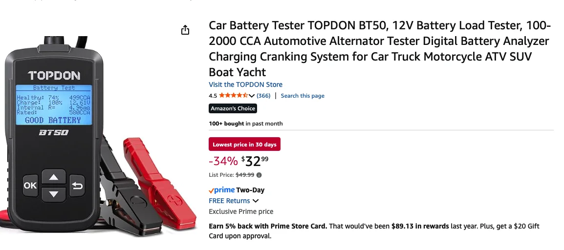

The car had its annual health check recently and there were no issues. I bought a battery tester last month and it says the battery is in good health.

I only know what happened when we used them, and the benefit of not using one. A battery analyzer, such as the one used by the OP, or something like one of the Midtronics that I used, provides far better testing with no possible damage to the battery.
Well I can't argue with the results from the Topdon BT50. Some of the cheaper electronic battery testers can be duds. Amazon reviews for this $33 unit are excellent and Project Farm tested the BT100 and BT200 with Excellent results.
It's tempting to add this to my Toaster style tester.
