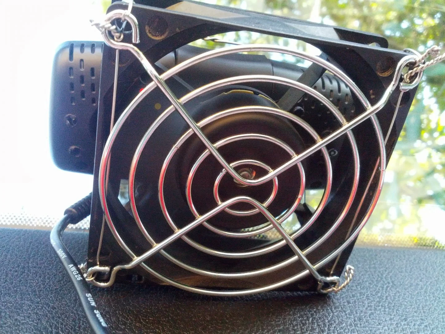

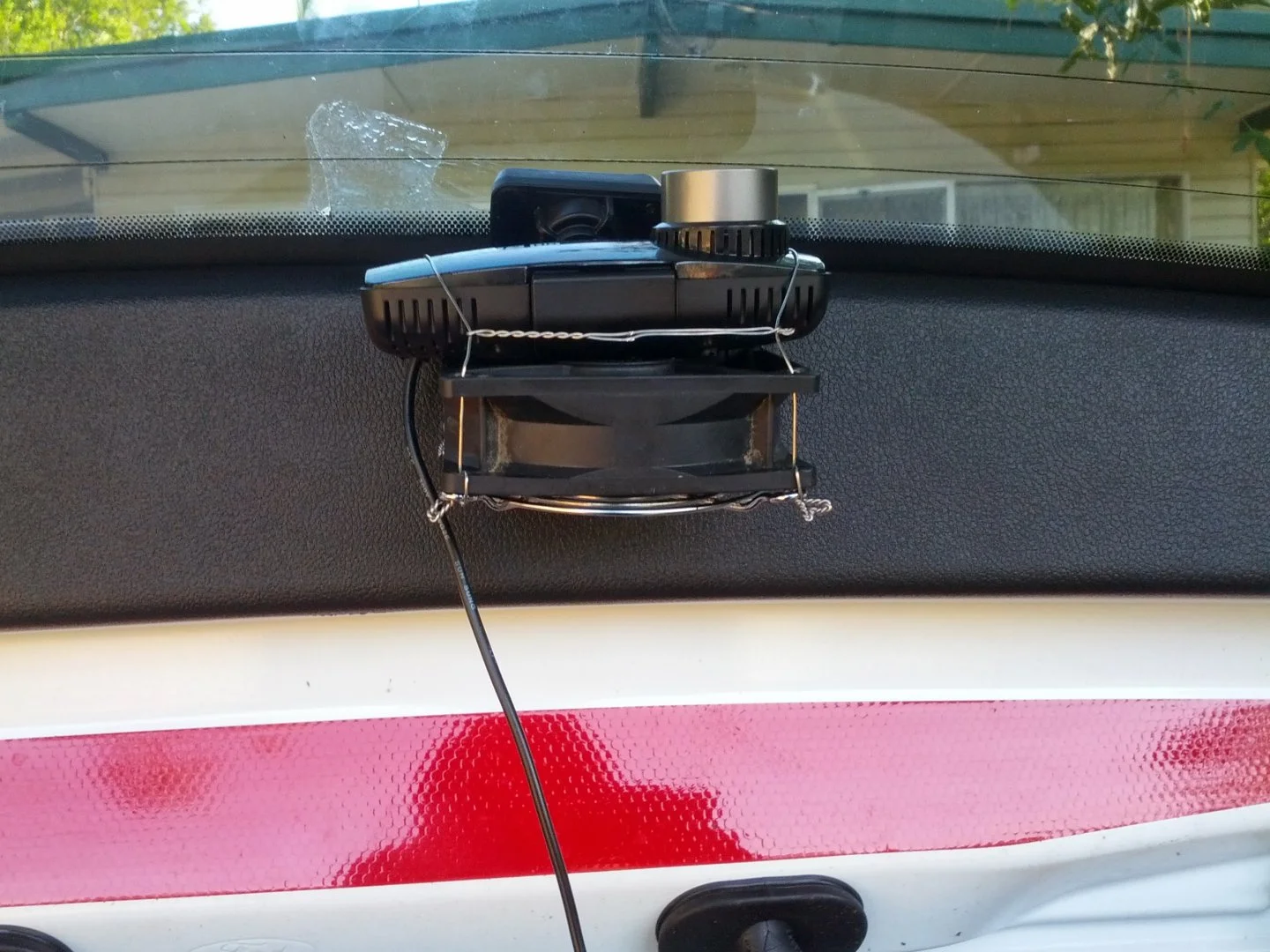

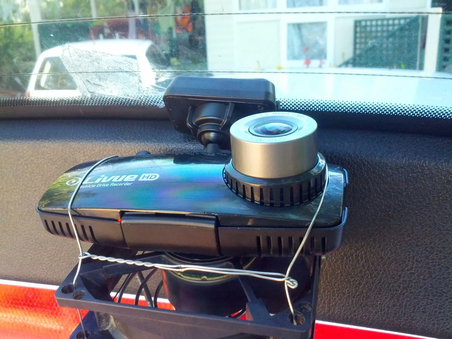

I've modified my lb-100 with a 12v panasonic panaflow soldered to the 12v input on the dashcam on the back after cutting out most of the plastic shell and using a cardboard toilet roll and duct tape to ensure the cooling was focused on going through the back and out the front of the cam. I then secured the cam using 3m sticky backs and rubberbands/elastic to minimize vibration. It works fairly well however if I were to do it again I would consider using a smaller PC 486 style heatsink fan combo like this:
https://www.ebay.com/itm/121517109582put directly on the processor of the lb-100.
Anyway, my lb-100 hardly ever crashes anymore and records 24/7
It as done so for over a year. 1 SD card sandisk class 10 32gb has died from being written to constantly but they seem to hold up better then I expected they would.
