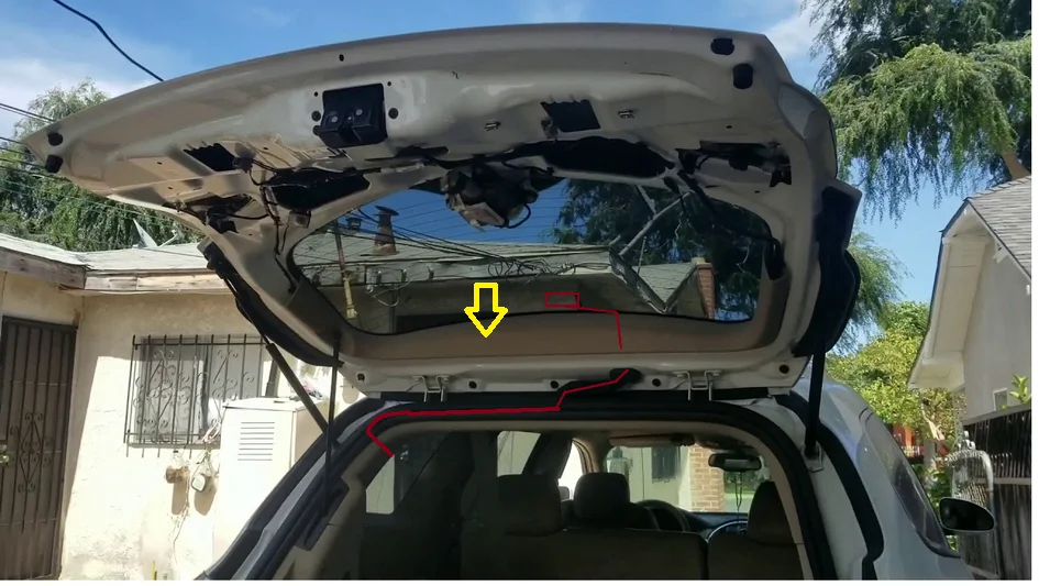

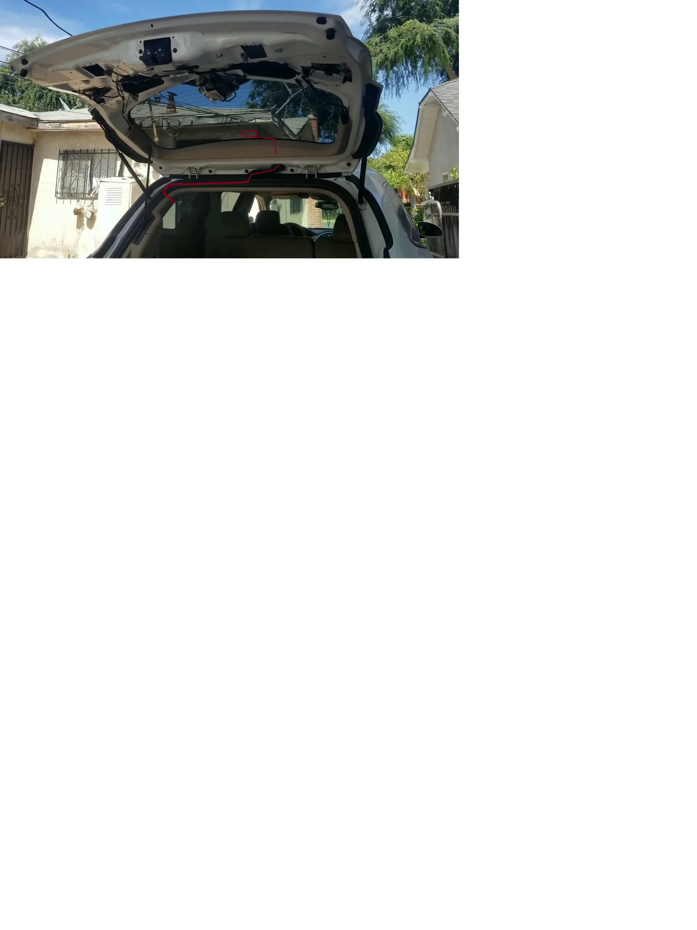

I can 100% tell by your message that you have not installed properly....See image. This as I explained before is proper wiring for the Rear Hatch.

That's not my car. I don't drive a Buick. This is a stock image I found online. The molding with the Yellow Arrow is the one that needs removed. You need to feed the wire (See red line) exactly how it's pictured. From the Rear Pillar (if there's an airbag in that pillar that trim needs removed and routed behind airbag). Up the weather stripping. To the black grommet (looks like a spring). And then Remove Trim with Yellow Arrow. And mount as described.
Any other method will result in camera cable developing a short over time because the cable is dangling and bending with opening / closing the hatch.
