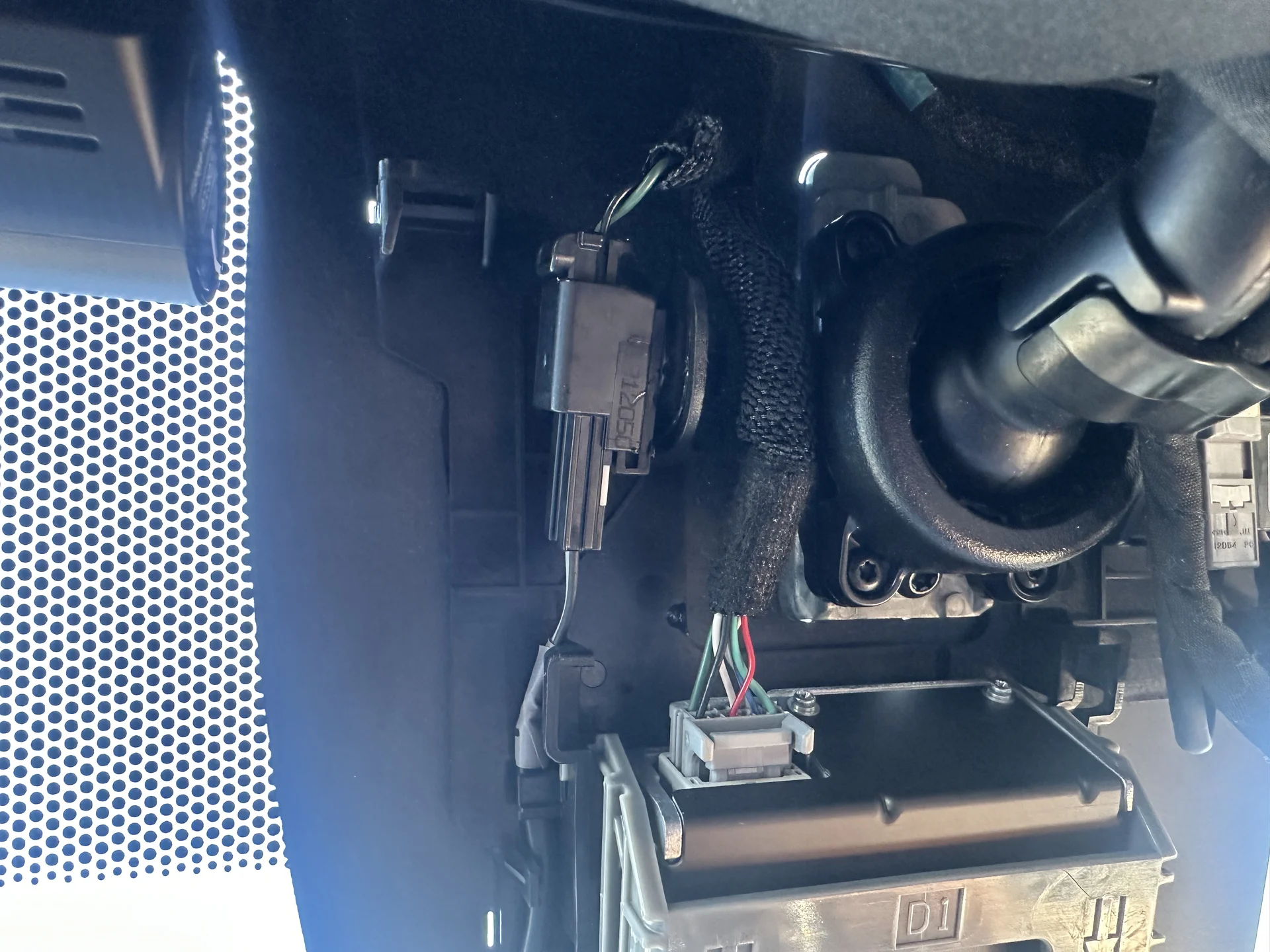

I have a 2021 Toyota Highlander Hybrid Platinum and recently installed a VIOFO A329S. I am trying to figure out the best way to power it if I want to use parking mode.
I came across the Dongar Pro 1 mirror power adapter and like the idea of a cleaner install, but I am not sure whether it will fully support the A329S parking mode features, or if I really need to use the VIOFO HK6 hardwire kit instead.
What I am trying to understand is:
  1. Will the Dongar Pro 1 properly support parking mode on the A329S, or will it only provide power without giving the camera the correct parking mode behavior?
  2. If I want reliable parking recording, is the HK6 hardwire kit the better or required option?
  3. f you are using the HK6, what cutoff voltage setting has worked well for you?
I am leaning toward the HK6 if that is the only way to get proper parking mode. I'd like to hear from people who have actually done this install on a Highlander Hybrid or with the A329S.
Any advice, photos, or lessons learned would be appreciated.

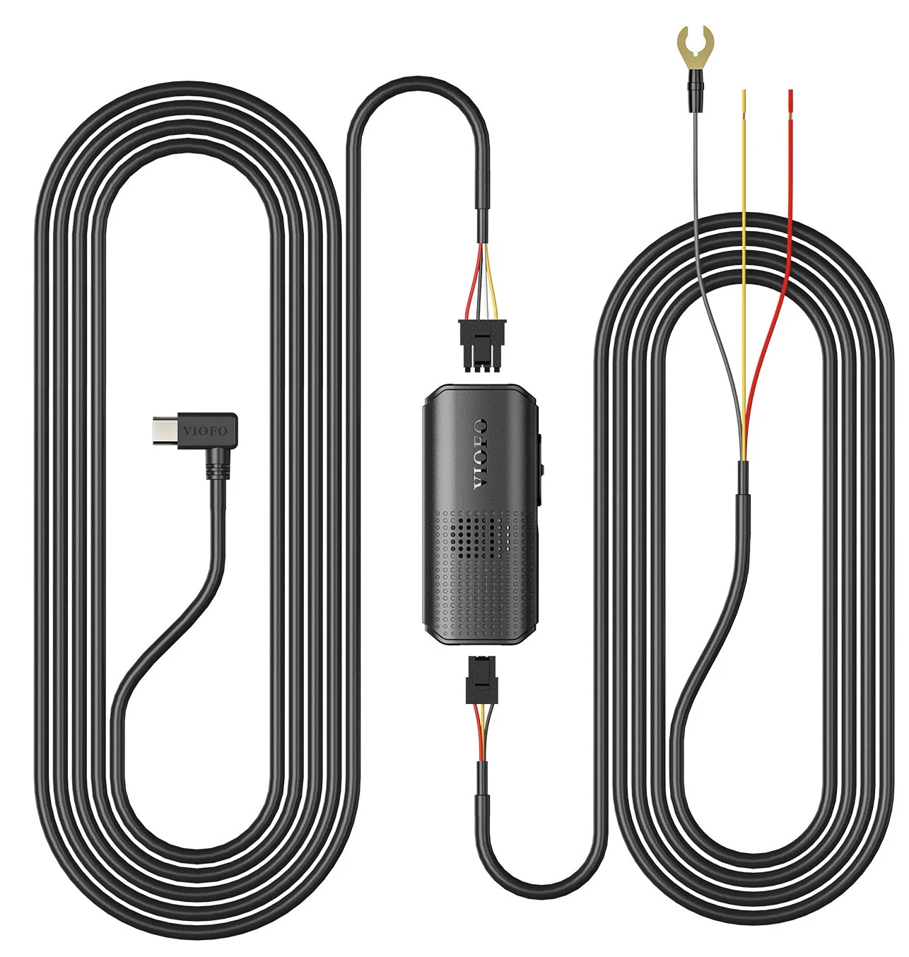

A329S requires “3-Wire” HK6 to enable / disable parking modes.
Black Wire = Ground
Red Wire = Constant Battery + Power
Yellow Wire = Switched ACC + Power
See attached photo.
I understand running wires from HK6 all the way to the fuse box is a pain in the rear.

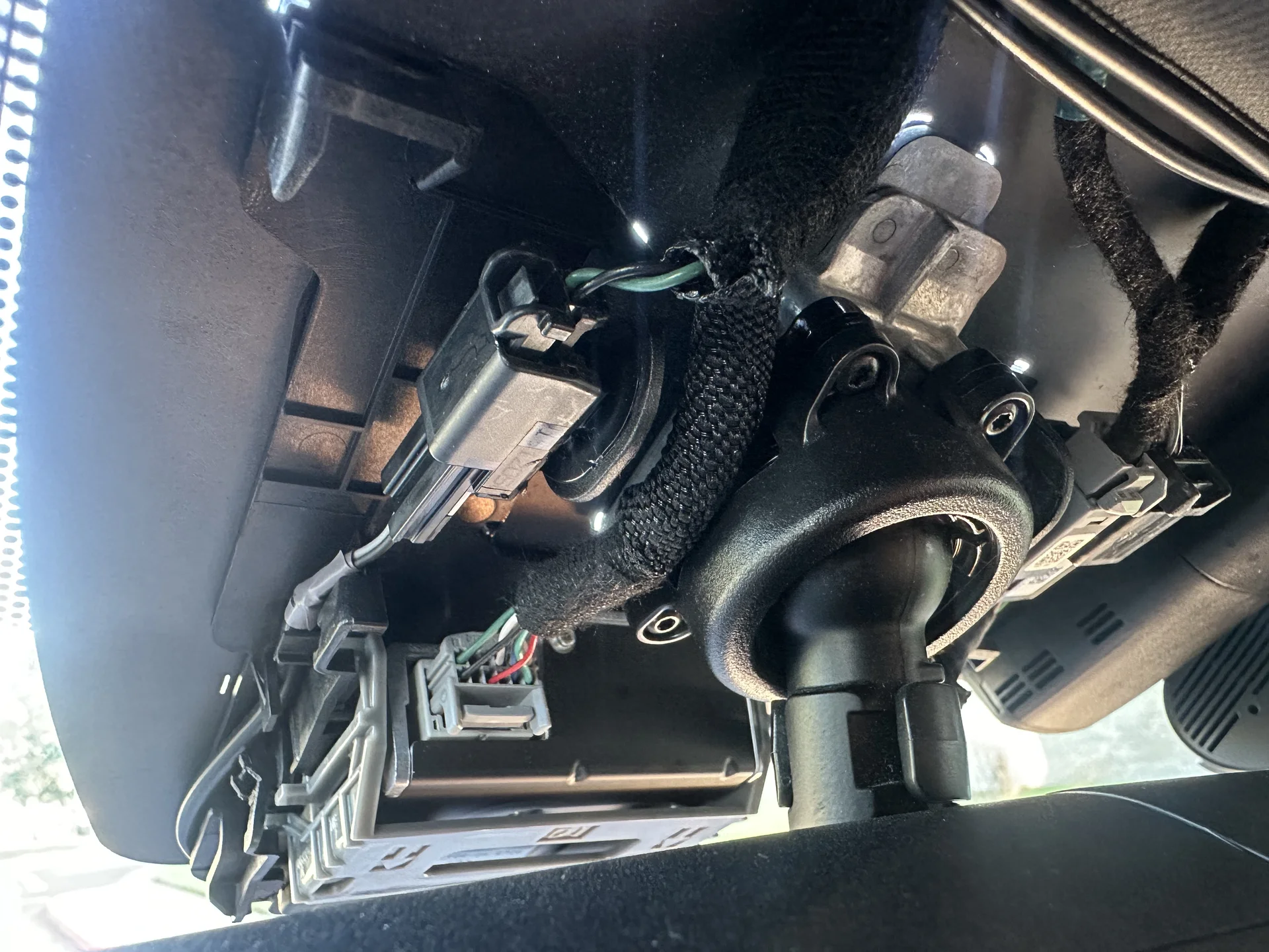

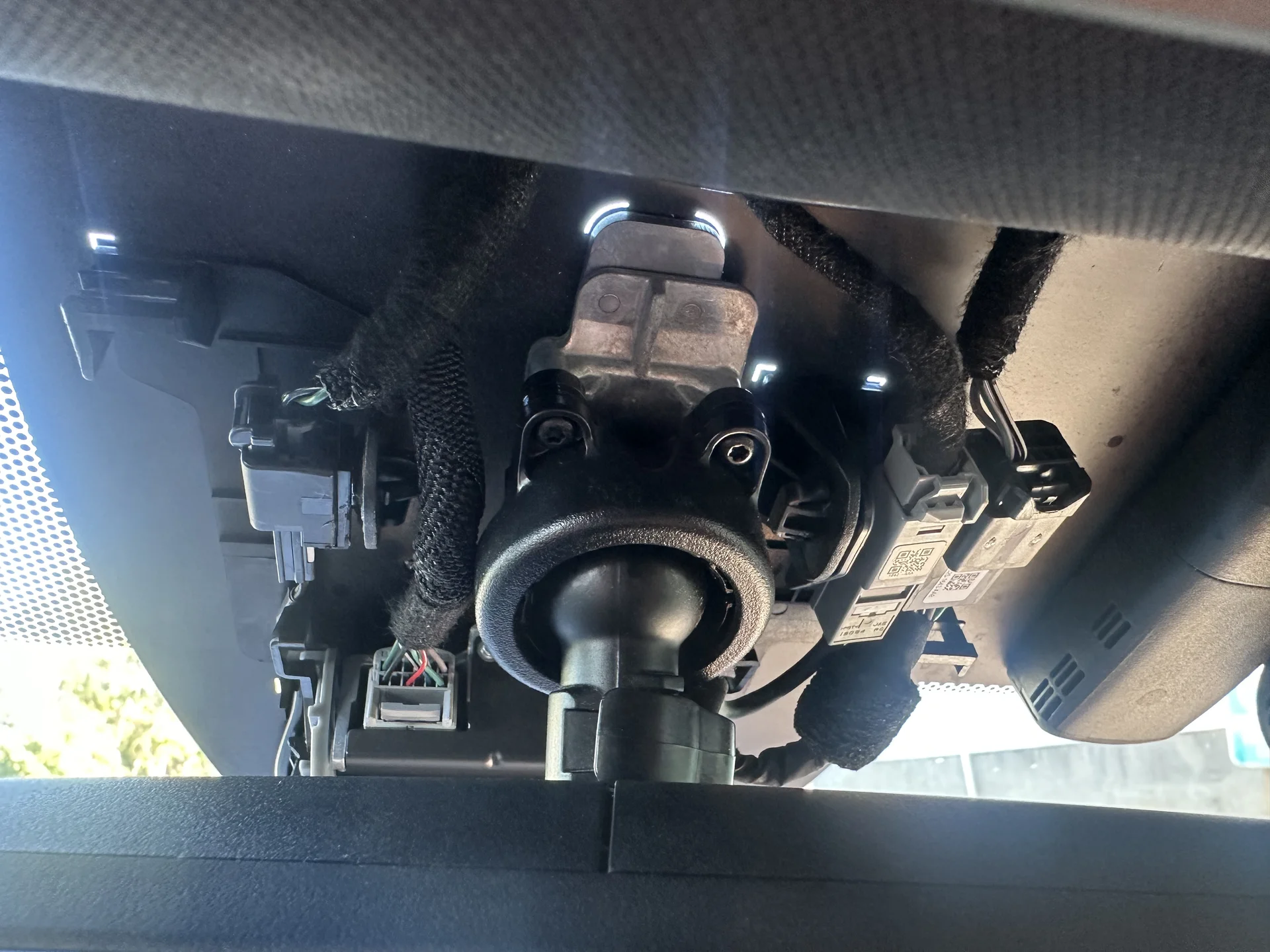

It sounds like your Highlander might have a Constant 12V Power Source in your “rear view mirror pod”.
If it does, you will only need to run HK6 wires to the “pod”.
However, you will need a “custom short version” of HK6.
12” inches of Type-C Cable, and 12” inches of 3-Wire power cable sounds about right.
You will need a basic multimeter, or test light to identify Constant 12V Power Source, and Switched ACC + Power Source in your “rear view mirror pod”.
You can order the “custom short version” of HK6 here: SUBMIT A TICKET

The dimmable mirror has a HomeLink integrated into it, so there is a constant power and ACC source available.
I will look into the custom short version of the HK6.

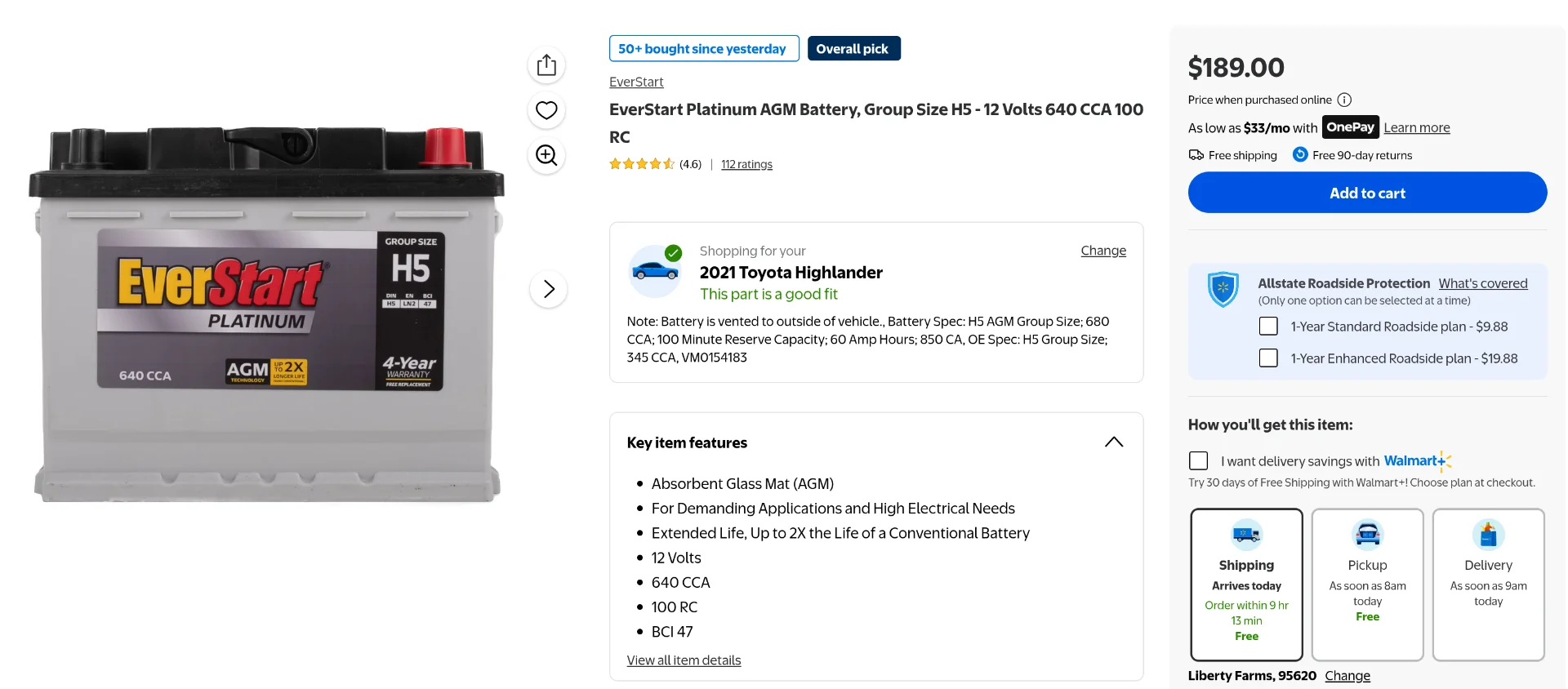

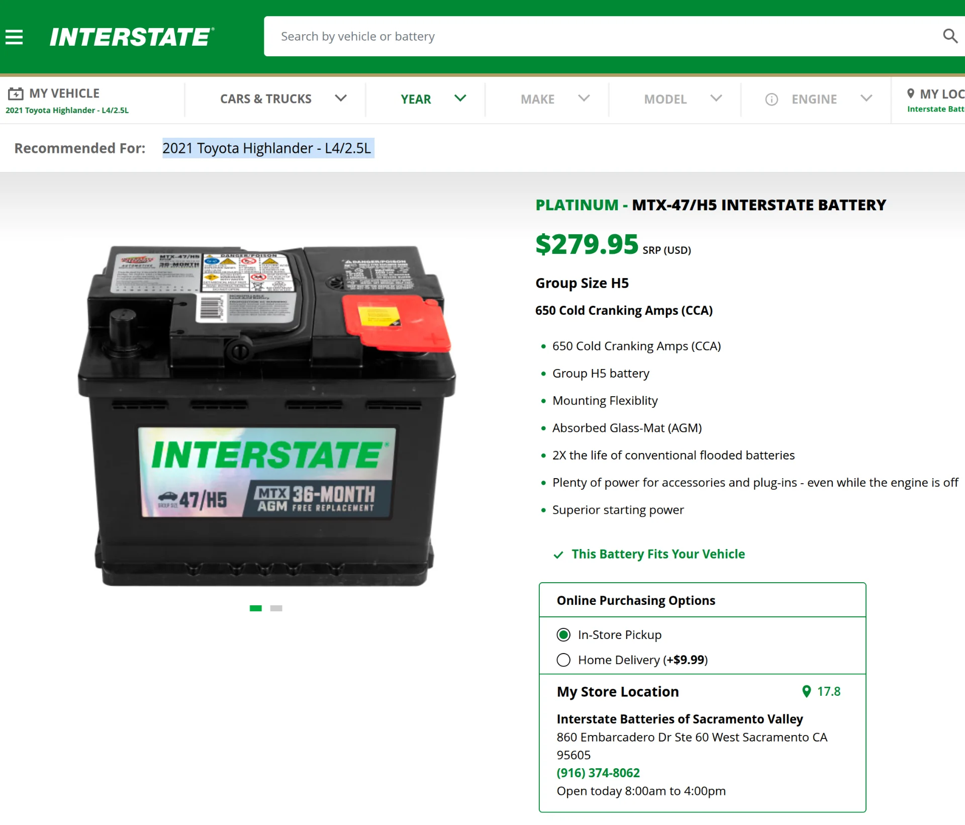

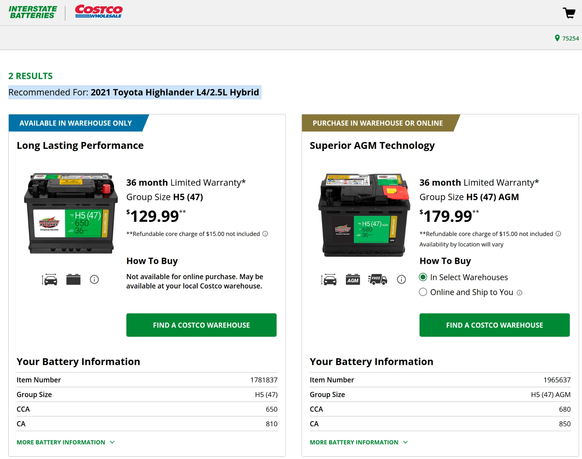

I looked up the cost for Interstate H5 (47) AGM for 2021 Toyota Highlander Hybrid;
$180 Costco Brand Interstate AGM
$280 Official Interstate AGM (only sold at Interstate retailers)
Costco Warranty: 36 Month Prorated
Interstate Warranty: 36 Month Free Replacement
Wow, for a $100 difference I think I would take my chance with Costco.
I also checked Walmart, and their H5 (47) AGM is $190, but it has a 48 Month Free Replacement warranty.
$10 more than Costco, but you get 1 Year more warranty, and it’s Free Replacement, (not pro-rated).
Now I like the Walmart battery better than the Costco one.
