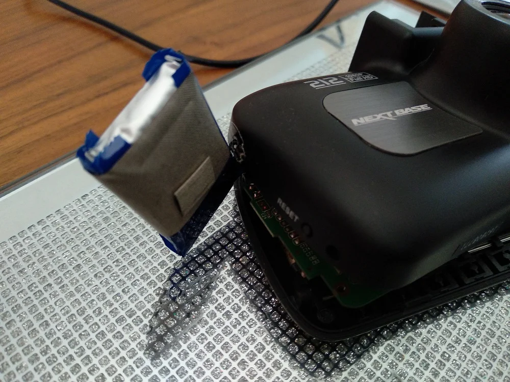

I opened it up to take a look (as we have no warranty now)
I am not sure the capacity, but I may just buy one from nextbase, I doubt I could get one myself much cheaper.
I have a couple of spare mobius batteries, but these are a different shape
I received the new battery, one of the original solder joints on the board was a bit poor, but I got the new one on in the end.
Battery now lasts about the same as the new 112 nextbase we have now. 👍
