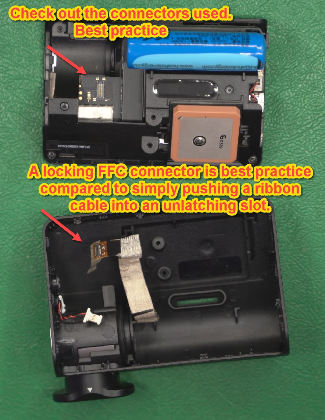

After watching several videos and not finding any that explain how to replace the battery in the 70mai A810, I decided to create one.

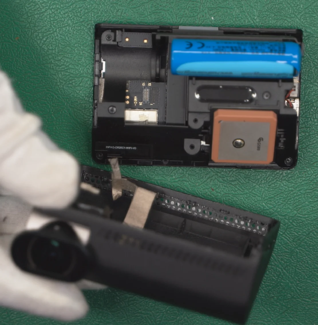

The A810 can be challenging to disassemble due to its tightly fitted frame and the way the lens interferes with the assembly process.

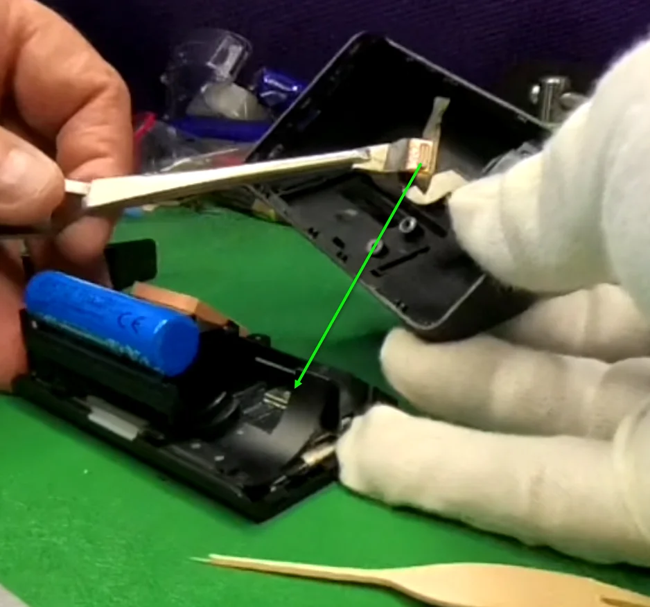

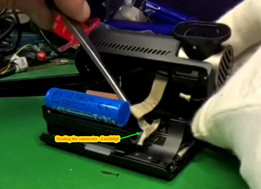

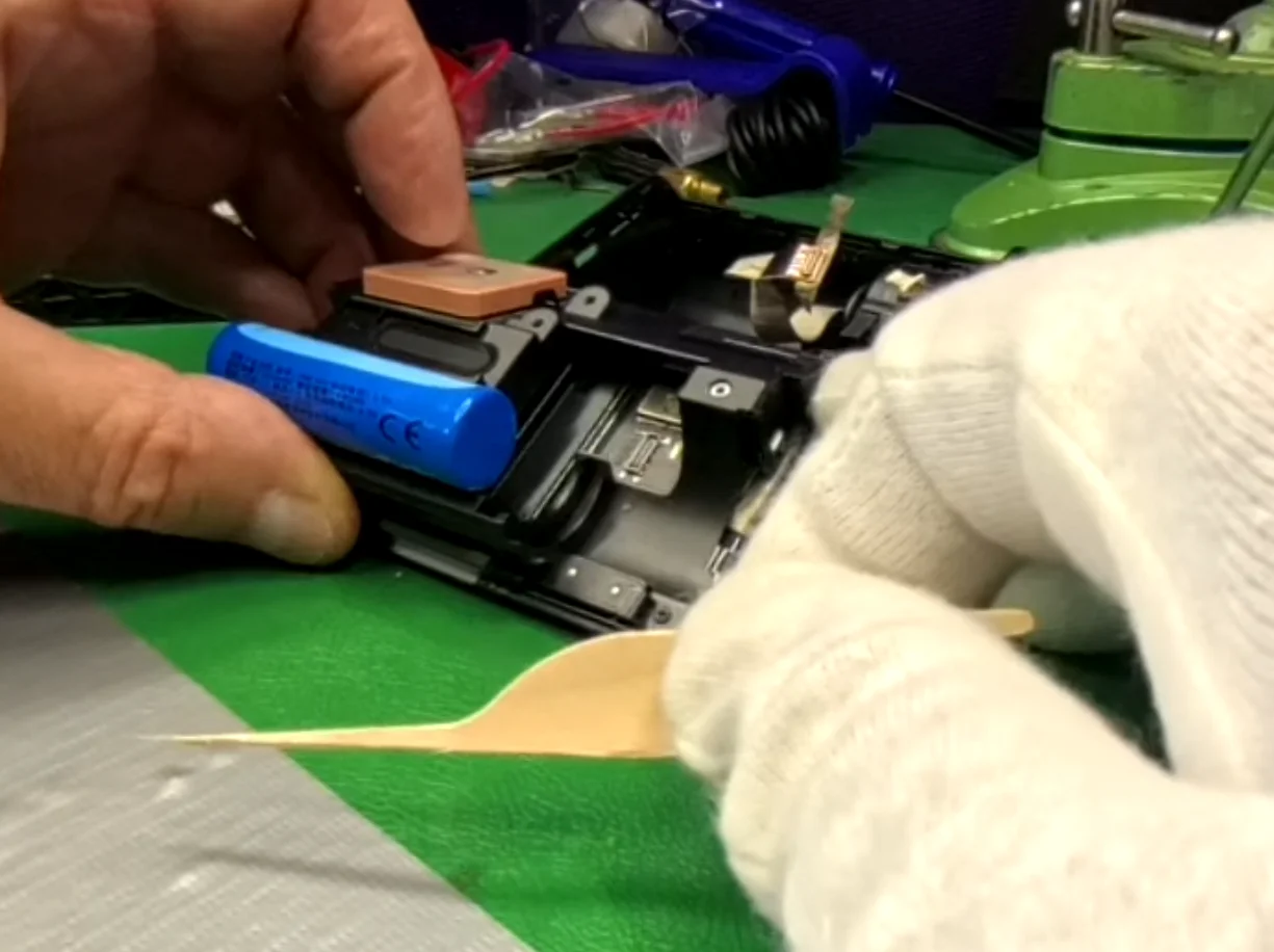

In my video, I demonstrate how I managed to carefully separate the A810 and replace the battery.
I also provide guidance on reassembling the device, as putting it back together can be just as tricky.
For replacement batteries, suitable options can be found on AliExpress.
Look for the HMC1450 Li-ion LMO* Battery, 3.7V, 500mAh.
* Note while still considered a Li-ion battery the chemistry is a little different which has some up sides to standard Li-ion
