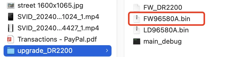

Yeah so uploading that file was still not trivial.
Within the zip file and in the file there is this file.
If I remember this was the framework and other files were for the 4g module.
I had issues withit though, camera was put into factory mode, and then some things just wouldn't work.
