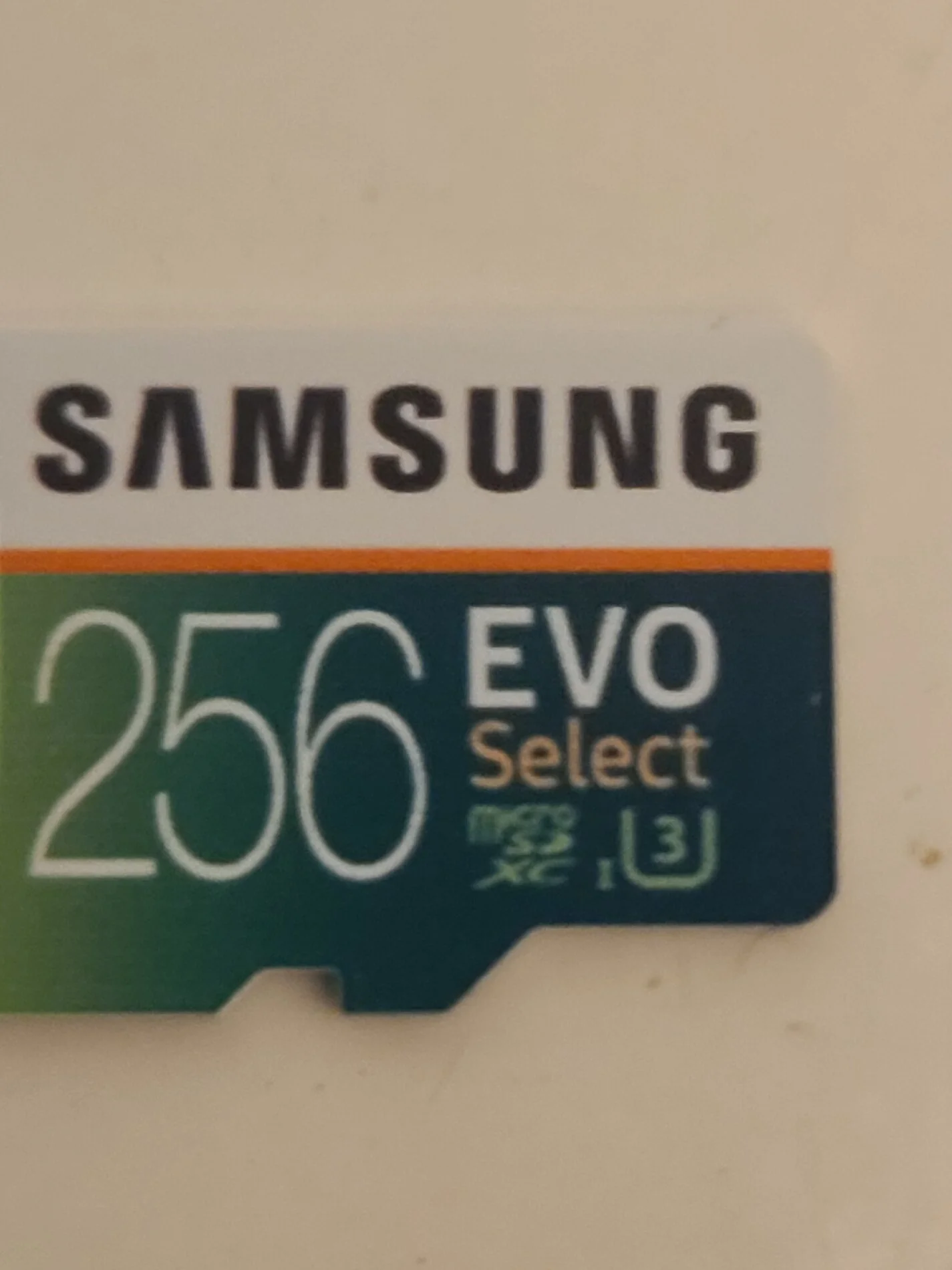

I have a Viofo 129 Duo as well as a Blackvue 750x LTE Plus. I use a 256 gb Samsung Evo Select card in the BV, and I have a 128 gb card in the Viofo.
The guys here will steer you in the right direction for cards for your A119. - Good luck!

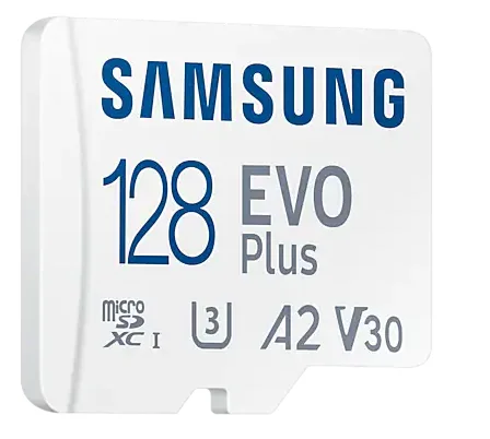

Samsung has updated their memory cards and they are now white with blue print which is similar to the Evo version and they have also a Blue with white print they call their endurance card.
  • Up to 130MB/s transfer speed (New release) Read & write speeds up to 160MB/s & 120MB/s, respectively. (New Release) Older Samsung memory card. (Being decommissioned)

View attachment 59876View attachment 59877View attachment 59878
We recommend using the red EVO card.
We confirmed there is a compatible issue with the blue text with a white background card.
