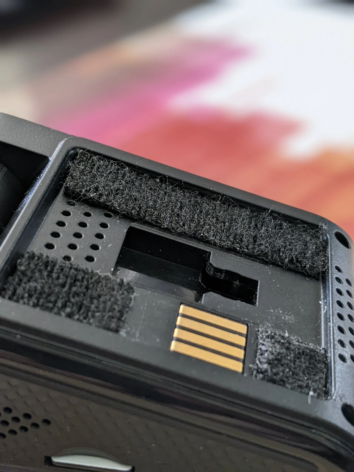

I recently bought the A119 v3 and before installing the fit of the camera in the GPS base felt fine. But, after I got the GPS base on the windshield and popped the camera into it, I notice that there's a bit of wiggle room. I searched the forum and didn't find where anyone seems to be having this problem with the v3 and the mounts that came with it, so I don't know if I buggered something up or not.
I looked at Viofo's solution but being impatient I rummaged around in the junk drawer and McGuyvered it. I used the loop side of some hook & loop tape. Notice that the loop is not very thick. I think if you try this you'll need to find something similar. There was another roll in the drawer that was significantly thicker.
The camera slides on to the mount easily and locks in solidly.
