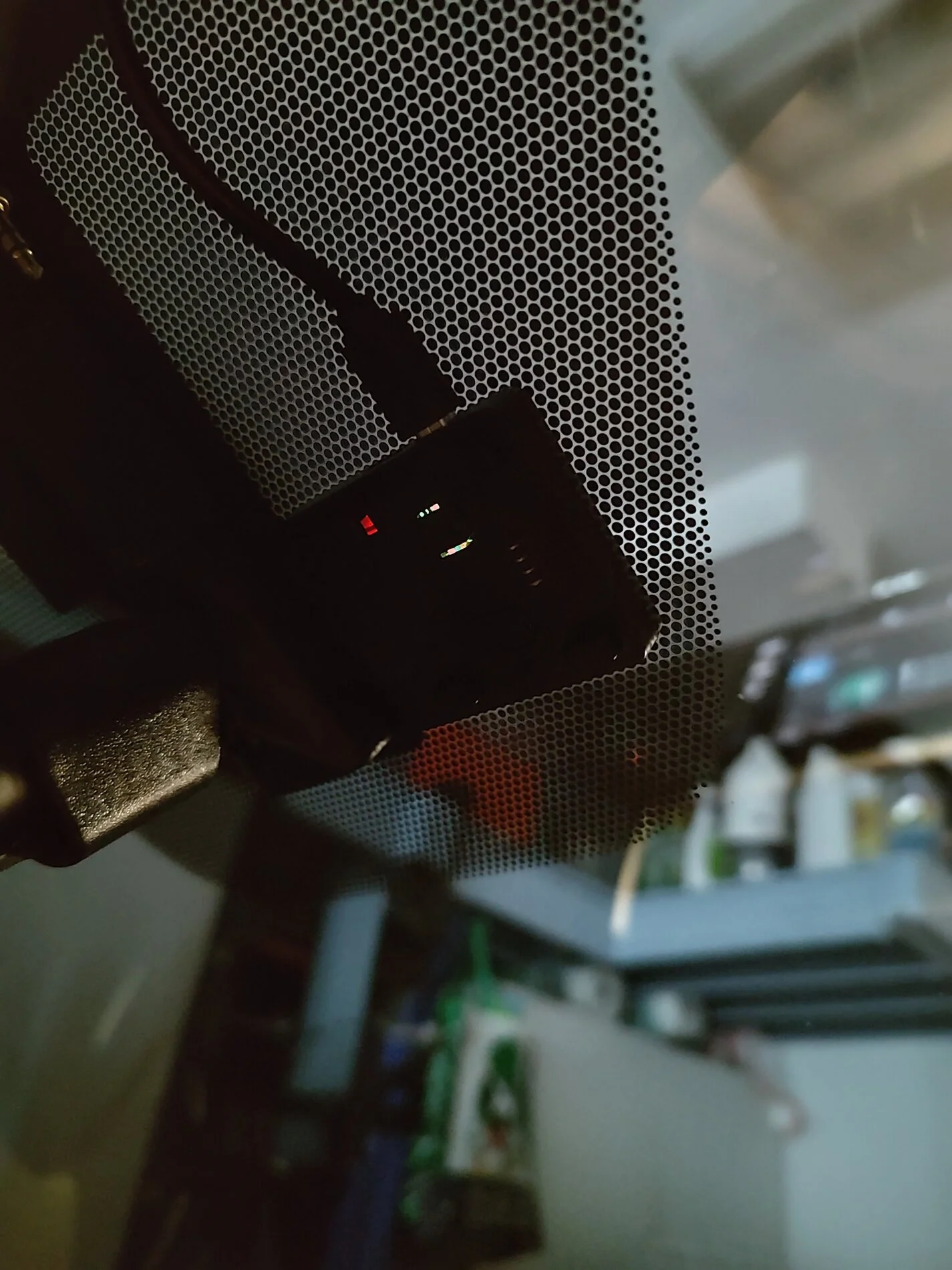

Tested pins as noted in Post #2. 5v is achieved.
LED lights:
Left one is solid Red.
Right one flashes/alternates between Red/Green.
Including a short video that displays what everything is trying to do as a complete unit.
- Powered via base unit, starts/flickers/dies/repeats.
- Powered via dash camera directly, no problem.
Occurrences do not change whether or not engine is running or in general ACC mode.
