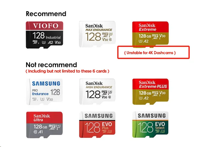

Would you mind changing a card to have a try? According to our experience, the Sandisk Extreme card is unstable when used on the 4K camera. So we have added a tip to this picture recently:
I can, and will change it for the Sandisk Max endurance 256GB but since they don't have a 512GB and that warning was not there when I ordered the dashcam, that's a bit disappointing. Just to be sure from more wasted funds, please confirm that this part number IS on the recommended list.
‎SDSQQVR-256G-GN6IA
If @viofo @VIOFO-Support is going to make a change like this on their website. They should be telling all their Authorized retailers who sell their product. It would be great to know what you found on why this SD card is unstable now?
I personally have used Sandisk Extreme Pro, & Viofo SD cards on all my (personal use) Viofo dash cameras with zero issues for over a year now. We only sell our customers VIOFO SD cards that way if there are any challenges with the Viofo dash camera it is all on VIOFO products offered.
I would like to see what process you are using to accept and rule out SD cards. Also would like to see you approve Samsung, and some other SD cards.
