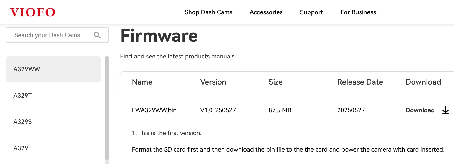

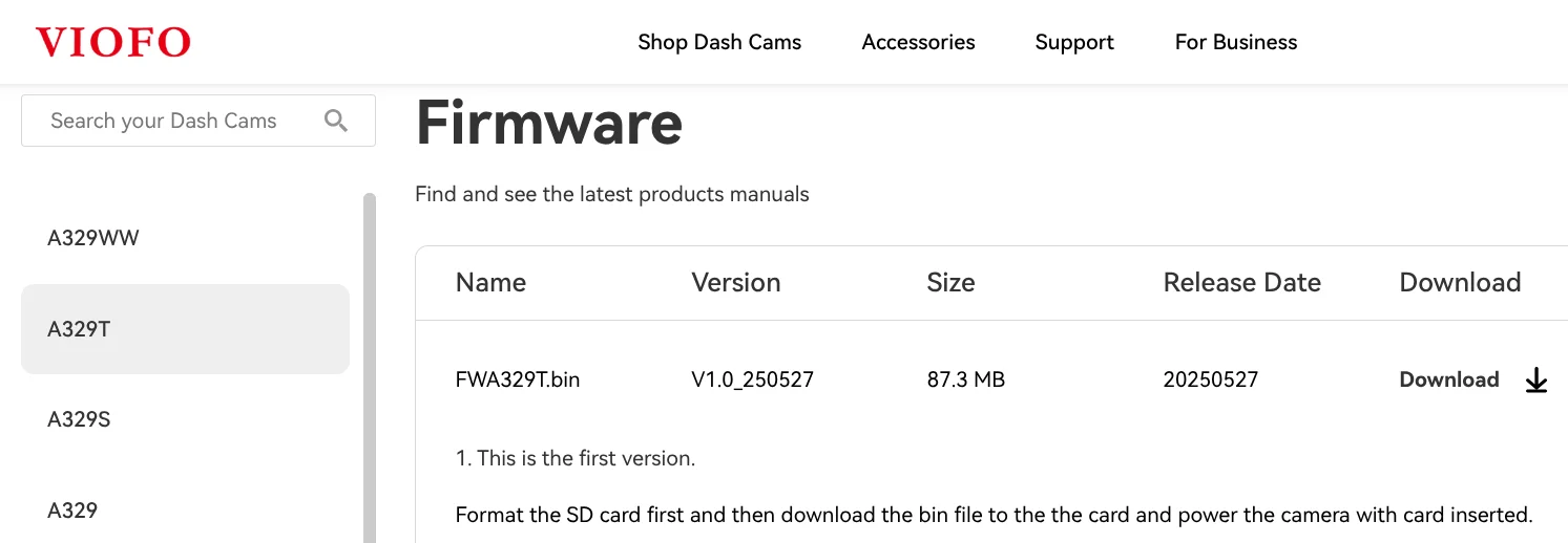

1.) Official release date Viofo.com? May 19, 2025
2.) Official release date Amazon US? July 1, 2025 (tentative)
3.) First official firmware on Viofo.com? (May 30, 2025)
A329S: FWA329S.bin V1.0_250527 87.7 MB
A329T: FWA329T.bin V1.0_250527 87.3 MB
A329WW: FWA329WW.bin V1.0_250527 87.5 MB
Check for official firmware updates here; OFFICIAL FIRMWARE UPDATES

20.) Based on remote camera configurations, how many different firmware versions are available for A329S?
Posted on Viofo.com May 30, 2025

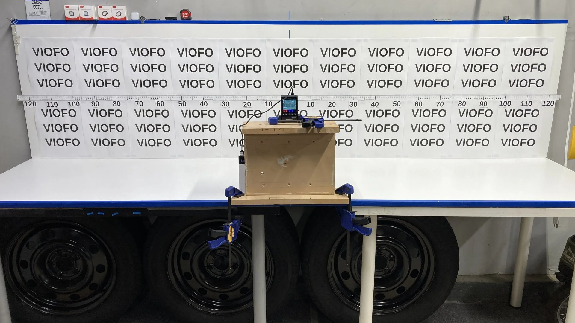

super-wide interior lens

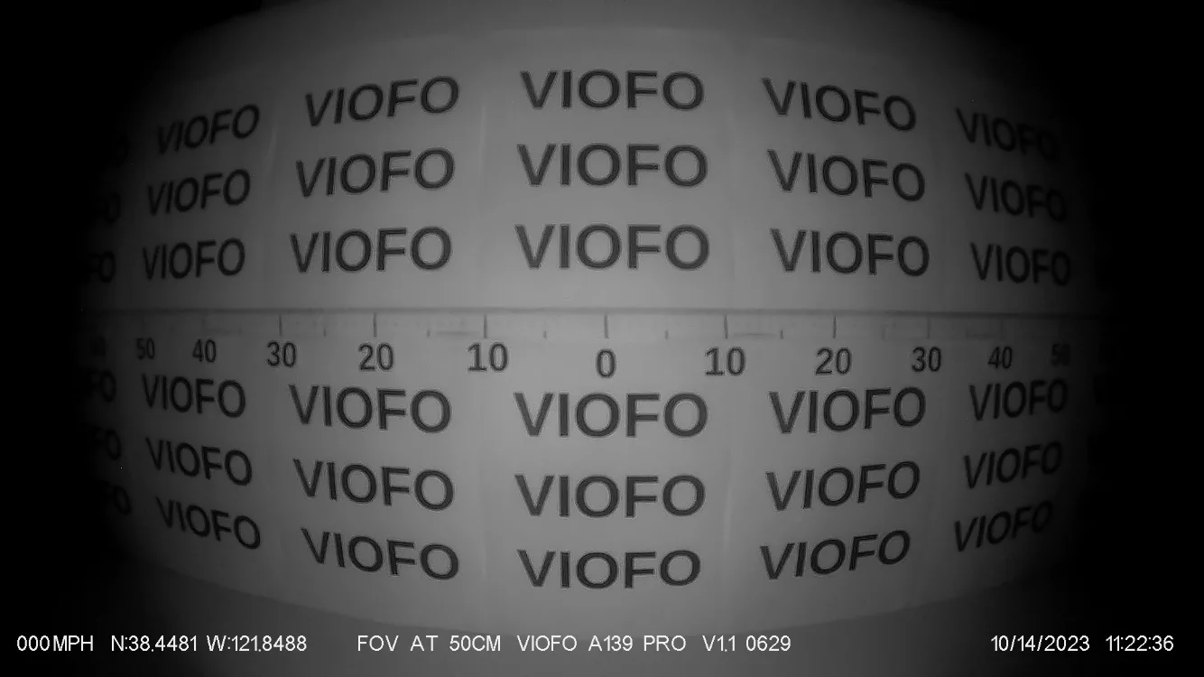

The widest FOV Viofo camera I've measured is the A139 Pro Rear.
The A329S IR Interior cameras looks so wide I think I need to add another yardstick to the wall. lol
Are you saying the list is a quiz, and nothing more? You should probably strike #9 from the list.
I think you might just succeed if you only measure half the image, move the camera to point the centre of the image at the right side of your scale instead of the centre, measure to the left side of the image.
The potential margin of error for measuring the horizontal FOV of a fisheye lens by using a flat wall is not insignificant, although I'm not sure the actual value will matter to most people anyway. You could switch to measuring the angle with a protractor.
Using Chuck's method, if the lens is actually greater than 180° FoV, then the measured length will be infinite...
He will need a circular scale to measure against, not a straight one.
I did notice that on Mtz's windshield, his rear facing camera is looking out the front of the windshield on both sides, which suggests that it is >180°, but windshields are curved, so maybe not... It is going to be close to an infinite measurement on the straight scale.
The lens angle is so wide that you need to buy a larger house to make the correct measurements. Viofo must sponsor it!
My prediction is 210° horizontal FOV.

Another thing I want to measure is how much the FOV is reduced in total darkness when the IR LED’s are illuminated, (it only has 4 LED emitters).
The A229 Pro IR Interior camera dropped to only 4 LED emitters so it could accommodate the light sensor for more accurate switching between color, and B&W.
The A139 Pro IR Interior has 6 LED emitters.
84° = A229 Pro IR Interior LED’s illuminated
98° = A139 Pro IR Interior LED’s illuminated
When Ben filmed the comparison of the IR Interior cameras from the A229 Pro & A329S both camera’s LED emitters were illuminated so they had twice the amount of IR light.

Your prediction is OK, for sure it is not just 180 degrees, don't blame the car window because it is not so curved. You can use that value in your tables and nobody will be disappointed about that.
I'm sill going to measure, I ordered more yardsticks. lol
But you are doing your calculations in meters!
The correct solution is to bend the ruler into a circle running around the camera at a constant radius. If you do that then you will need less yardsticks, and you don't need to use Pythagoras, since each mm is the same amount of degrees, the maths is just a multiplication.
An easier, but less accurate, solution would be to measure only the centre half of the image, then if it is 100°, the full image will be about 200°. There will be a small error due to fisheye.
