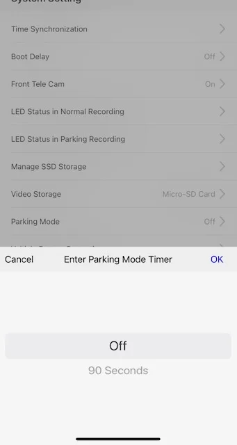

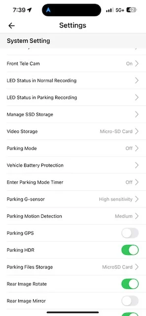

posting some pics of the settings and the Celllink info..

Just to cover the basics of a new installation, please verify the following:
  • Make sure the HK4's USB-C power cable is plugged into the GPS mount's USB-C port
    • The A329T's USB-C port on the left side of the front camera will allow it to power up, but it's not the normal/supported method of powering it in the vehicle with the HK4/HK6 hardwire kit.
  • Confirm the PowerCell 8's 12V output power cable is properly spliced with the VIOFO HK4/HK6 hardwire kit
    • The red and yellow wires serve different purposes for the PowerCell 8 and the HK4/HK6
      • PowerCell 8 12V output cable wire color => HK4/HK6 12V/24V input cable wire color
        • Constant Power: Yellow => Red
        • Accessory/Switched Power: Red => Yellow
        • Ground: Black => Black
  • Make sure the HK4/HK6 low voltage cutoff slide switch is set to its lowest setting
    • To use the largest amount of the stored power in the PowerCell 8, you need to make sure the HK4 will not turn off too soon [too high of a voltage level]
    • Set the HK4/HK6 low voltage cutoff setting to 11.8V.
  • A329T's "Vehicle Battery Protection"
    • If these settings are used, their behavior will depend on what parking mode type you've selected.
Really appreciate your thorough response, THANK YOU! 🙂. I changed a few settings and I do believe I have fixed it. I did have the cord plugged into the side of the camera and not the GPS unit.. this was ONLY because when I was having problems I moved the cable around to the side so I could quickly unplug it and plug it back in to get the unit running.
