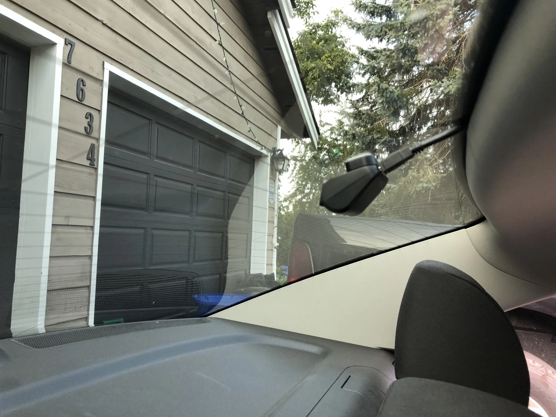

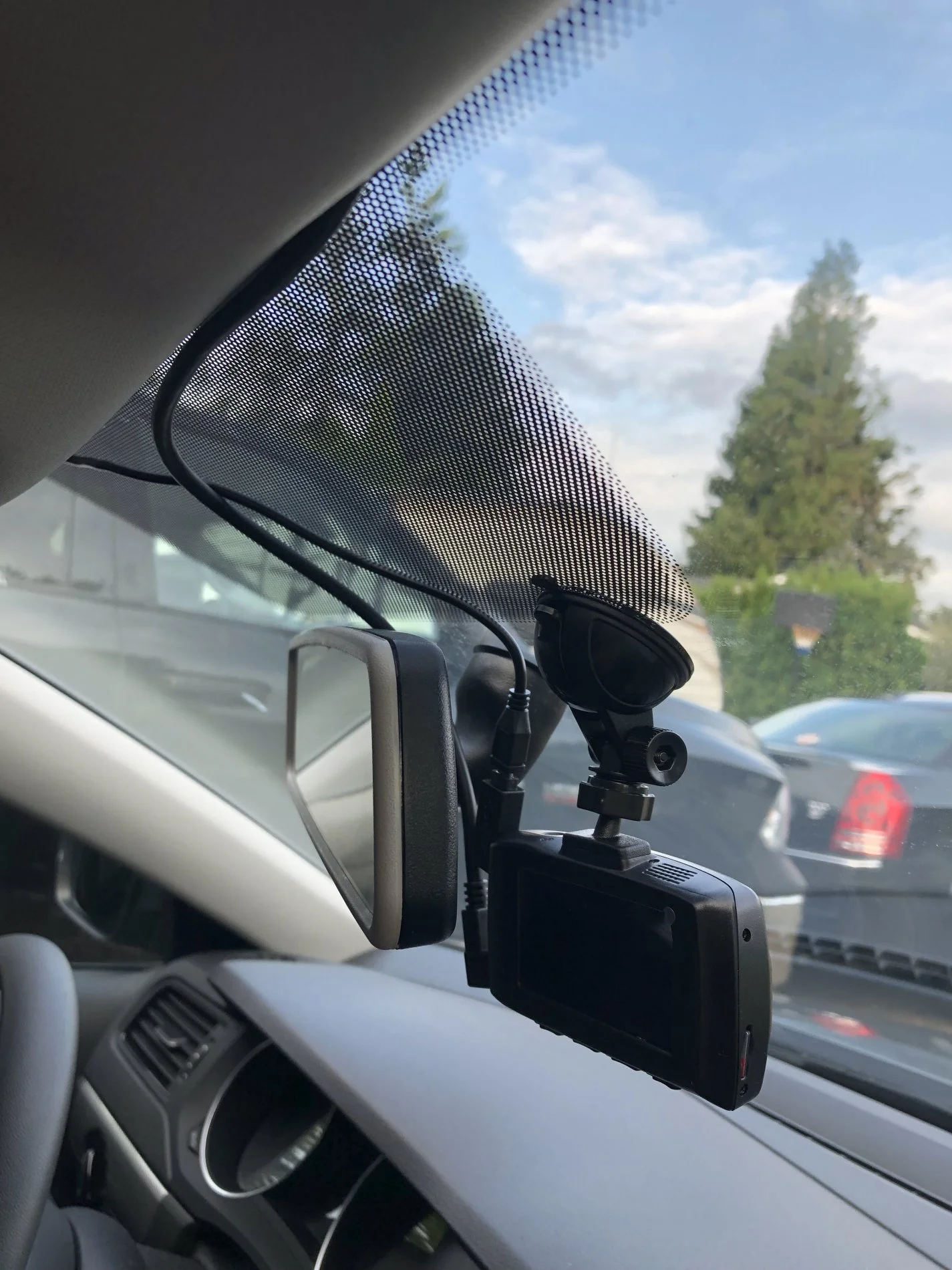

Bought one a week or two ago. Took a few hours to install properly with a fuse box hardwire kit, I found an empty fuse slot that had power without ignition in my Jetta Mk6. Running behind drivers door seal then behind the a-pillar cover and under the headliner to the mirror. For the wire to the back camera I ran most of it under the headliner around te passenger side perimeter. I was quite surprised by how long the cable was, I had about 4-6 feet of extra cable which I bundled with zip ties and tucked into an empty space in the c-pillar then continued to the rear tinted window.

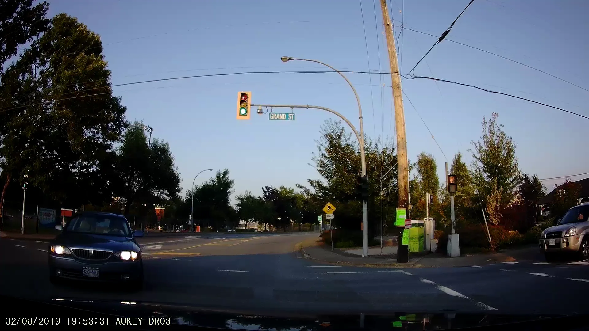

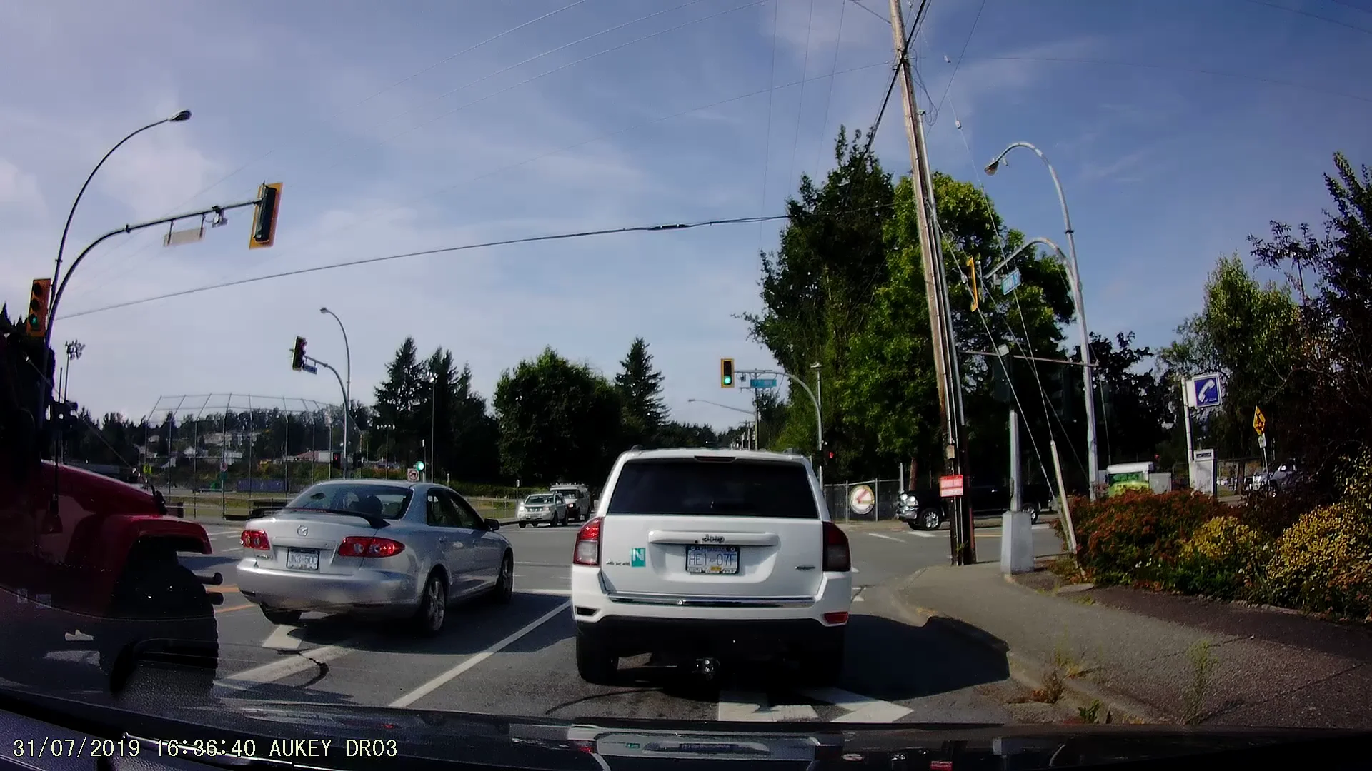

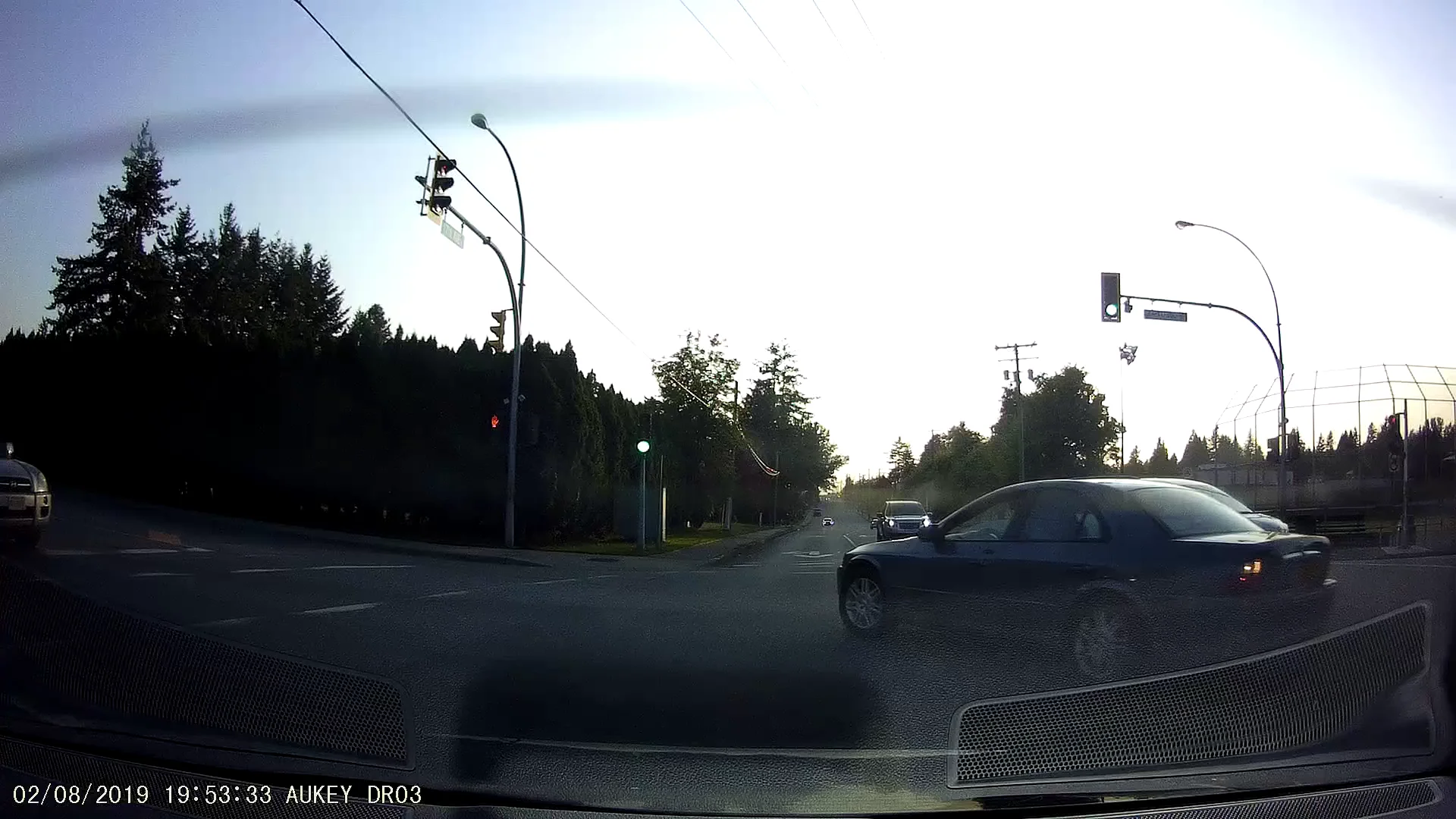

Yesterday I took the card out for the first time to look at a bit of footage, I only took a quick look at a few seconds of video. The first thing I noticed, was I could see a strong reflection of the dash in the front and same in the back, however that is more or less irrelevant since it is circumstantial, however if you buy one, or any dash cam for that matter get a filter lens for it. I haven’t yet. The second thing I noticed, the quality was not very good, not compared to the videos/stills I have seen posted from the DR02, though it may be the settings I’m using or the reflection messing it up. The last thing I noticed was that the tint on the back window made very little difference to the brightness and colour of the rear image.
