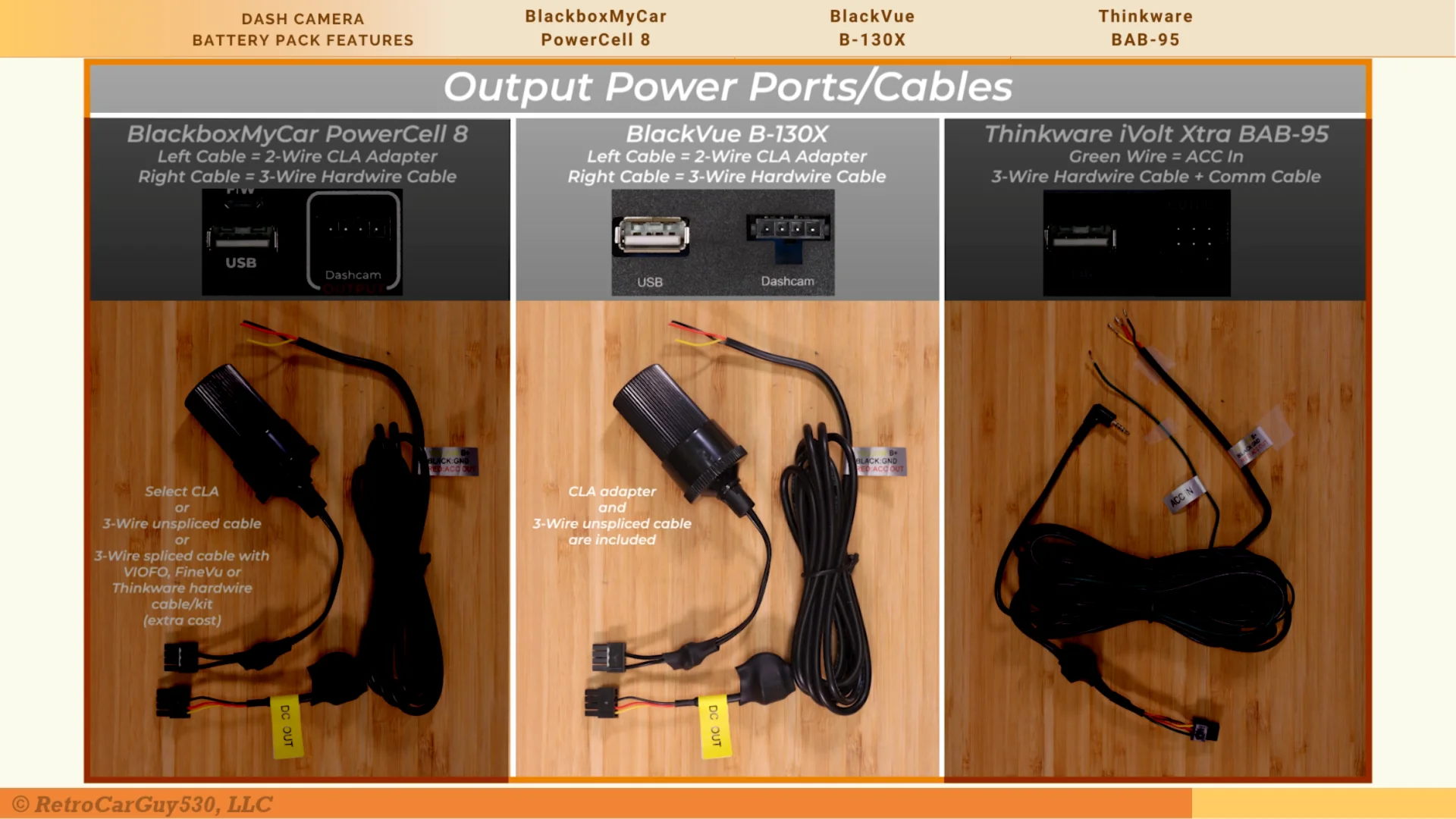

If the DR970X dash camera does not receive power on the ACC power wire going from the B-130X to the DR970X, I can see how it would be "stuck" in parking mode. The BlackVue B-130X battery pack is supplied with a cigarette lighter adapter [CLA] 2-wire output power plug and a 3-wire unspliced hardwiring cable. I'm assuming the DR970X is connected to the B-130X using the BlackVue 3-wire hardwiring cable.

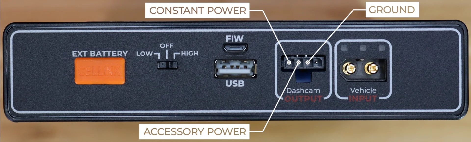

There two 3-wire cables involved in connecting the B-130X power to the DR970X dash camera. The first cable is the 3-wire cable provided with the B-130X. That cable plugs into the connector labeled "Dashcam" on the B-130X. Working from left-to-right, the yellow wire provides the "BATT(+)" power to the dash camera. The red wire provides "ACC(+)" power to the dash camera whenever the B-130X is receiving charging power from the vehicle. The black wire is the "GND" [ground] wire.
This is a picture of a PowerCell 8 battery pack, but the B-130X "Dashcam" connector has the same pin layout as the PowerCell 8 connector [both units are manufactured by EGEN].

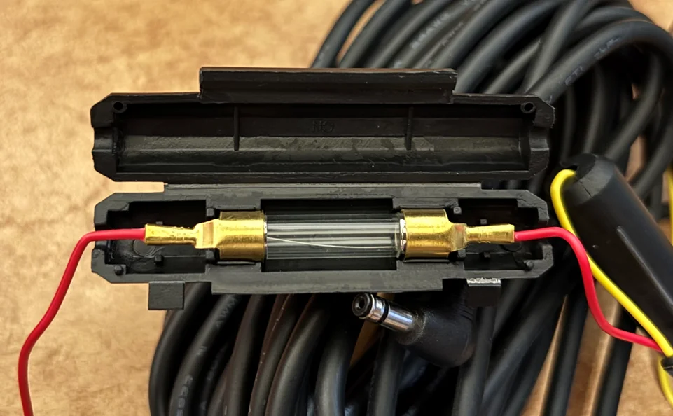

When the B-130X is receiving charging power, you should check the two inline fuses in the BlackVue DR970X 3-wire hardwire cable. You can use a test light or a multimeter to see if there is 12V [voltage value will vary depending on B-130X charge state] power on the end of the fuse furthest away from the B-130X. The ground for your test light or multimeter should be the GND from B-130X should the GND wire in the 3-wire cable. The red wire [labeled "ACC(+)"] is the wire the sends the ACC power to the DR970X which is used to let the DR970X know when to immediately enter/exit parking mode. If there is no power on the far end of the fuse in the red wire, then check for power on the other end [end nearest the B-130X]. If there is power on the end closest to the B-130X and no power on the other end of the fuse, then you have a blown fuse. You should replace the fuse if it is blown. I've never had one of these fuses blow, but if a short-to-ground condition exists along the path it takes to the dash camera, that could explain the fuse being blown. Not likely, but possible.
If the fuses are not blown, but there is still no power on the red "ACC(+)" wire with the vehicle on and the battery pack charging, either the cable connection to the B-130X is bad or the B-130X is not providing the necessary power to the red wire in the 3-wire hardwiring cable. You could press on the plastic tab on the connector that plugs into the B-130X to release it and remove the cable from the B-130X. With the cable removed from the B-130X, you could use a test light or multimeter to see if 12V power is present on the two left most pins inside of the B-130X cable connector. The ground for your test light or multimeter should be the third from the left pin which is the "ground" for these circuits. The left pin is the "BATT(+)" [or constant power] pin. There should always be 12V present on that pin as long as the B-130X has a charge and it turned on. The second from the left pin is the "ACC(+)" accessory power pin that should provide power to the red wire in the 3-wire harness. Whenever there is charging power being provided to the B-130X, that second from the left pin should have 12V power.
