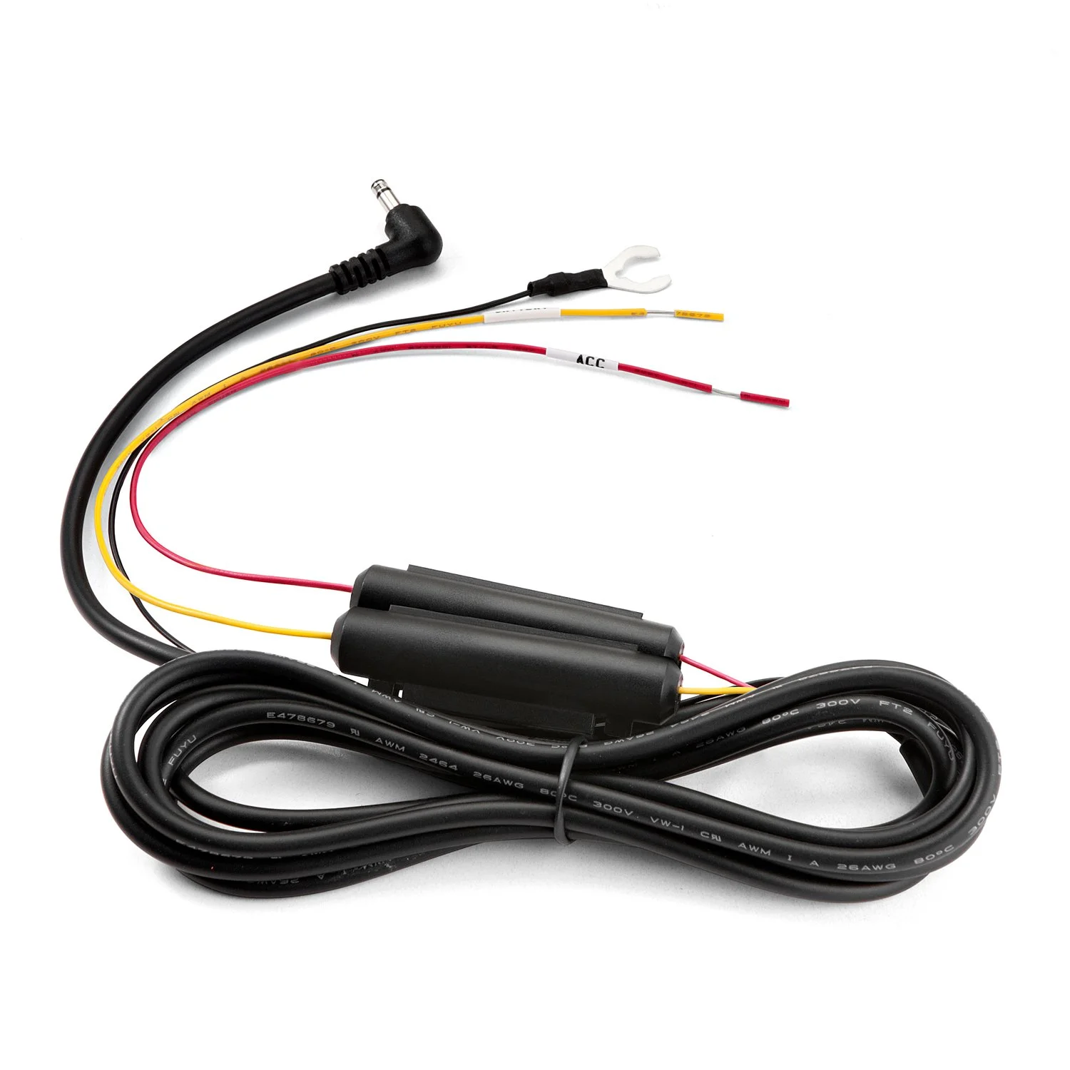

Does anyone know if we can use the blackvue power magic ultra battery pack with thinkware f88 pro dash cams?
I noticed Cellink Neo has the option to order a kit for thinkware dash cams ( spliced cables ) but Blackvue doesn't
The splice cable is required for parking mode to work properly with thinkware cameras. This is because Thinkware cameras turns on parking mode when power on the ACC+ cable has been cut (It works similarly as the heated seats being turned off when you turn your engine off.
The Blackview camera enters into parking mode when it detects no vibration after a certain amount of time instead of requiring a special parking mode wire. Because of this feature, it does not require a separate parking mode and any battery pack that can provide a constant 12V power source for extended amount of time will work with the Blackview cameras.
Found the answer to my question.
Much thanks and patience from @Vortex Radar and @BlackboxMyCar !!
if anyone else is curious, no Thinkware dash cams isnt compatible with Blackvue power magic ultra and will need the 3 wire power cable in order for the parking mode to work properly for Thinkware dash cams
and incase people are wondering why i would use the blackvue power magic ultra and not Cellink neo is well, I got an amazing deal on the blackvue power magic ultra so I wanted to find a way to make it work
This statement is worded incorrectly and makes it seem like you can't use a Thinkware dashcam and the Blackvue B-124. I want to set the record straight here since there's not a lot of information about this battery. The B-124 is capable of sending an ACC signal that the Thinkware (or any other camera that requires an ACC) needs to go into parking mode. It however does not come with this cable from the factory and you will have to order it separately (BlackBoxMyCar has the cable) or make your own by modifying the cigarette output cable by adding a third pin and wire.

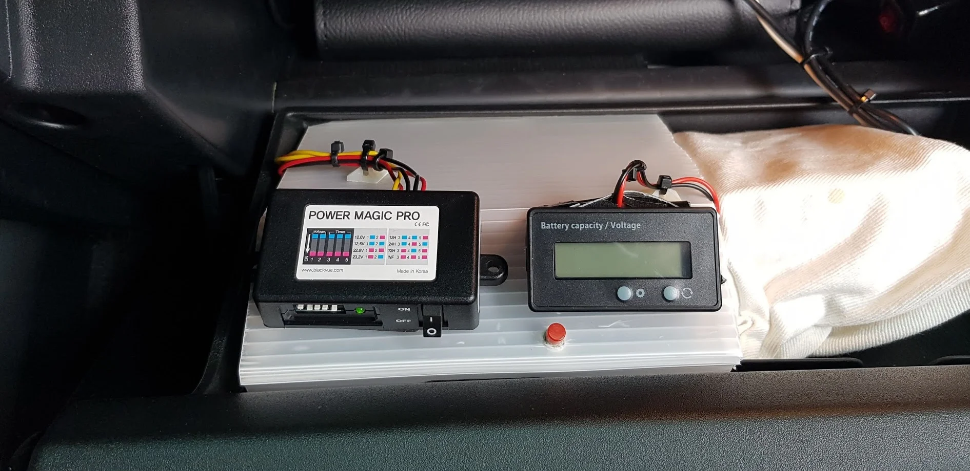

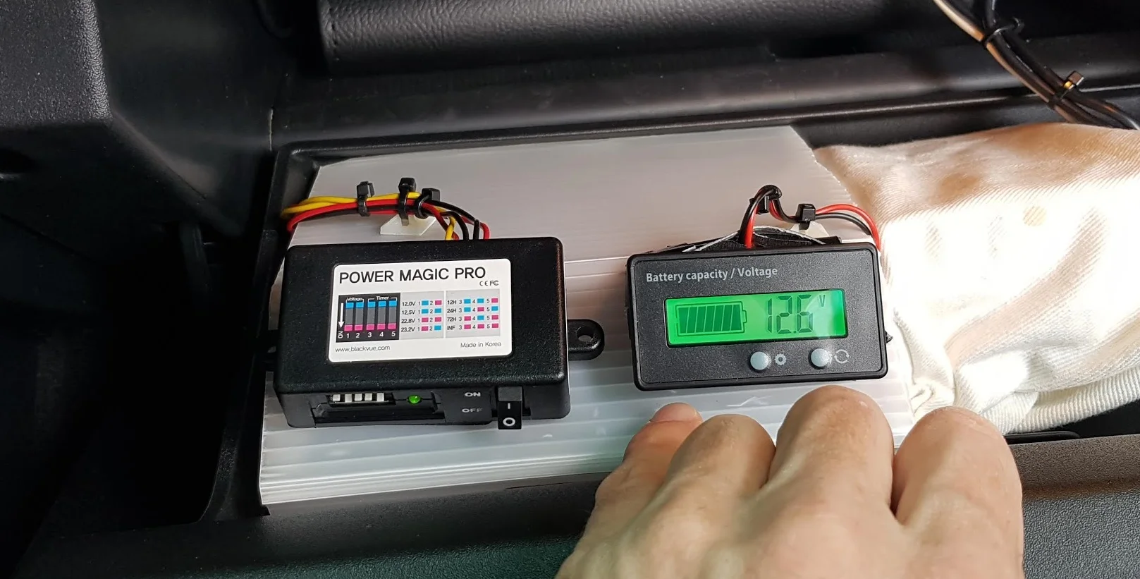

I found out that the internal voltage cut-off of the F800 pro is not accurate, I have decide not to risk my car battery as I'm using parking mode for many hours every day.
I was able to connect the Power Magic and external digital voltmeter inside the Glove Box.
Its working with no issue with the F800 Pro. I have set it to cut-off of 12V/12 hours.
With the digital voltmeter I'm able monitor my battery health every day and look for negative trend.
Where did you get this information? I would like to know more about this.
Might be that my unit is faulty. I've got unstable voltage readings between 11.5V to 12.2V during parking mode. I verified with external Multimeter that this issue is related to the camera readings only and my car battery is just fine.
