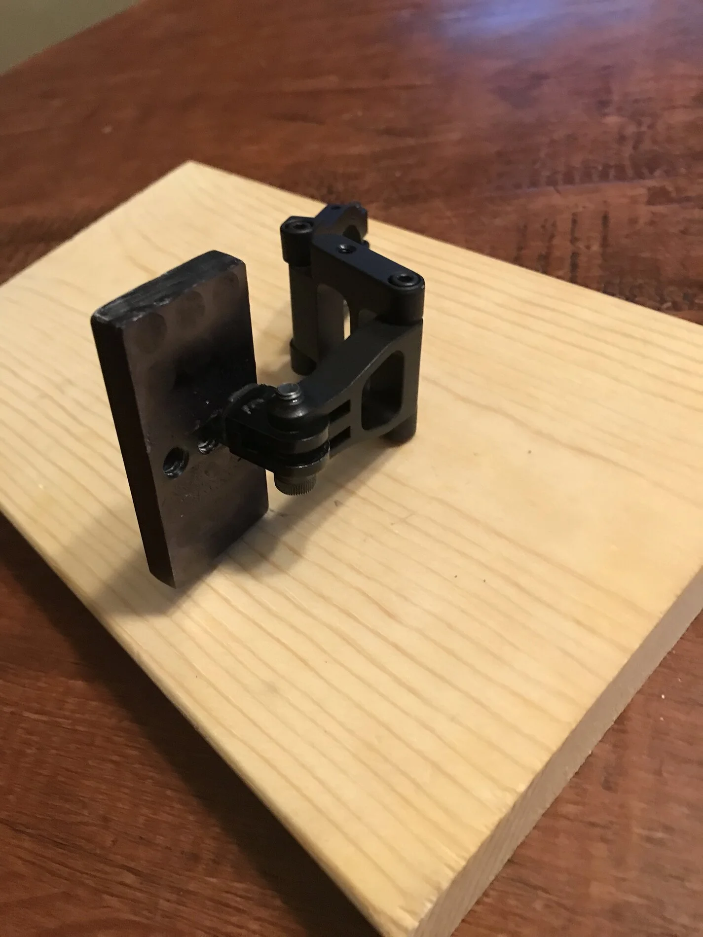

I did the windshield mount on my wife’s Honda. For various reasons I wanted to use the BlendMount mirror mount on my truck. BlendMount doesn’t make mounts for the Viofo cameras. They do make mounts for the GoPro.

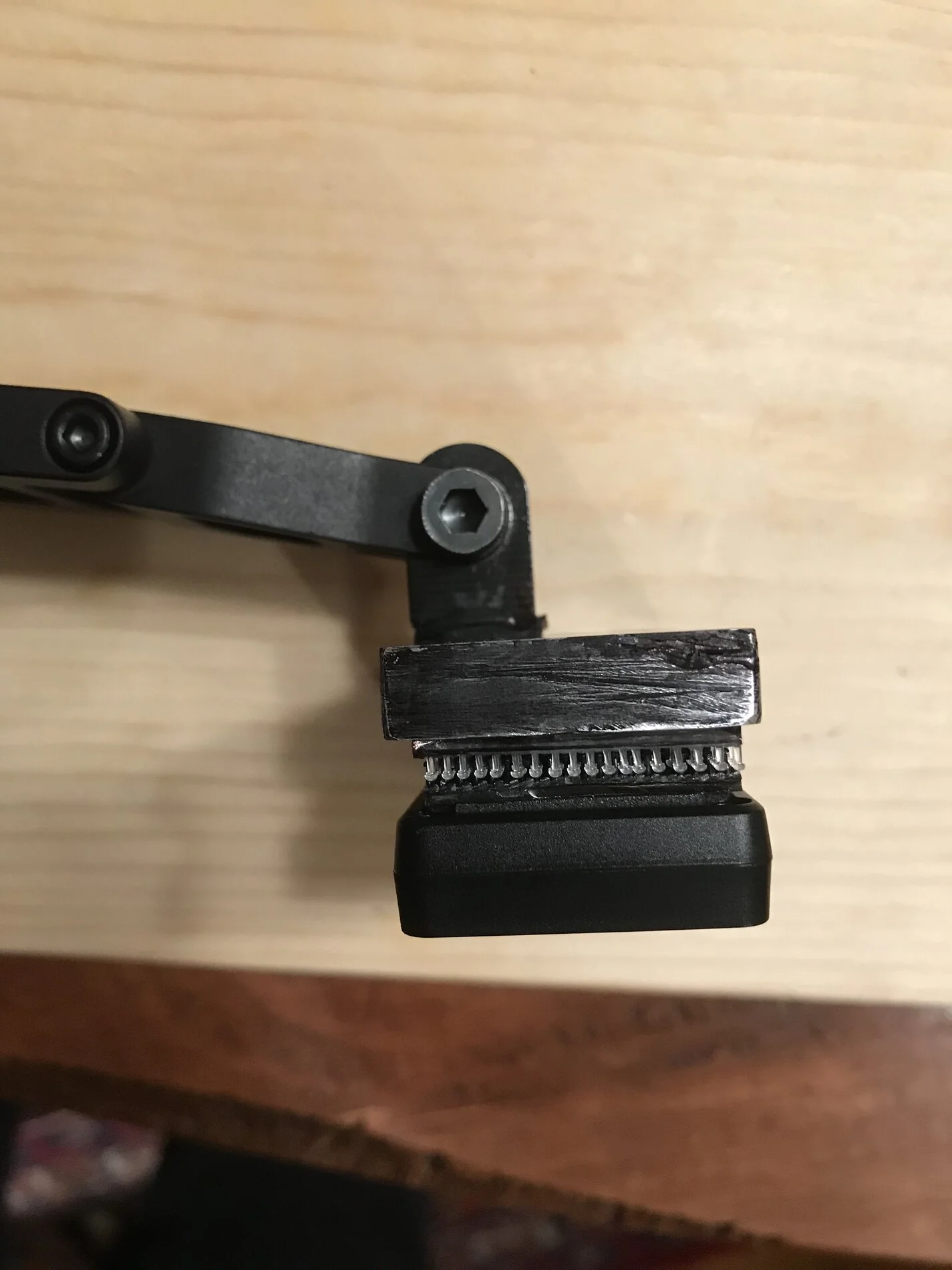

I used some 1/8” aluminum 1” x 2”, a 1/4” x 20 GoPro camera adapter, and some 3M double sided tape. After I cut my aluminum, I drilled and tapped it for the GoPro adapter, and then attached the Viofo GPS module with the two sided tape. I haven’t painted it yet but it turned out ok.

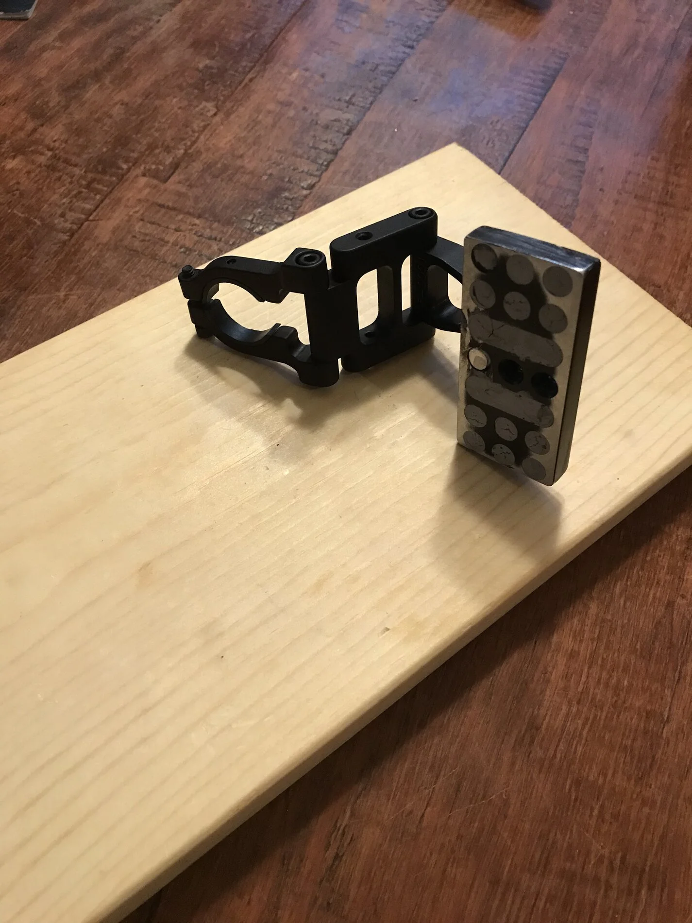

The second pic is my first attempt where I wanted the ability to separate the GPS module from the attachment plate using 3M Dual Lock tape. I used a photography cheese plate as a base. The thickness of the cheese plate combined with the thickness of the Dual Lock made the whole mount look too bulky.

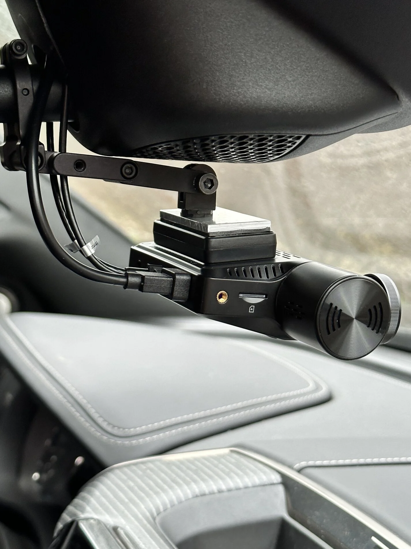

Yep, the potential for vibration is always brought up when using mirror mounts for cameras. My first thought is that any vibration would probably show itself in my rear view mirror. Which I have no vibration at all. My second thought was of the camera hanging out at the end of the mount. The long moment arm with the camera hanging off the end certainly makes one wonder. But, to that point, the BlendMount is literally rock solid. From where the mount attaches to the mirror arm, the joints of each section of the mount, and the attachment of the camera to the mount. Nothing budges. That being said, I do like Dashmellow’s idea of the Dual Lock for added stability/support. At $45 for a one sided 10’ roll of Dual Lock, I need to use it for something.
I’ll try to post a video in the future and my overall satisfaction with the mount. By the way, the reason I went this route was because that huge growth in the center of my windshield that houses the mirror, speaker, sensors, and who knows what else. Well, that blocked part of the cameras picture. If I mounted below the windshield console, I end up with a large part of the windshield being blocked.

Thanks for the zip tie suggestion. Regarding 3M double sided tape and 3M Dual Lock fastener tape. The double sided 3M 5952 tape is the same product Viofo uses with their camera kits. It’s rated to 250*F. The reusable Dual Lock is rated to 200* - 220*F.
Your point about the speaker and reduced surface area is well taken. The first version of the mod that I did, I was concerned about that with all the holes in the cheese plate. I ended up filling all but the center holes with liquid metal epoxy in order to increase the surface area. In hindsight, had I stuck with the original mod, it wasn’t necessary to fill the holes. After removing the GPS module from the Viofo clear plastic windshield mount. And then removing the double sided tape from the module itself. Let me tell you, that stuff sticks like stink on s%*t.
The same holds true with the Dual Lock. Although it’s temperature rating is slightly lower than the double sided tape, it’s also difficult to remove. On my wife’s car, before installing her windshield mount, I had to move her E-ZPass transponder. It was held in place with two small strips of 250 Dual Lock. I was able to remove the strips, with a little effort, and reuse them to relocate the transponder. They seemed to stick to the new location like they were new. However, the Dual Lock had been in place for 7 years. Very good stuff.
