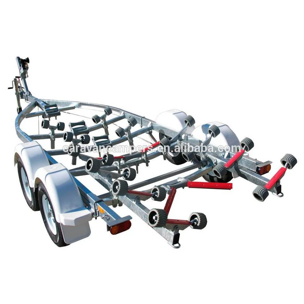

The trailer on the first boat my family had wheels HTB1V1wEQXXXXXbzXVXXq6xXFXXXy.webp
The one in the video is what I would kind of plank typeboat-trailer-klassic-kkb-1800-70-bt-400x400.webp
I can't see some plank type trailer (not sure what the correct term is) as being that stable or offer much security during transit.
Perhaps "Transom tie downs" would have made a difference, but looking a google images, few trailers have them. The boat that fell of the trailer doesn't.

UK doesn't seem to have any boat specific regulations for trailers. It does appear that to stop the boat sliding forward under heavy braking, it should be held:
  1. At the front by the winch cable, which should be locked tight by the winch brake.
  2. At the rear by one transom tie down either side which will prevent the boat moving forward and keep it pointing straight ahead.
  3. For backup by the safety chain, which should prevent the boat setting off on its own journey separate from the trailer.
Even if there is no specific law, you are still responsible for safety, and you should follow the normal best practice/guidelines.
