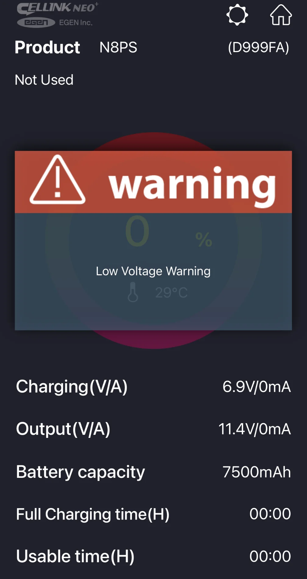

They didn’t address the issue of the battery not charging (see attached image). I think because there was always a voltage reading when the car was running that they assumed it was charging the battery pack (although the 0 mA suggested to me that it’s not doing anything at all). The red and green lights on the external battery flash with the engine on. The low voltage message is also concerning.
Unfortunately I wasn’t there in person to ask more questions. Just wondering if anyone here can assist me in figuring out what might be wrong? Thanks!

The battery pack's charging system monitor [BMS] won't allow the battery pack to be charged unless there's a minimum voltage level of v12.x volts. Your screenshot shows an input voltage level of 6.9V which suggests there's a wiring problem causing the reduced charging voltage or the location where they're sourcing the charging power is not providing sufficient voltage.

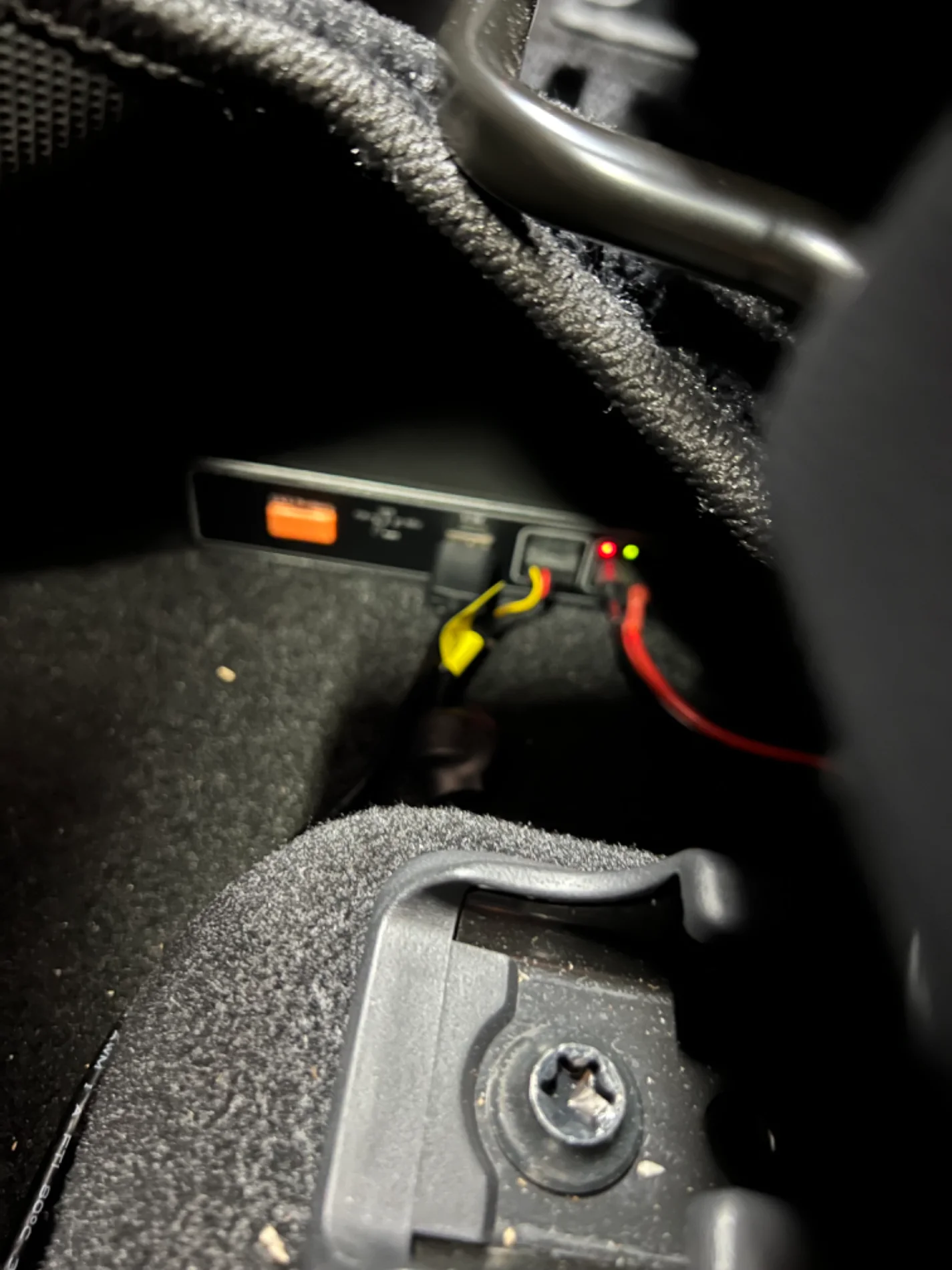

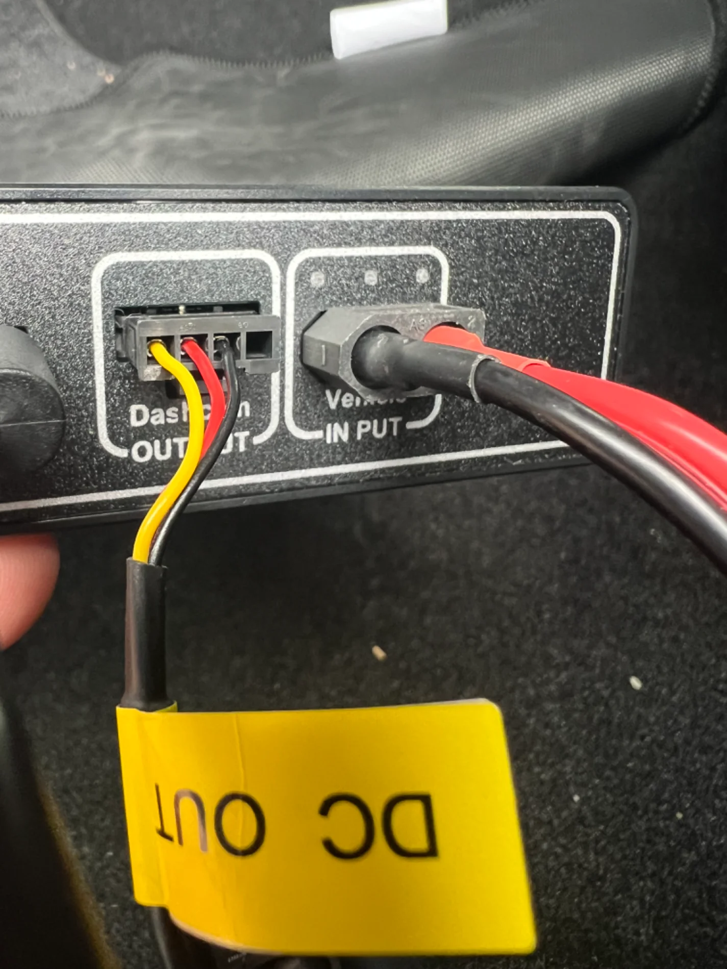

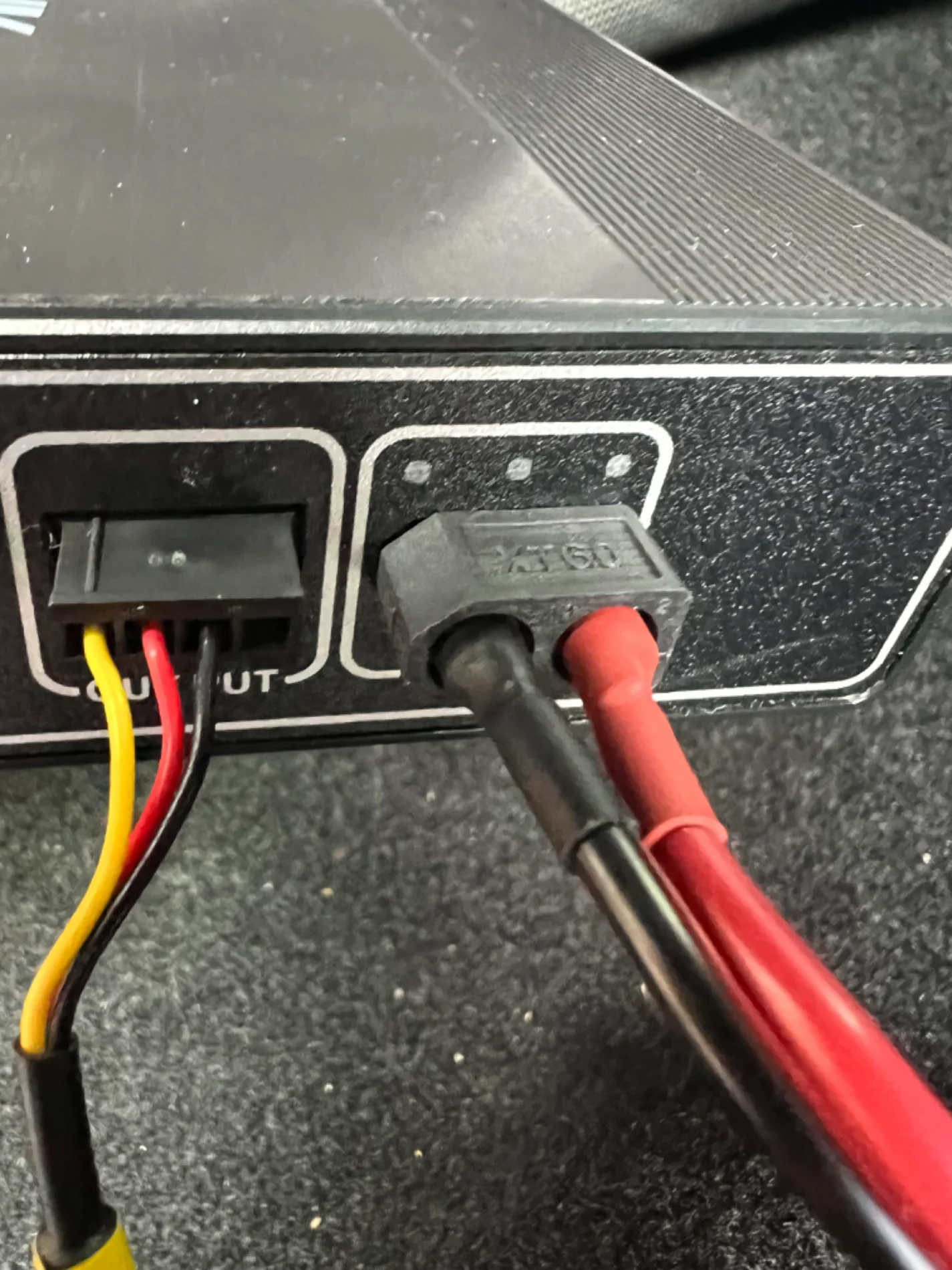

Thank you for your help! I’ve attached clearer photos of the external battery and its attachments.
I’ll get back to the mechanic about checking the colour combination of the cables for the dash cam, as well as checking the source of the external battery power (ensuring that there’s sufficient voltage and it only charges when the car is running).

The new pictures show what I would expect for those cables plugging into the battery pack. For the charging power issue, I would have the mechanic check both of the wires in the charging cable for good connectivity. The ground [black] wire could be connected to a poor ground location [might not have a clean metal surface - for example paint is preventing a good connection].
