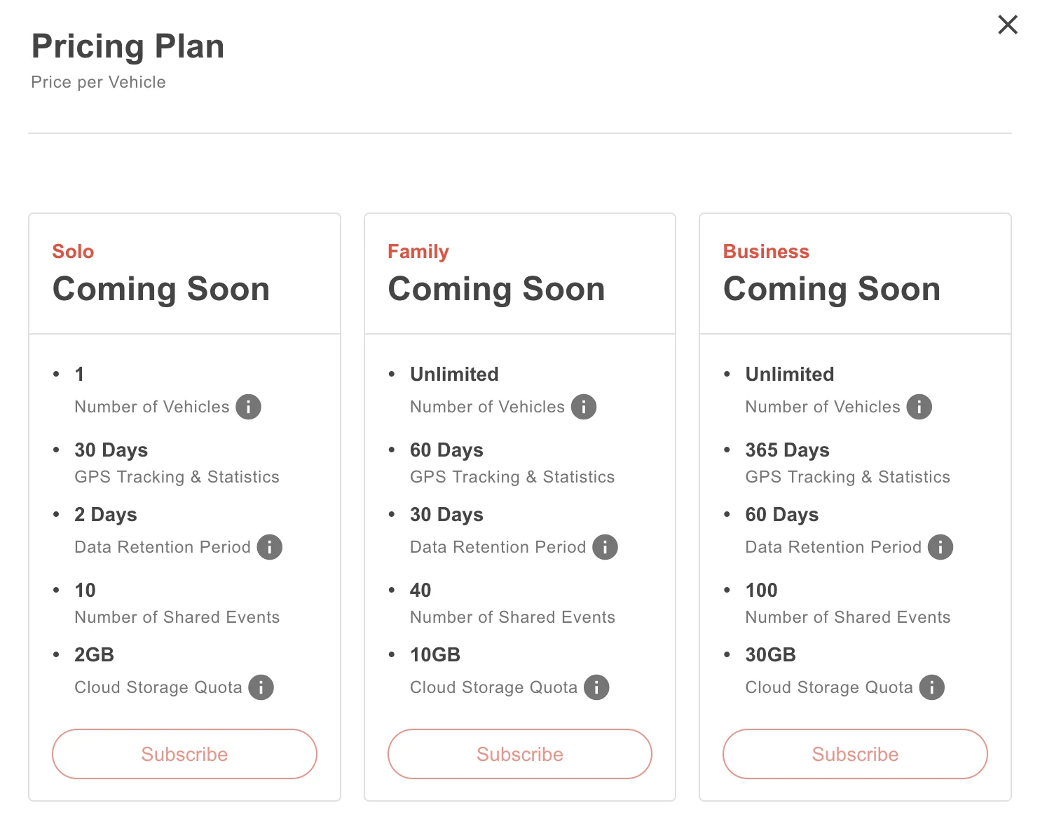

Do you know what the live feed access time limit on withCLOUD? Like how many free mins per day or per month with free plan?
I did not see public info on time limits, but that may come when they release plan pricing and full list of features. Only info I could find on it is seen above in the screenshot. Would recommend reaching out to Gnet if you need detailed info.

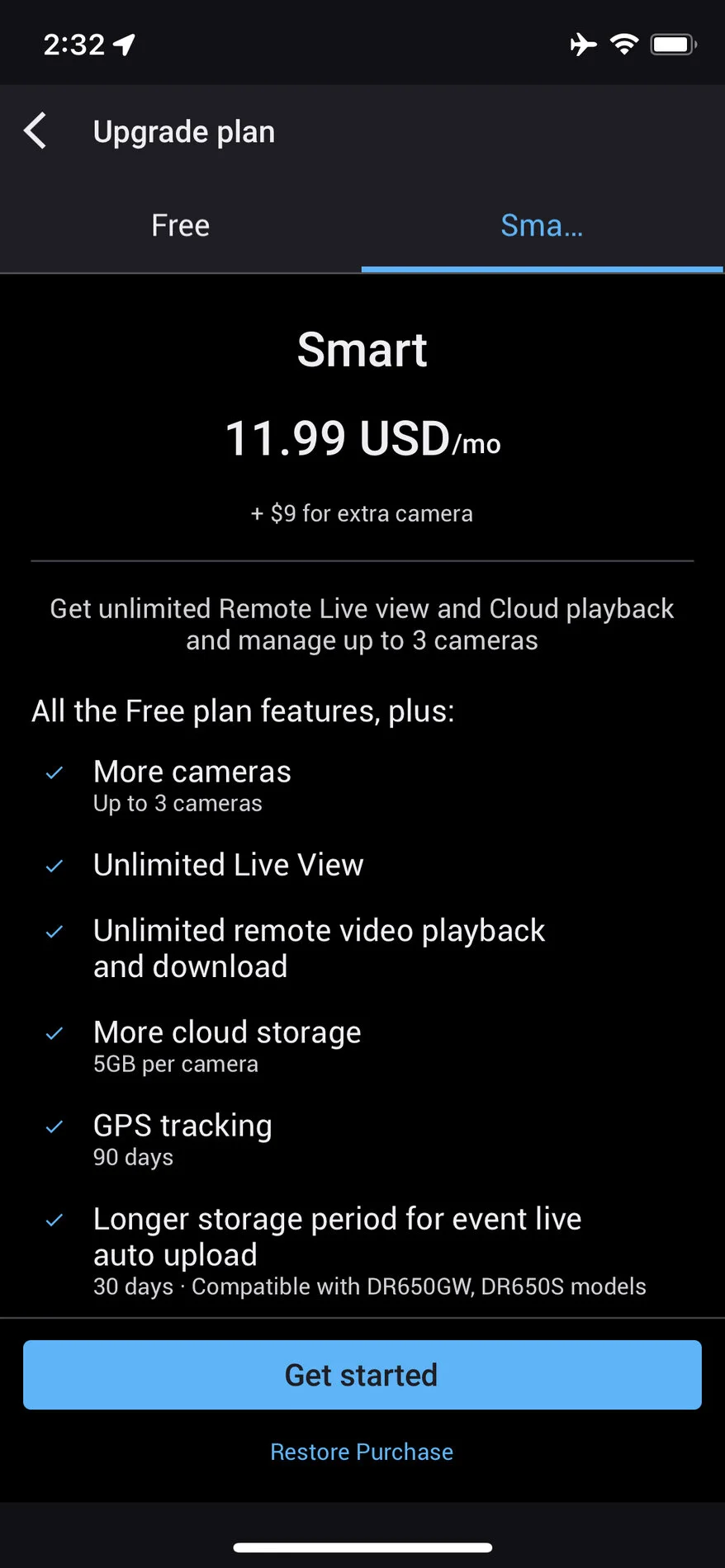

BLACKVUE CLOUD
Camera used: DR900X-2CH
Setup is fairly straightforward. Please note we are using the “free” plan which allows live view, live GPS location, remote footage access and impact notifications. Overall opinion is that getting connected is a bit tedious as it requires entering a lot of info if the cam does not want to quick connect, but once it's connected and set up the cloud worked reliably and the app ran well. Some confusion with overall app layout. Two examples of app layout confusion include having to back all the way out of the app to view saved footage, and most of the way out to change camera settings, but learning curve was overall not that high for someone who already has used the basic BV app.

  • Free plan live view limitations

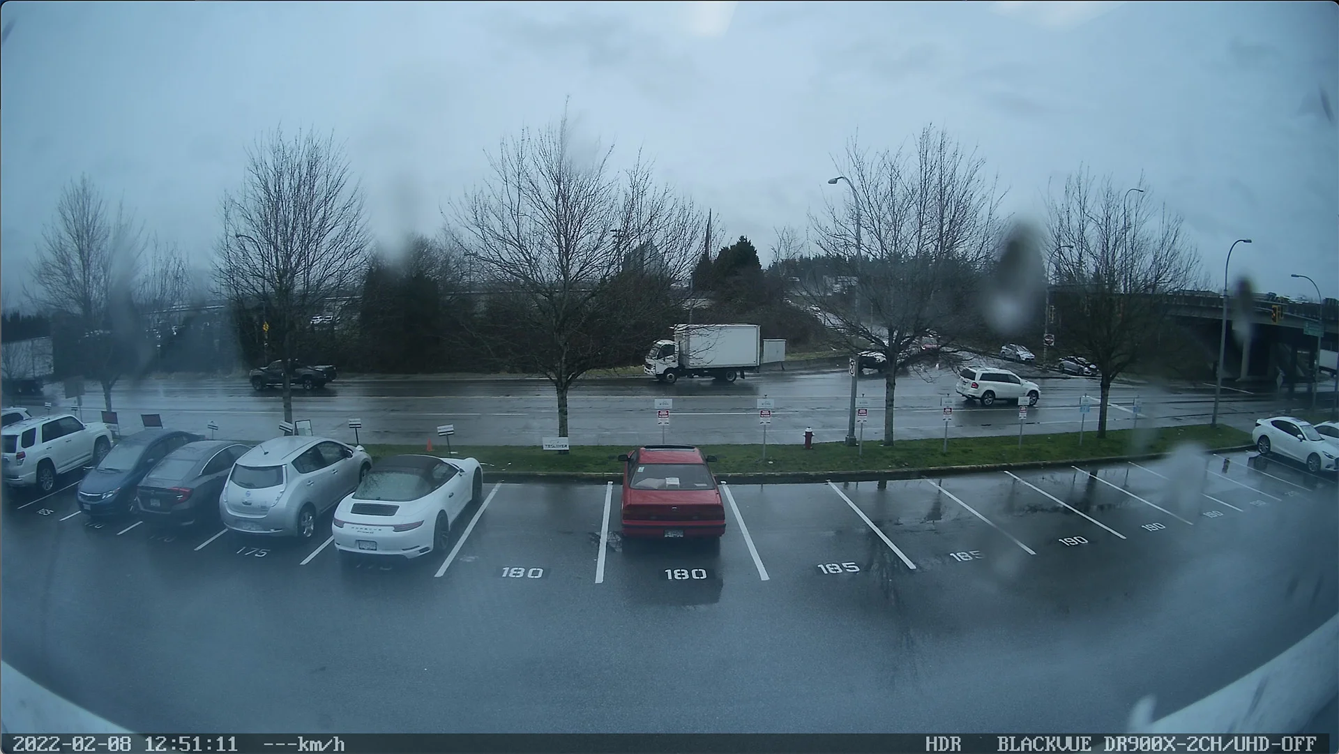

  • ORIGINAL QUALITY CLOUD DOWNLOAD
    • 193MB file size for 1 min of video
    • 3840 x 2160 resolution
    • 28 FPS (???)
    • HEVC
    • 25Mb/s approx

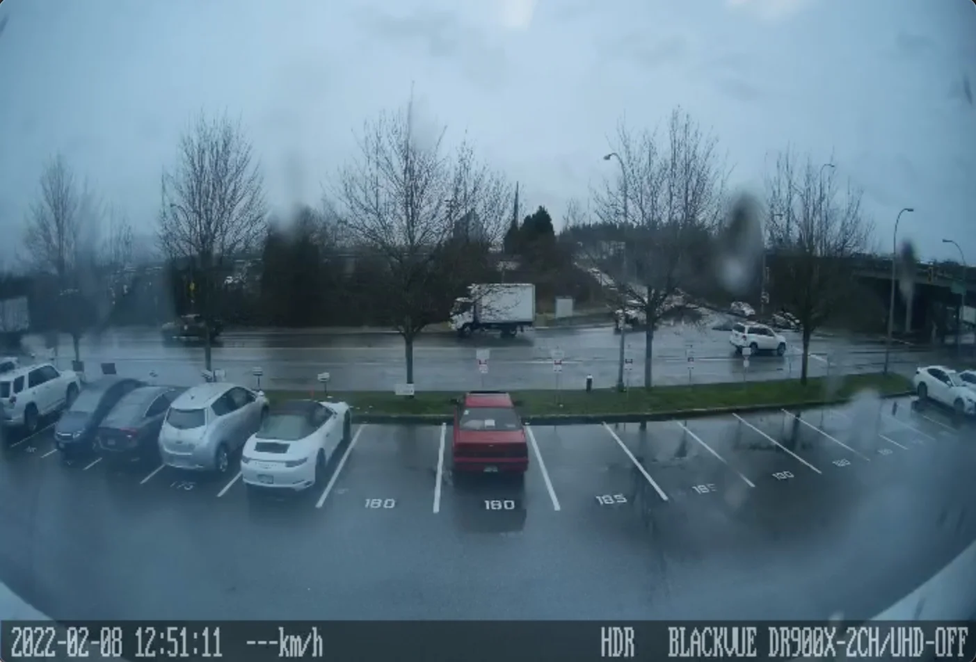

  • AUTO INCIDENT UPLOAD
    • 4MB file size for 1min of video
    • 704 x 480 resolution
    • 10 FPS
    • H264
    • 450kb/s approx
That isn't even 16:9 aspect ratio! Does it chop the sides off, or squash the image, or add black bars at the top and bottom?
It is actually NTSC analog TV resolution, why on earth would you use that in the internet cloud age?
Sorry I've just been testing these from the office window so the sample is not great, but here's a comparison screen grab. It appears to be squashed.
The smart camera i get "soon" unlike most others i think, you can wake it up remotely via the 4G modem inside it even if it is in deep sleep and on the radar it also have, at least that is what i am told.
If you can wake it up still, IMO then it cant be in a that deep sleep state, so it can probably not match the extended parking guard times aided by radar on other systems.
From memory this radar putting camera in that deep sleep, have been a shock to some smart camera owners,,,, cuz when it sleep like that,,,,, well it is essential a "dumb" camera while it do so.
Cloud on that particular camera are also free / unlimited.
No need to be sorry, that answers the question perfectly, except for an explanation of why they would want to squash the image, which I wasn't expecting you to know!

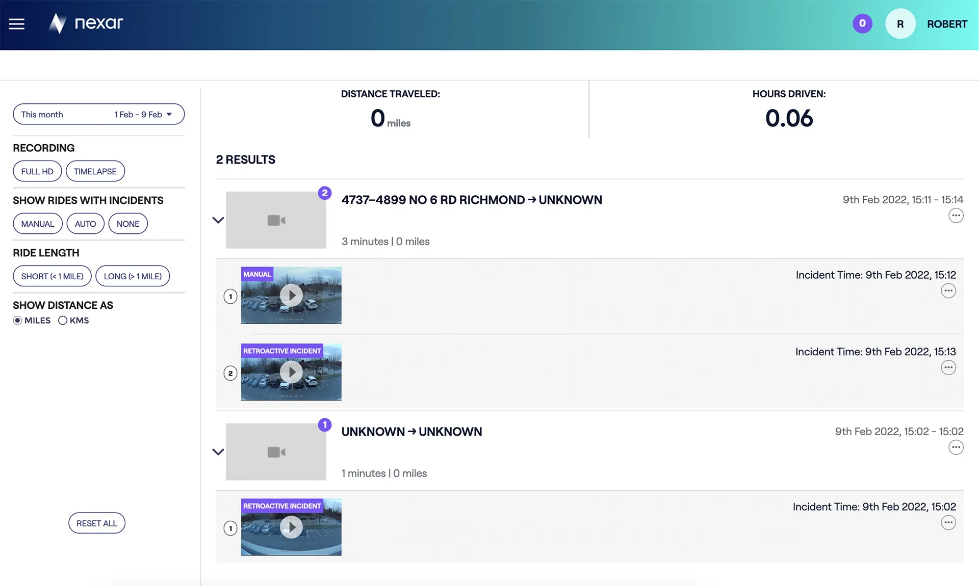

Nexar Cloud
Nexar cloud seems to be primarily focused on backup and sharing of footage. When footage is automatically uploaded to the Nexar cloud, it is available for viewing. Just sign in with the phone number used and a text confirmation.
Some Notes
  • The camera does not directly connect to a wi-fi network and instead relies on the app to transmit video data to the cloud
  • These clips are created automatically (by impact / g-sensor) or manually (by user)
  • Full drives are uploaded to the cloud as time-lapses
  • Video is stored for 60 days
  • It’s hard to tell on the Nexar app what footage has been uploaded to the cloud as there does not seem to be any indication that is it uploading
  • The process of connecting to the camera was very user friendly.
  • They also put an ad in the corner of their cloud video for GetNexar
Cloud Download Specs
  • 5.9MB for 25 seconds
  • 1280x720
  • 29 FPS
  • 1,980 kb/s
  • AVC
