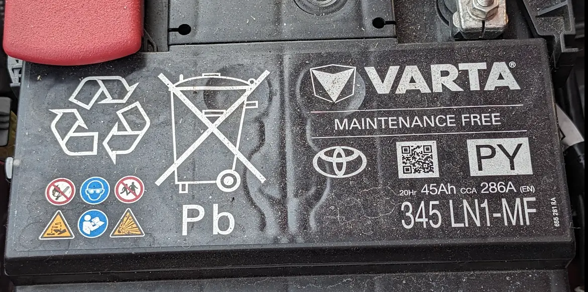

I drive a hybrid car with a small 45Ah 12V battery. I'm trying to decide between hardwiring to the car battery, or to a dashcam battery.

I think 12.2 volts are generally seen as a 50 % depleted lead acid battery, and should be safe in regard to too low discharge, it is what i have always used ( also 45 Ah battery but upgraded to 50 Ah one a few years ago )
Depends on the chemistry of the 12V battery, and on if it is recharged from the traction battery.
Some hybrids use conventional lead acid, which wants a 12.2V cutoff, as kamkar suggests.
Some use AGM batteries, because of longer life time, and less self-discharge, which is important for a small battery, and that wants 11.8V cutoff. If you have a conventional lead acid, then you may be able to replace it with an AGM for better performance and faster recharge.
Some newer models use lithium 12V batteries, which is probably best with 11.8V, although 11.6V won't do any damage, just means that you can't leave the car unused for weeks because there wont be much left for the alarm system etc.
I don't think many charge the 12V from the traction battery while parked, unlike many EVs, but they will charge it from the traction battery while driving, even if stopped at the lights with the engine stopped, so you should get a decent recharge on every drive.

Thanks for the advice. Looks like lead acid, so 12.2V then.
It is not recharged from the traction battery when parked, but it is recharged if the ignition is on.
Yes, if you are going to leave it unused for a week or two then it may be semsible to set it a bit higher, or turn the camera off.
I think you could quite easily find an AGM replacement in the same size, which would charge faster, and be happy with a deeper discharge to 11.8V , and have probably double the life span.
