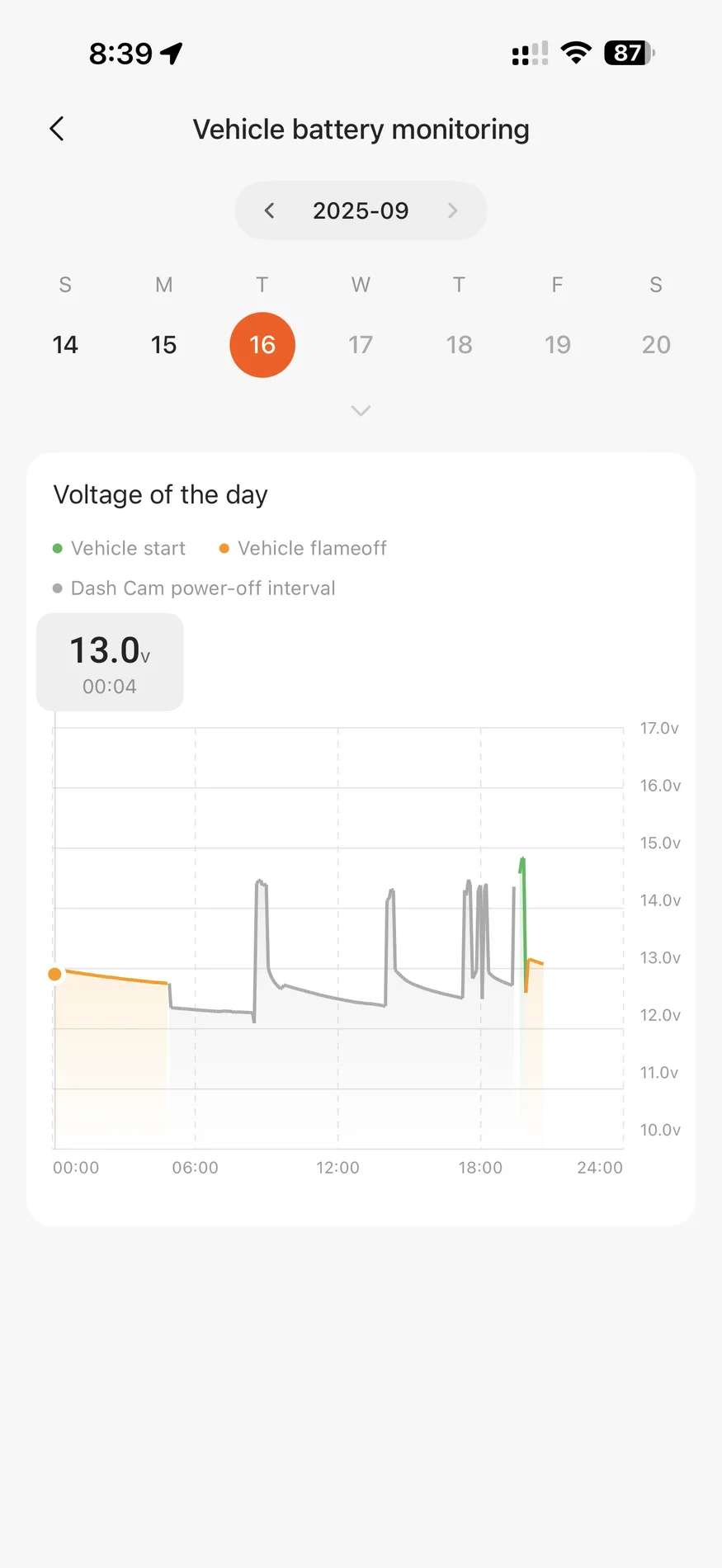

Here's a picture of the graph showing what I'm talking about with the battery voltage. Where it turns green again around 19:00 is when I unplugged and replugged the USB C then factory reset.
You can also see the night before it completely turned off around 3-4AM (the car was only turned off the night before at 11PM, so again nowhere near 24 hours).
The spikes in the gray inbetween were actual starts and running of the car, which should have been green.
