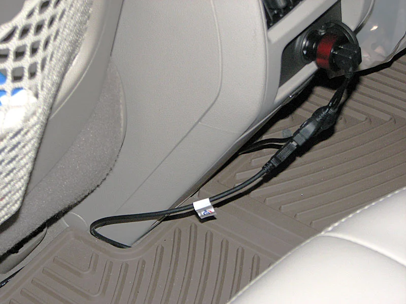

No, I did not. It was just a matter of determining where on the rear hatch I wanted the camera and affixing the mounting plate. From there I just tucked the wiring (power and GPS) behind headliners/molding/carpet/etc. until I got to the power source. I did have to leave a fair bit of power cable visible to allow the hatch to open. The specific routing will obviously be different for every vehicle. I have a 12V accessory outlet in the rear passenger area that I used to power both front and rear cameras using a dual outlet USB adapter/converter.
This is how the wiring ended up using a couple of 90 degree USB connectors. (The rear seat in my vehicle is seldom used and when it is it's by adults so I'm not too concerned about the location of the wires. If necessary I could hide them away better than this but have no real need to.) I like this because from the front passenger area you can't see anything except the GPS antenna and the wires as they exit the headliner and go into the camera - and most of that is hidden behind the mirror.
This is the USB adapter I use to power both cameras:
