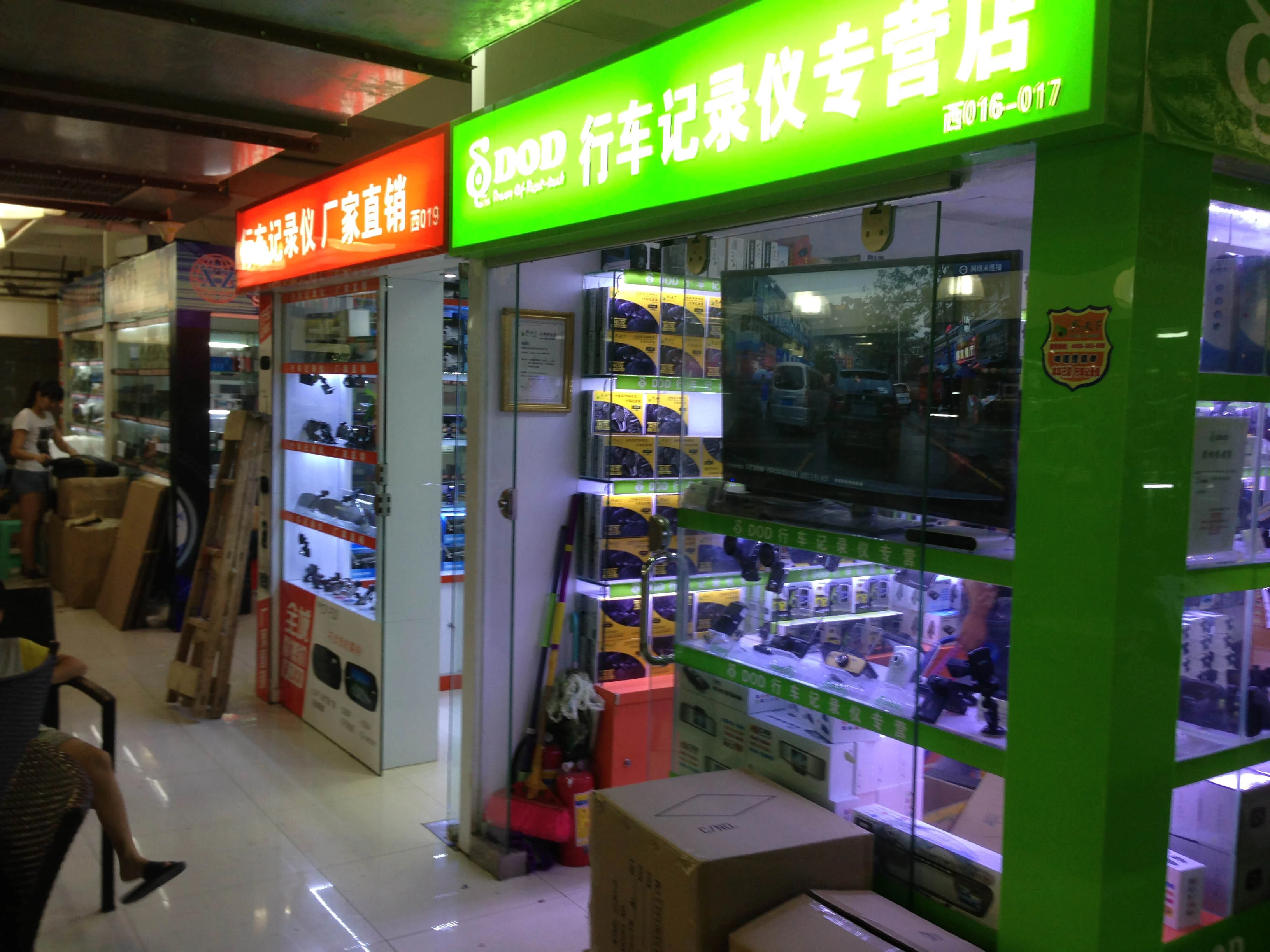

Might just be the Chinese domestic market version, firmware is not always the same, could be from the DOD shop in HuaQiang
