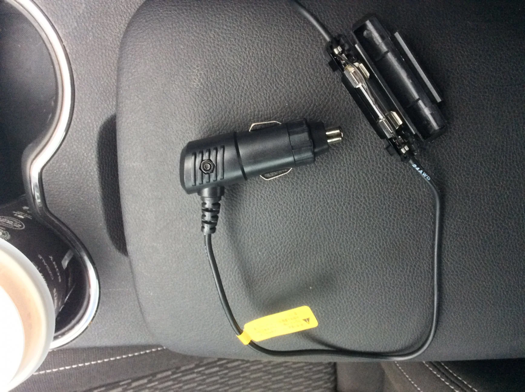

Hi there,
Have installed the dr650 2ch, connected via the vico-vation power plus. Am not seeing any power getting to the cameras, but the power supply seems to check ok. Have tested voltage at the fuse (small black part just after the cig plug) of dr650 power supply. Shows 11.5v in, but only 8-8.5v out. Once I plug in front camera the voltage drops down to around 3-3.5v. Camera just doesn't seem to want to power up?
Hoping someone can help!
Thanks 🙂

Correct. I tested voltage on either side of the small fuse, which is located approx. 30cm from the adaptor.
