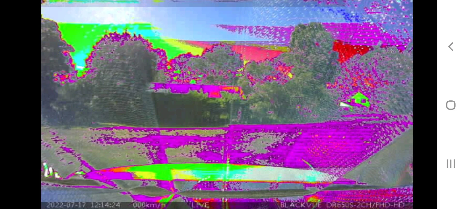

vk4akp New Member Joined Jul 11, 2022 Messages 6 Reaction score 4 Location Ipswich 4305 Country Australia Dash Cam Blackvue DR650S Jul 16, 2022 #1 Hi, I now get rainbow video after a firmware update. Both front and rear cams. Worse in bright light. Also only recording in parking mode. Attachments Screenshot_20220717-121426.jpg 240.9 KB · Views: 6

BlackboxMyCar Well-Known Member Retailer Joined May 21, 2014 Messages 1,096 Reaction score 625 Location Vancouver, BC Country Canada Dash Cam Thinkware, BlackVue, VIOFO, FineVu, Nextbase, Vantrue & More Aug 9, 2022 #2 Usually this is indicative of a bad video sensor but, if this happened after a firmware update, contact BlackVue directly to see if you can go on an orlder firmware / other resolutions.

OP OP vk4akp New Member Joined Jul 11, 2022 Messages 6 Reaction score 4 Location Ipswich 4305 Country Australia Dash Cam Blackvue DR650S Aug 9, 2022 #3 Yea they said the same. Tried a roll back. No change. Sending it back. Thanks.
