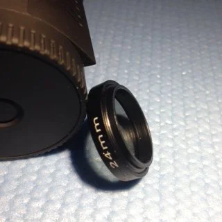

I bought 826 from gearbest.it arrived last night.while i was controlling the package and cpl lens,i dropped the lens.it was magnetic before dropping,now it is not a magnetic.
Was there a magnetic ring or anything like that inside the lens that i couldnt realize?
Sent from my iPad using Tapatalk
Hi,
You may have lost the ferrous ring that is on the inside of the filter. Here is a photo of mine.
Could you please show me yours seperately?i lost it in the kitchen,i have to look everywhere[emoji30]
I am sorry but it does not normally come apart so I cannot show it separated.
It must be a ring like the stepped in section of the photo that I posted.
Oh sorry,thank you so much...
