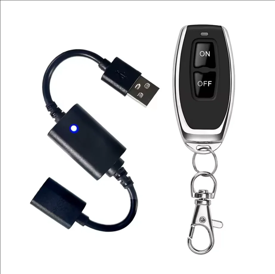

I’m thinking of connecting the HWKIT ACC wire to the EcoFlow’s (or any other power station’s) USB port via this, since I’m already running my USB LTE modem with it. I was also planning to use my security cameras wit it, but it’s much easier to use the Tuya Wi-Fi USB switches for that and they work over internet to.
