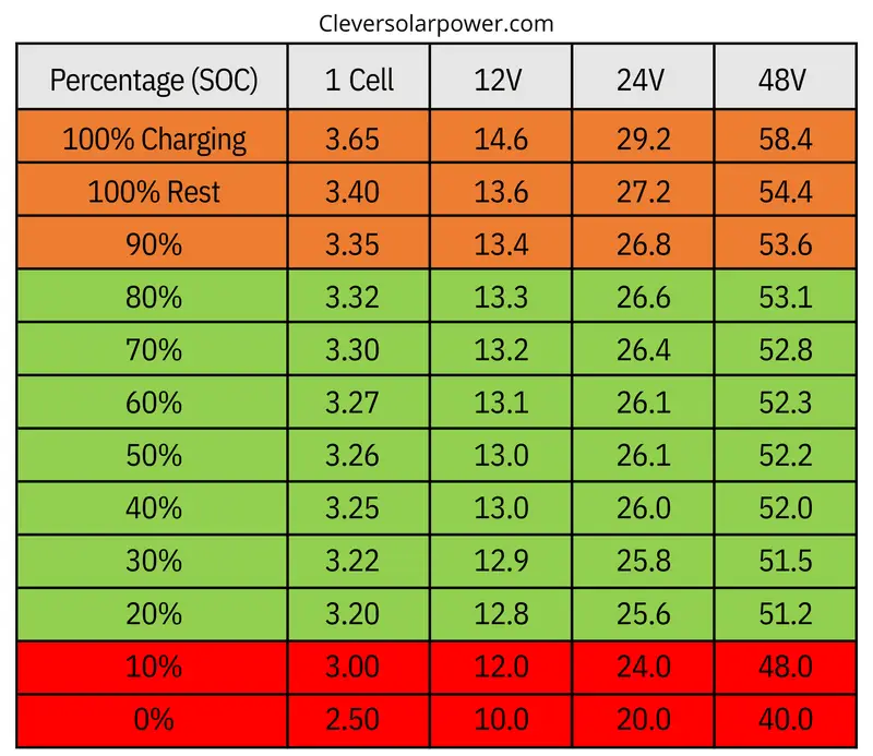

I did a Little more research and on several pages saw charts similar to the one below:
It suggests that actually going below 12V is discharging more than 90%, so 11.8V is near zero charge left. Such depth of discharge may influence the number of cycles.
It May be a good idea to actually increase the viofo cutoff from 11.8 to 12V because I have no idea at what cell voltage the energywell bms shuts down.
I believe that is unnecessary, because your tables are for an unconnected battery, which will have a slightly higher voltage than one under the load of a dashcam, more so when it has reached the 11.8V point.
These LiFePO4 batteries should do well over 1000 cycles before dropping to 80% original capacity anyway, so if you need the extra 10%, it is reasonable to use it, but unless you are normally filling the battery to 100%, it will be pointless to go below 11.8V. If I'm looking at the correct specification, your battery takes 3 hours to fully charge, so you won't often get to 100%?
