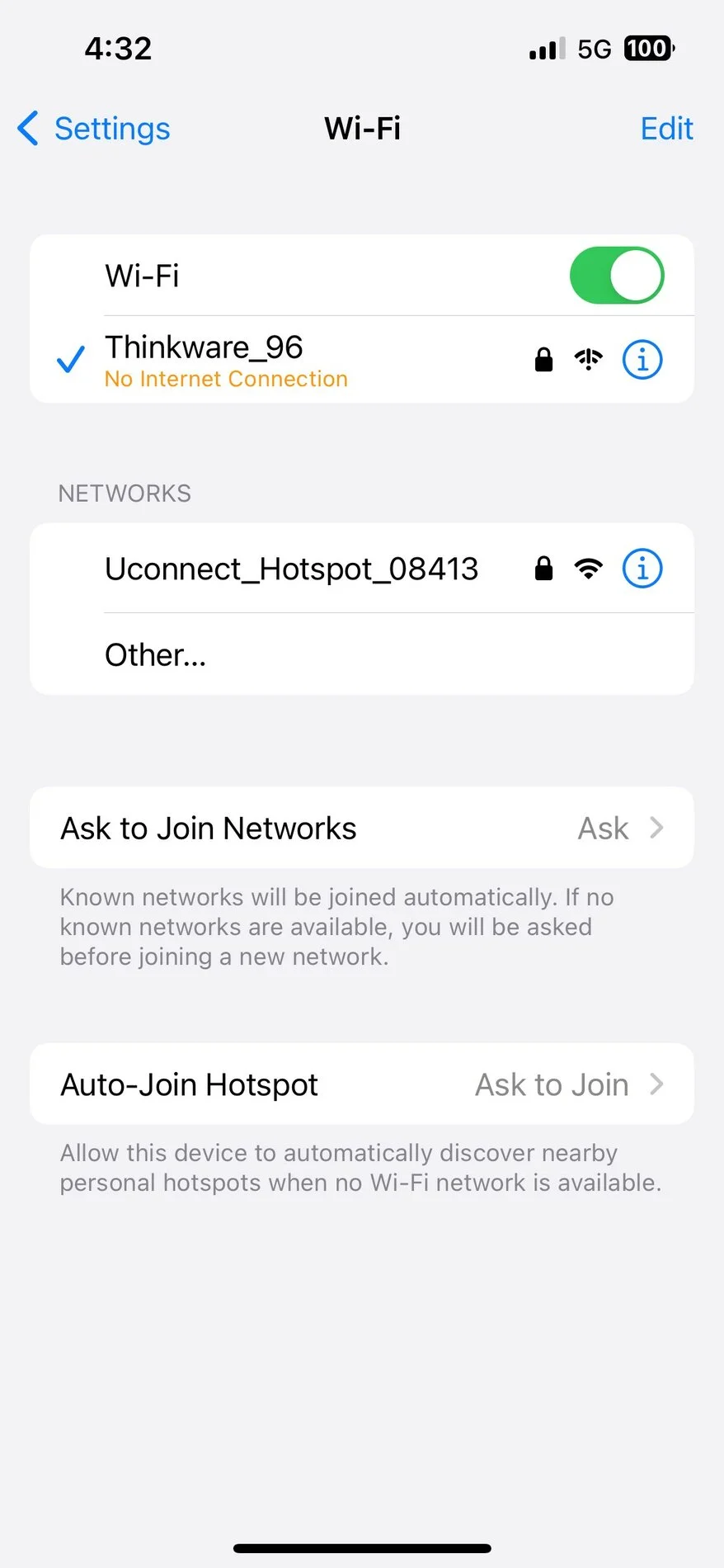

I recently upgraded from an old 6 or SE- they look the same but had both over the years running the Thinkware app and this F800Pro. I can not connect this phone and the app says the F800Pro is not supported. Have deleted and reloaded the app and not able to find an issue. Any help would be greatly appreciated.

Well, that was easy.. I searched the apple store for F800Pro and the correct app came up, noted 'only for F800Pro/.....(and a couple others) and I'm connected again.
