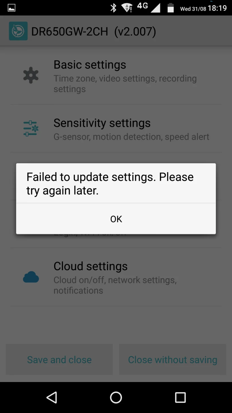

Obviously the app can connect to the Blackvue as I can see all the recordings, etc, I just cannot seem to save any changes at all. When I do, I get the error message. This appears regardless of what settings I try to change (brightness, quality, volume, etc). The error message comes up instantaneously after tapping the "Save and close" button. So it's not as if it's a timeout.

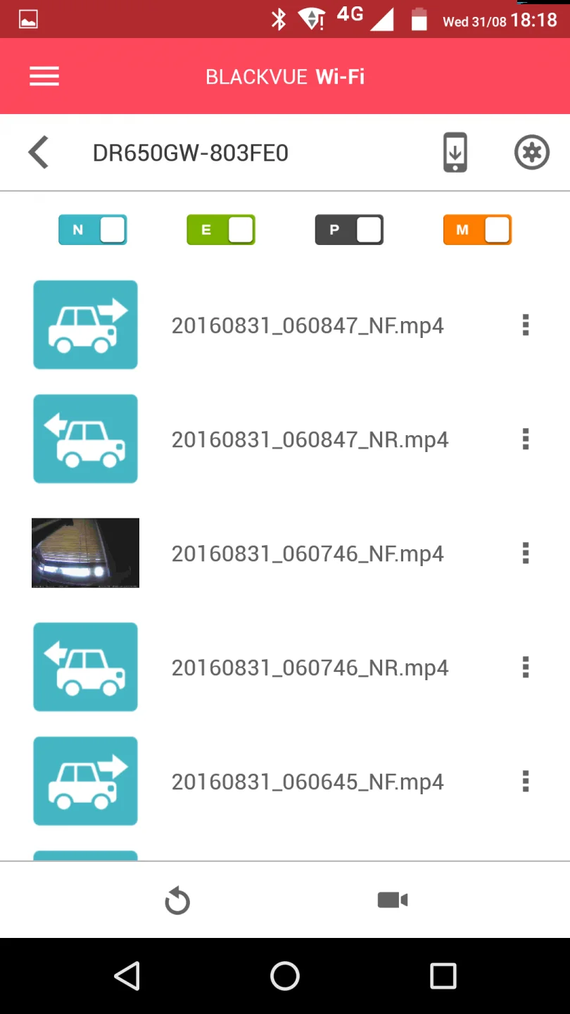

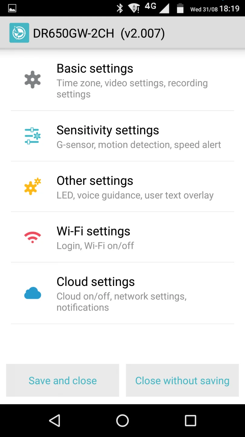

Once at the main screen (1), I tap the config wheel icon top right.

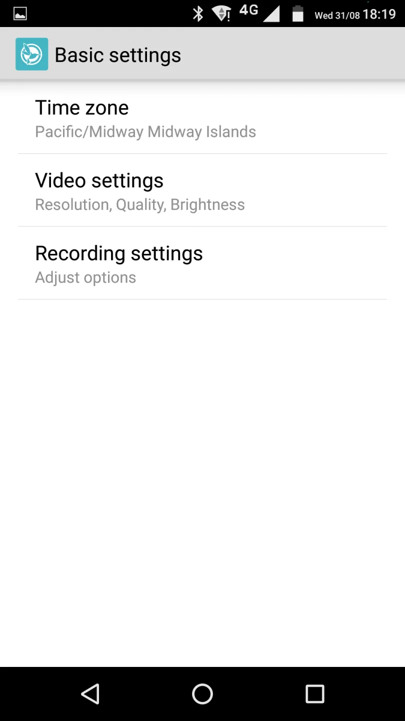

at (2), I select the first one

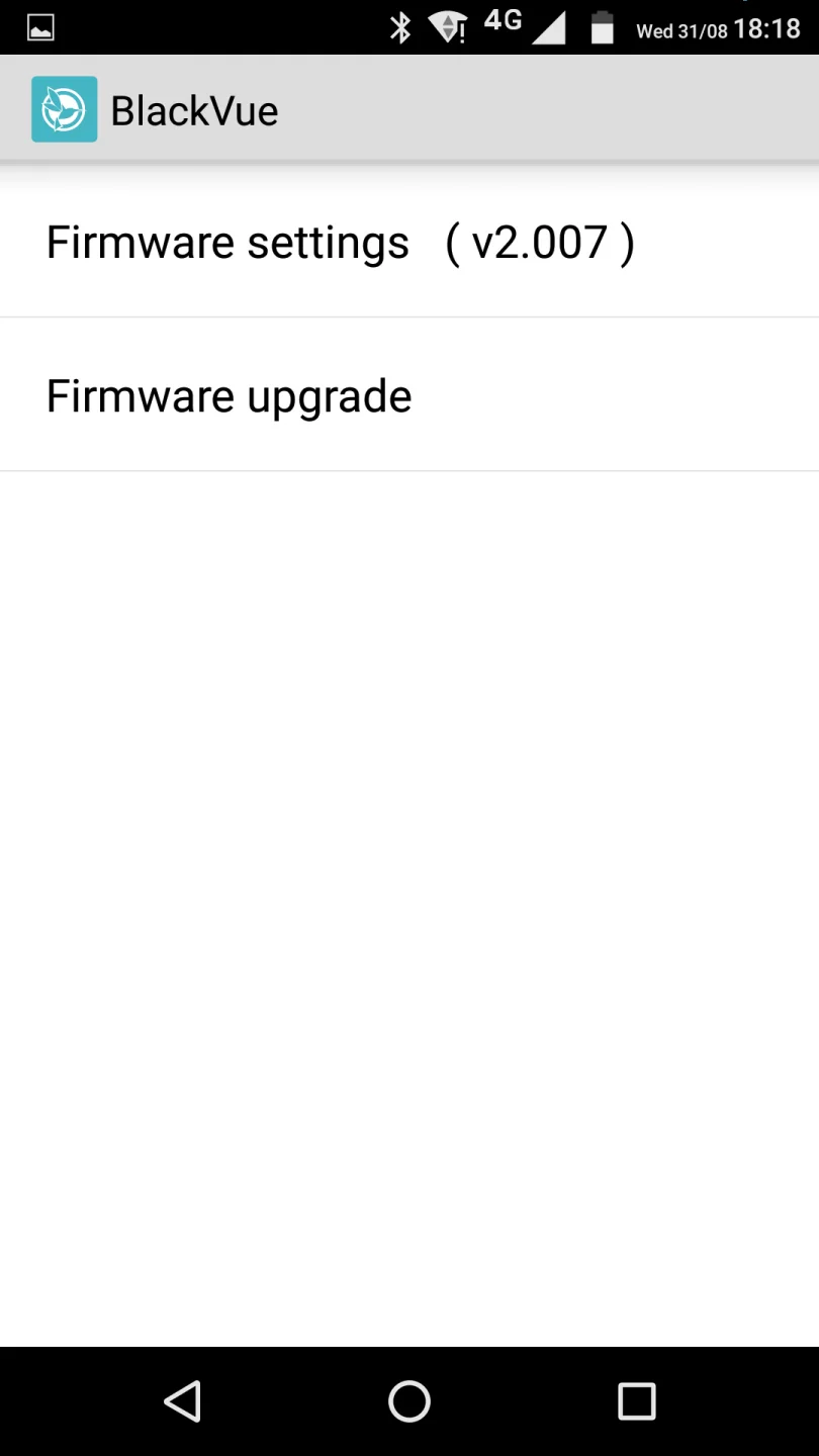

at (3), I then go into any sub-menu which takes me to 4.
If, at that point, I go back to (1) without actually making any changes and tap the save and close, it uploads and reboots!
If I make any change, I get the error message.
