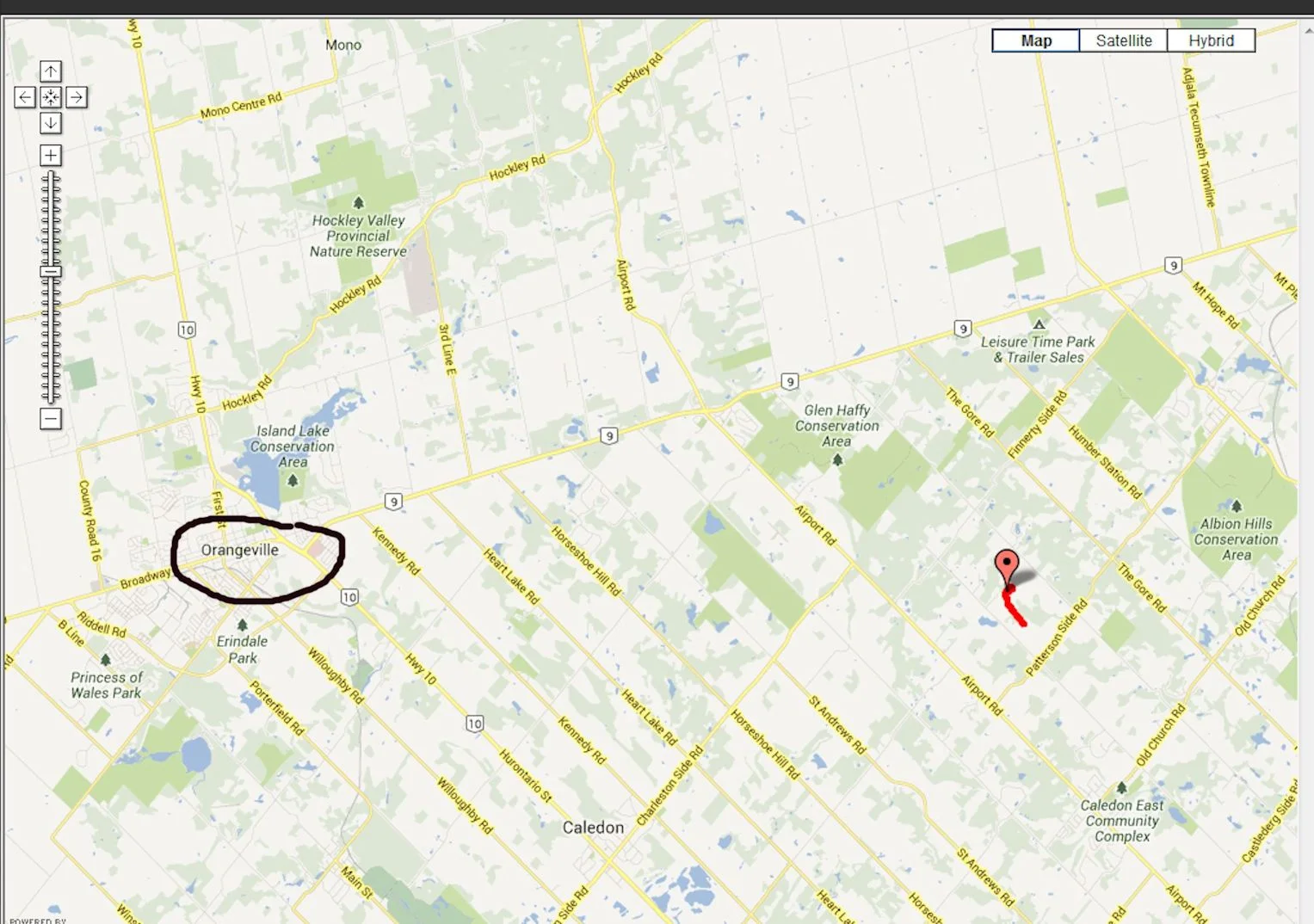

Thats disappointing. It was the most expensive in this style at the vendor. As far as the GPS, on the map inside the program I can see the hiway I'm supposed to be on but the plotter shows I'm off by maybe 500 or 1000 meters. This unit has a blue/grey menu. I've added a couple of screenshots showing typical errors. I may have to return this unit. The first pic is at least 30km out, the lower pic is start up point, it's at least 100km out.

What program are you using for playback and have you tried Registrator Viewer as an alternative? Registrator Viewer (I'd provide a link if I wasn't in the car on my phone, Google will find it) has some error correction built in which can often display these correctly, if not its a firmware addressable problem but you'll need to talk to your seller about that

It's a false positive, the functionality of the program pulling info from a 3rd party website, checking for updates from a Russian website etc will trigger your AV program, it's safe to use but you'd probably have to setup an exception rule in your AV program to use it, once you do that though you're good to go, of all the playback options you have it would be the best one by far
OK downloaded that and the codec pack ( loaded with junk ) and the GPS displays correctly, however, the video opens in a separate window. What's up with that ? Any help greatly appreciated. Also switched to a class 10 card. Will be testing today. Lastly, Video recorded last 2 days was incomplete with only 2 Video files, about 3 gig each (32gb card) In spite of being plugged in continuously. Recycle is turned off. Auto Off is off. Motion detect off.To keep camera recording all the time what do I have to do ?
