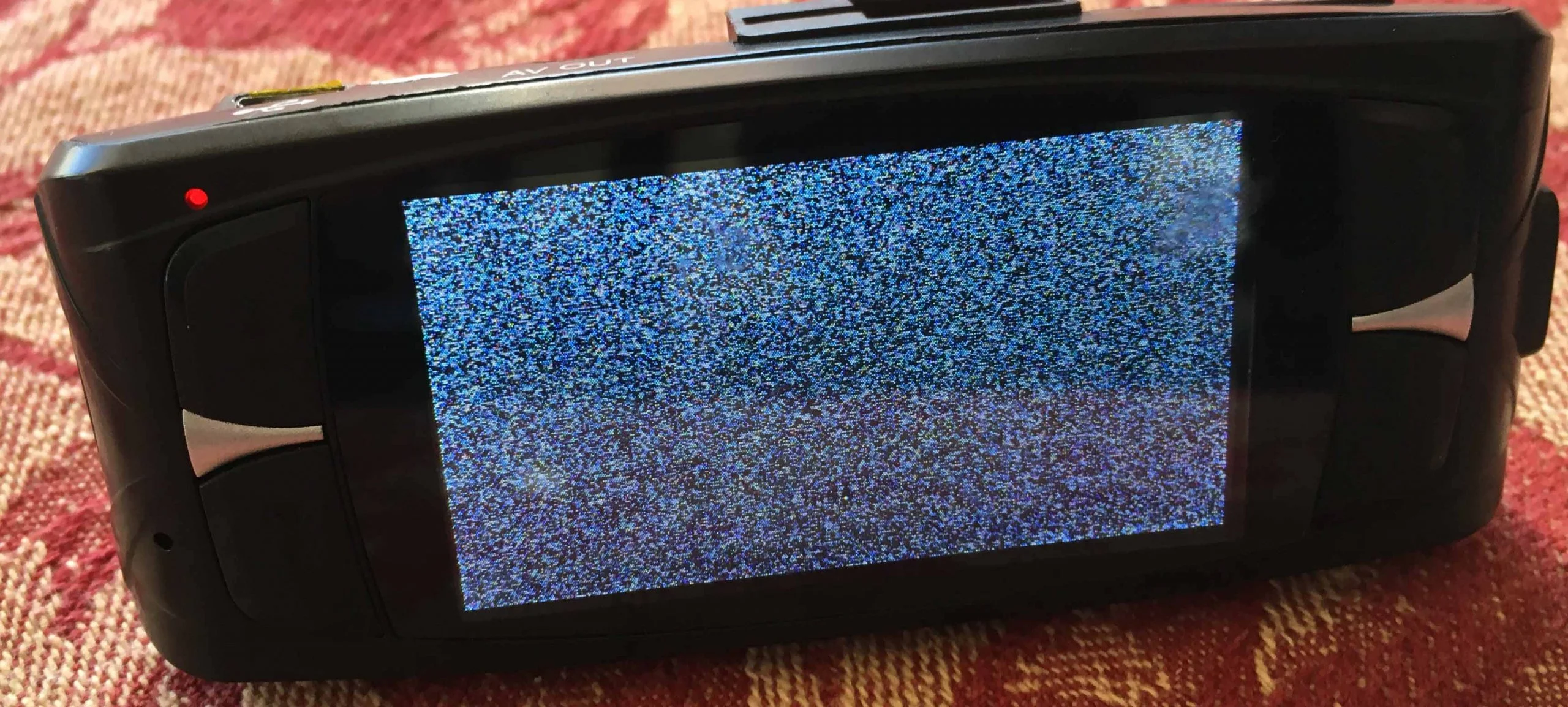

I tried to play it on the camera and was not there. The last clip on that day was around 10 seconds long. I also found a new issue, if I keep going forward I run into an issue where the screen goes static and I need to push the reset button. I have attached an image down below:

I had a G1Wc fail similarly- mine was a bad cam (hardware problem). The G1Wh is a bit different inside.
Have you tried the usual fixes? (reformat SD card, try another SD card, reset the cam, try another power supply or USB cable)
No I haven't. I may reformat the SD card and see if the issue reoccurs. I had this camera for a few years now.

I know my SD card is legit since I bought it locally and it does record the full 32GB. I am guessing what made stops is a fuse going out in my car or starting to go out. However, I would assume my XM radio would also stop since it is plugged in the same cigarette port.
The card could have bad sectors on it or have corrupt data behind the partition. Even the best cards wear out and can go bad for other reasons. Check it with h2testw even if you think it's good just to be positive about that. Otherwise you may wind up chasing your tail needlessly πŸ™ After this try a different power supply- most mini-USB phone chargers will deliver enough current for this. Also, how long does it run without power before shutting down? If it's only a few seconds when the settings say you should see more then the internal battery could be going bad.
I notice you say you've had the cam a few years. It's entirely possible it's simply on the way out- some component has gone out of spec now, a cold solder joint is finally letting go etc. Cams at this price point often give only a few years service before dying and even the best cams won't last forever. Just how it goes sometimes with anything electronic πŸ™„ I paid~$35 for my G1W-HC's and if they go 3 years I'll be happy; if they go 5 years I'll be amazed πŸ˜‰
