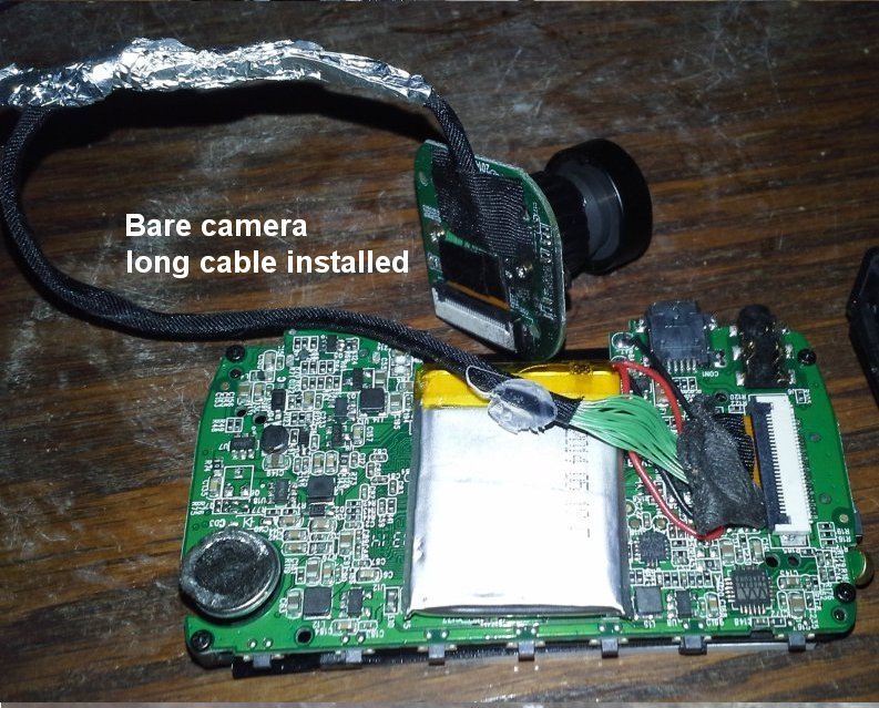

It seems that G90 is very friendly camera to modify.
I was thinking to make a rear camera but installation has always been a big problem.
Now problem is gone because G90 has external cmos lens base and it is very easy to add extension cable, and after that it's very easy to make rear or front camera. In front most achieved thing is cooler setup, maybe cmos unit don't overheat this way so much.
This was very simple, Dome G90 camera, cable from joovuu, basically just open camera, remove cable, attach cable, of course there is a risk of damaging camera so do this at your own risk.
Download high res images from here.
This was only a first step, next step is figure out how it's best to setup lens, i will update this post later.

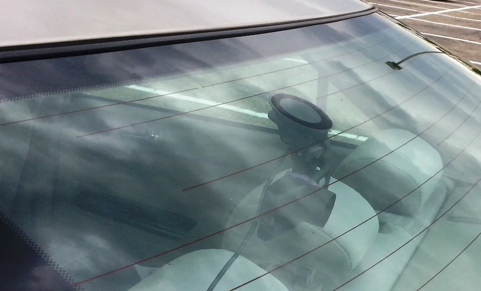

Some great DIY with a little bit of tweaking I could see a good A7 camera with a remote lens and a screen at a good price.
Yes, it'll be perfect for rear window.
I tried G1WH in rear window and look how big and noticeable it looks. 😱

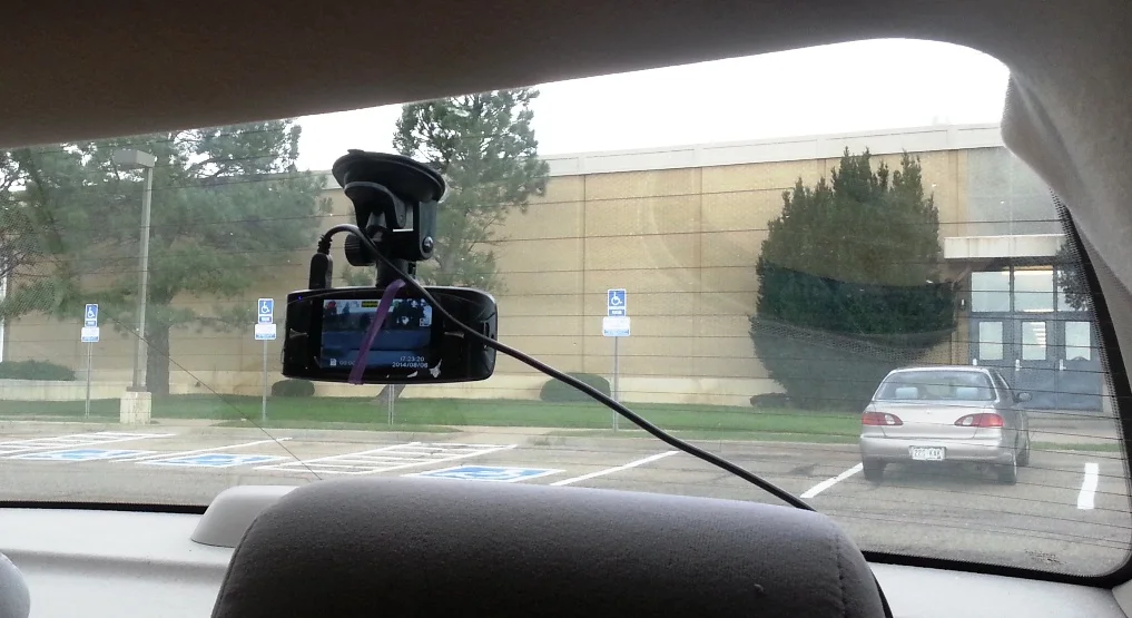

@Sunny ,
as I wait for my cams to get here, are you using aftermarket usb cables on your cams, specifically the back/rear cam above? monoprice cables? and if you are using aftermarket, are you @15 feet or more/less?
@Sunny ,
I'm using original.
It's long enough from the center console 12v port to the back.
I just have it in between the seats so if you want it nice and tidy around the trims, you'll need longer cable.

Here is some version of lense extension camera mod. I did it "on the fly" without bigger plan so there is always things that could have been better.
But since lifespan is usually quite short with these cameras i think i will let it be like that. If i do one more then i can correct things that i don't like in this one.
Polarizing filter is in my engineering department under planning.
Couple of images will tell the rest.
