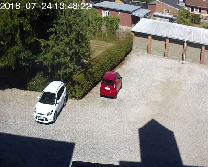

The one you look at are just 720p, i would not go below 1080, also the cameras are fixed lenses i think so you dont have the option to zoom in close on the car, and you need that to be able to identify anyone / anything near your car.
This is my car camera no zoom, as you can see no chance to identify anyone, unless it is your strange neighbor that always wear pink

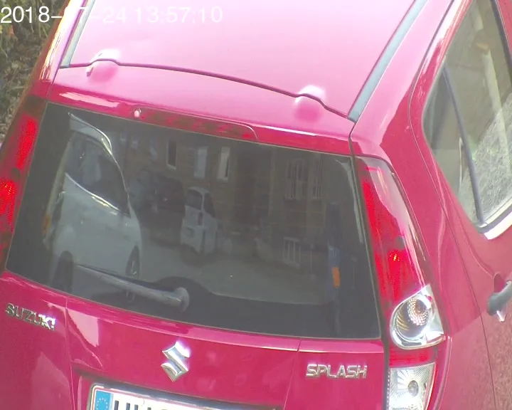

This are full zoom ( 20 X optical zoom )
Well this is good when you zoom, but i would really like a wireless one, since they are going to be 2 rooms apart, and i dont want to to some drills in the walls.
