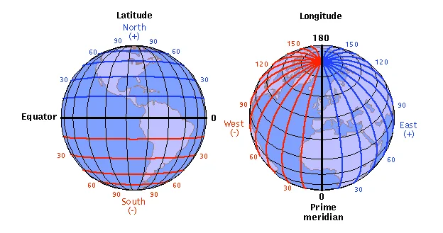

The GPS coordinates that you've listed are in Texas.
Latitude values North of the equator are expressed as positive numbers and South of the equator as negative numbers.
Longitude values West of the prime meridian are expressed as negative numbers and values East of the prime meridian are expressed in positive numbers.
  • N: 30.2027 W: 97.9852
    • That would be the same thing as 30.2027,-97.9852 which is located just to the west/southwest of Austin, TX.
    • The "N" for latitude makes the 30.2027 a positive number
    • The "W" for the longitude value makes it a negative number of -97.9852
      • If you leave the longitude value as a positive number (which is East of the prime meridian) that would be located in China.
Ahh, thank you very much. What I didn’t know is to put the “-“ before longitude.
