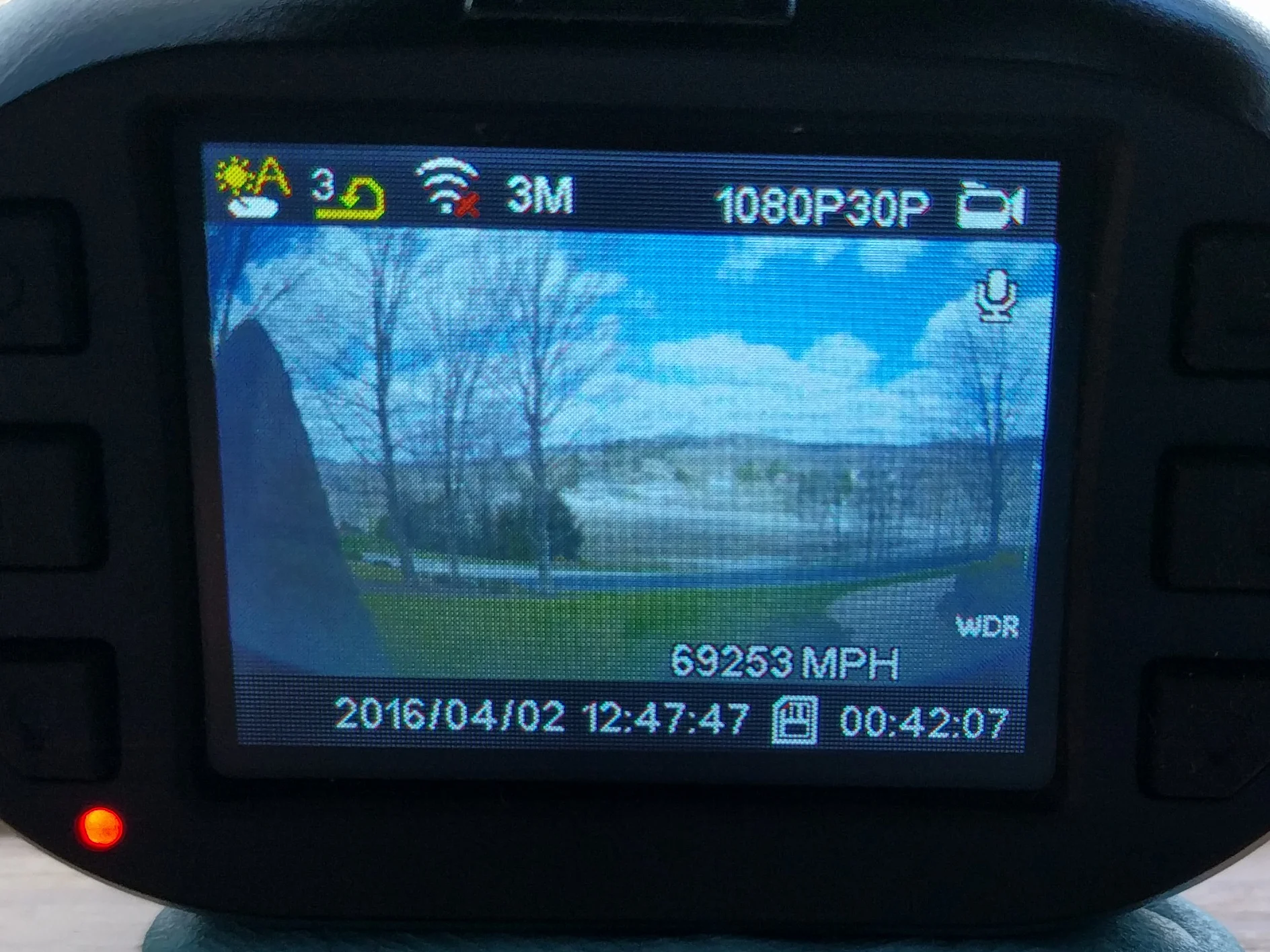

I can understand about no signal in the garage but it should be much quicker outside. Sometimes I would be driving 15 minutes without a lock. I know the connection from GPS module is good (I soldered it :)) and I can also see accelerometer data in the log.

Are you filming back the future or are you on the S.S. Enterprise?:) That will be big speeding ticket if the cops get you.
