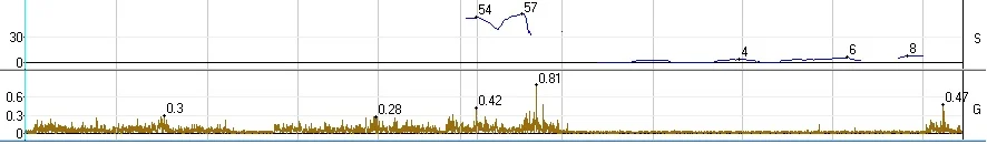

did an hour and half driving today and this is what I got from the GPS near the end of the drive. maybe it just needs more work to get itself working again?
its come back to life. fully working again.
