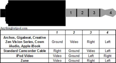

I did not get an AV out lead with my GS5000 and would like to either get one but have found differing wiring conventions used. I'm assuming it is something like a 4pole 3.5mm jack plug?
Bit is it Left Audio on tip, Right Audio on Ring 1, Video on Ring 2 and Ground on Sleeve?
Some leads which use a plastic bodied mating connector have the ground connection on ring 2 which would not be good news for the video output driver..
I don't really want to take my device apart to find out.
Until now on dashcams I saw the Ground to be on pin 1 as described in this picture:
The only important pin is the Ground, because you can use any RCA for Video.
