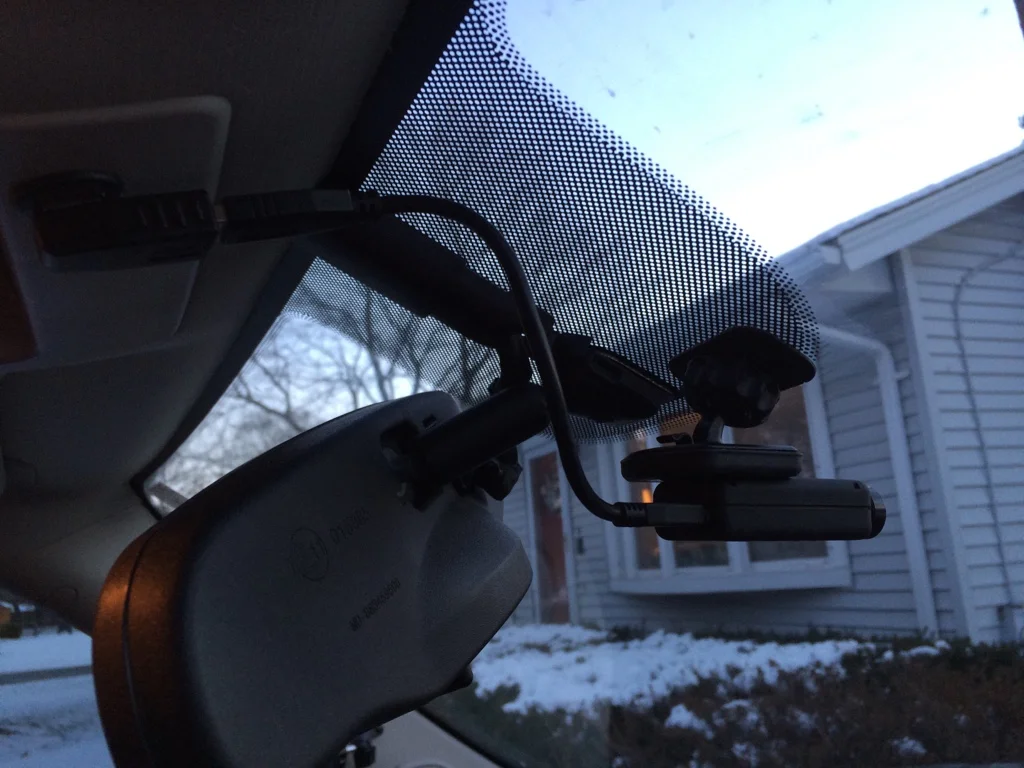

I'm working on a Mobius installation in my 2011 Silverado. I wanted to hardwire it and while thinking it through, I came up with this:
![ImageUploadedByTapatalk1452463722.575972.jpg ImageUploadedByTapatalk1452463722.575972.jpg](https://dashcamtalk.com/forum/data/attachments/19/19902-84a5fd847769d87ed0b04e3064411eee.jpg?hash=hKX9hHdp2H)
It's a hard wired USB charging port in the forward section of the overhead console (near the windshield).
It's an iSimple IS43. I wired it to the switched 12v in the harness up there. The IS43 knocks the 12v down to 5v.
I'm waiting for a 90 degree mini USB adapter and I also want to get a Scosche Magnetic Mount to finish it up. I'll post more once I have that stuff.
