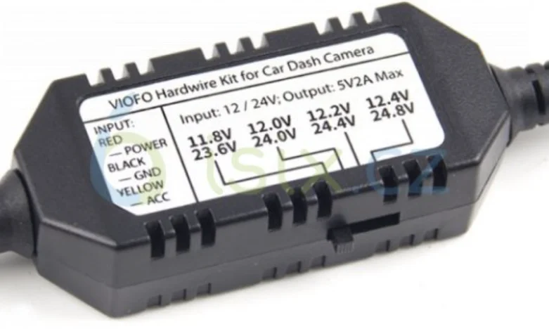

VIOFO connected via "HK3 WIRE ACC HARDWIRE KIT" means ALWAYS drawing from the car battery to the set voltage for switching off?
Yes, that is the purpose of this device.

Very bad for car battery in winter

That's why I asked about consumption. According to my measurements, I would estimate about 2W.
add
I found one comment about the consumption in parking mode and the correct value is about 4W.
Then the voltage drop is 8A/day
