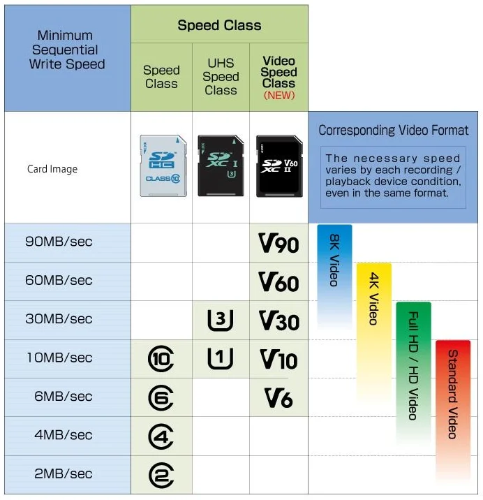

For Writing Speed, I just need a card with marks of UHS-I, U3 or V30 for Hikvision 2k/4k dashcams.
Class 10 is useless mark already.
So for 2k/4k dashcams, if you select Hikvision MicroSD cards, you have to start with 64GB/128GB to have UHS-I, U3 or V30.
I saw someone select a card with C10, U1 and "up to" 60MB/s for a 2K dashcam.
it will be not good for sure.

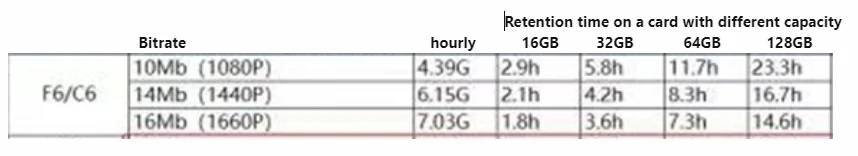

If I select a L2 64MB card for my F6S 1600P dashcam, assuming I drive my car 2 hours per day ( ignore the parking mode recording). A 64MB card stores 7.3 Hours video.
So 3.65 days is max recording days on this card.
with 500 time cycles, my card can work 500x3.65 days=3650 days, that is 5 years.
However, if my car is for commercial use and on the road for 16 hours per day, I can store only 0.45 days video on this 64GB card.
With 500 time cycles, my card can work 500x0.456 days=228 days or 0.62 year
If I use a 128GB card, it can store 14.6 hours video or 0.913 days of my car. With 500 time cycles, my card can work 500x0.913 days=456 days or 1.2 years
If I use a 256GB card, it can store 29.2 hours video or 1.825 days of my car. With 500 time cycles, my card can work 500x1.825 days=912.5 days or 2.5 years
If we use a better P1 or M1 card with 3000 P/E cycles, you will have 6 times longer life span now: 3.6 years (64GB), 7.2 years (128GB), 15 years ( 256GB)

@Nigel How long can a 128GB card store recordings of your dashcam?
That depends on video bitrate of your dashcam at your selected resolution and frame rate as well as the capacity of your card.
This information should be given by the manufacturer.
For Hikvision F6S dashcam, if you do recording at 1600P 30fps, you can have following retention time on your different cards:
So 14.6 hours storage is only for F6S on 128GB cards recording at 1600P/30fps.
Our new 4K+1080P dashcam will come with 24+6Mb/s=30Mb/s bitrate, so it will get almost 8hours retention time on a 128GB card
Of course , When we do calculation we need to convert MB =Mb/8.

I don't believe the Viofo A129 Pro 4K has 80Mb/s bitrate, because if that is true, you will have to use V90 cards for their storage.
V90 means 90 M Bytes per second, not M bits per second, so actually it is very happy with a V30, or even a good quality class 10.
Yes, I made mistake here. 80Mb/s needs 10MB/s speed cards.
But it is just average speed. You will need buffer for the peak.
For 4K + 1080P dashcams , still recommend at least V30 cards,

Dashcams record continuously, there should be no peak.
Yes, you need some buffering, and for dashcam use you need enough to be able to erase a load of files/cells and start some new files while still recording, without exceeding the buffers, which can be a problem with some cards, for example if they have a very slow erase function.
For 4K you need a card that exceeds the class 10 specification, but it doesn't need to be as fast as a V30 since dashcams do not have bitrates as high as GoPro or other high quality 4K 60 fps cameras, and also the recording is continuous, you don't get periods of very high data such as a GoPro running at 4K at 120fps.
The main problem for dashcams is that they never stop writing, so the card never gets a chance to do its erasing or wear leveling.
