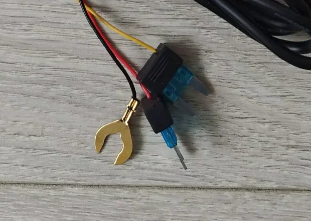

I've got a hardwired DDPAI Z40 but it's using an old mini usb one with a series of adapters so I want to update it and maybe get parking mode too. This seems to be the most common type (not necessarily DDPAI branded), but I can't understand how the fuse taps work, they look to be hard wired and as far as I can tell there's only one so would it also be shared with whatever fuse you tap off? Am I better off getting a 3rd party/different one that uses bullet connectors. Thanks
When you say hardwired, do you mean hardwired into that little black box or hardwired as in the fuse taps are integrated? It's effectively the same setup as using bullet connectors, although personally I like to use my own fuse taps (add-a-circuits).
The red and yellow wires will be individually assigned. One goes to an ACC+ fuse slot (only receives power when the ignition is on) and the other will need a BAT+ fuse slot that receives constant power, whether the ignition is on or off. The instructions will say which colour goes to what. Usually the ACC one is just a signal wire so it knows when the car is on or off and the power always comes from the BAT+. Connect the ground to a suitable bolt and then plug the USB-C cable into your camera and you should be good to go.
However, if the black box is just a voltage convertor and not a battery protect and your camera doesn't have anything built in to limit voltage drain or parking mode duration, then I would highly recommend getting a battery protect device instead.

Thanks, I'm specifically referring to the fuse connections in those kits, none of them show the back so I can't see if they do in fact have two fuses like a fuse tap with bullet connectors would, or if it's wired directly into a single fuse. I'll make sure to get one with a battery cut off. They look to be a single fuse so that means it's not individually/dual fused like a tap with bullet connectors?
Ah ok, I see what you mean now. Yeah, they don't look like they can take two fuses. There might be some sort of protection inside of the casing, but personally I would be using independent add-a-circuits with separate slots for the dashcam fuse and the car's fuse so that there's no risk of losing the car's function that the fuse slot relates to.
