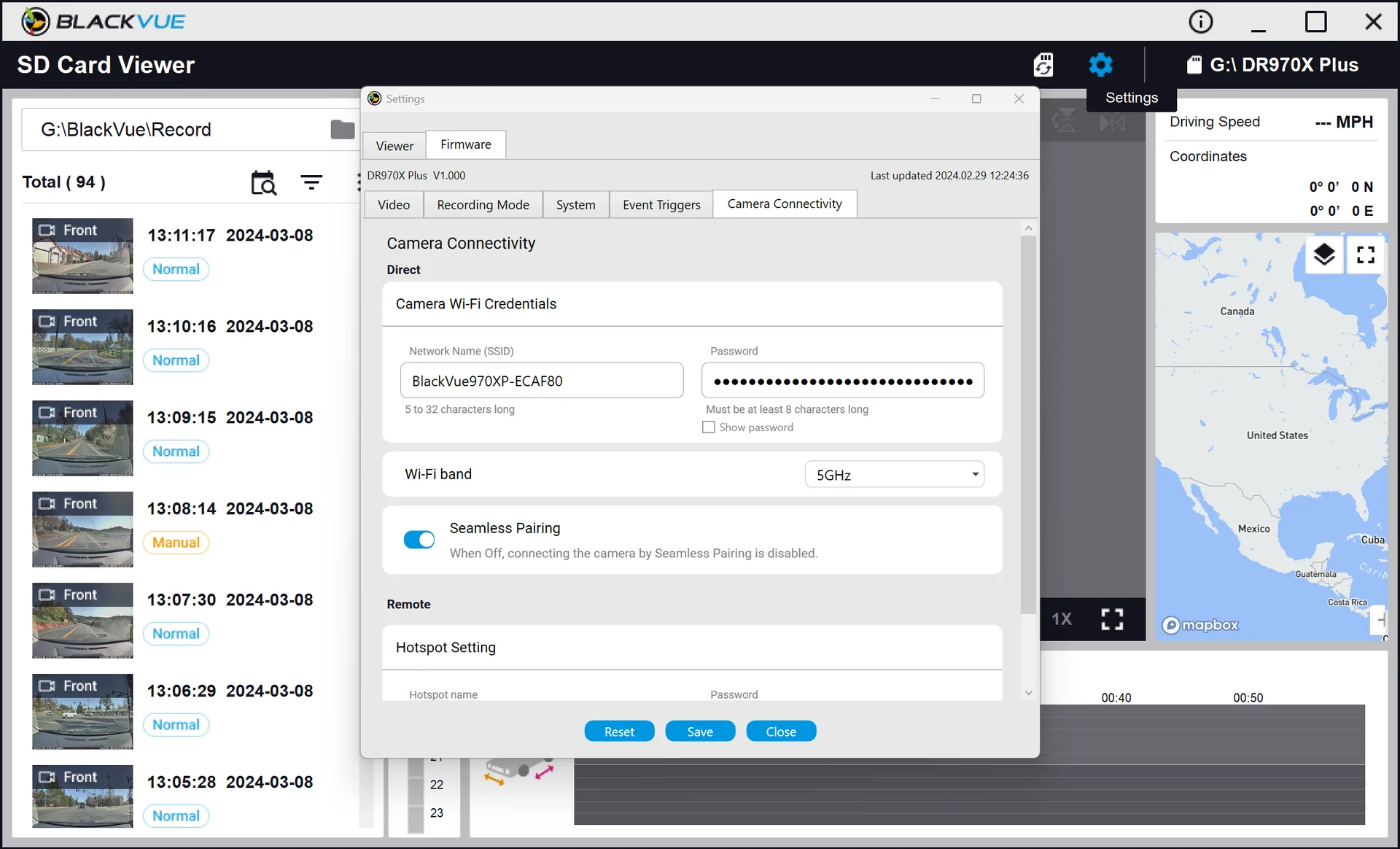

You might try using the BlackVue [SD Card] Viewer program for Windows / Mac. You can mount the memory card on your computer and use the BlackVue Viewer to update/change settings on the SD card. When you reinsert the memory card into the dash camera, it should pickup the setting changes from the files on the memory card.
Here's the link to the BlackVue Viewer program: https://media.blackvue.com/blackvue-viewer-windows-mac/
